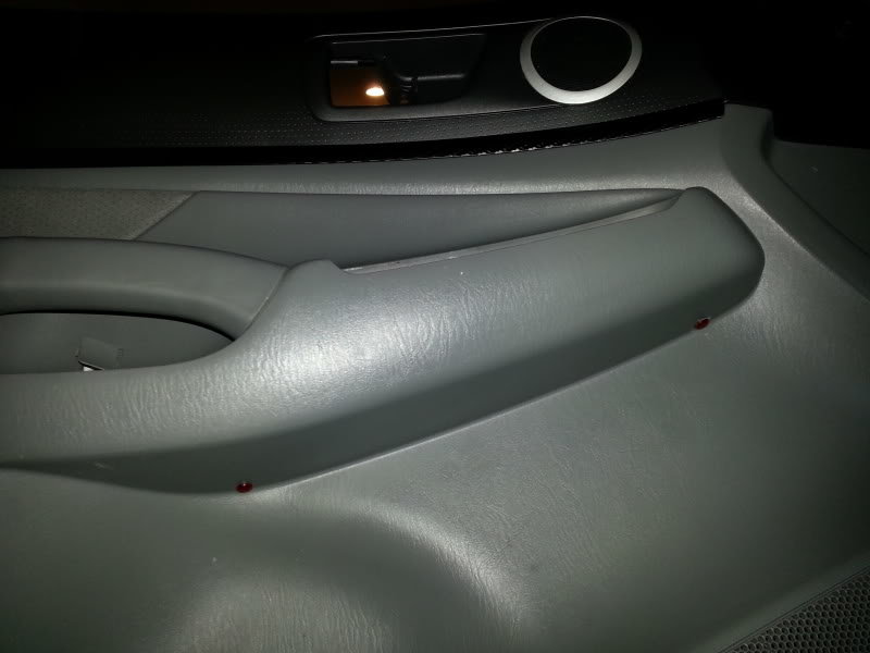

    I had installed mini LEDs in my speaker grills and door latches. Connected to the hot wire on the power window switch and grounded to door. Once I turn on the ignition switch, the power is on and the lights are on constantly until I shut off my truck. Got my mini LEDs from OZNIUM.COM. They come in several colors and are pre-wired with resistors.

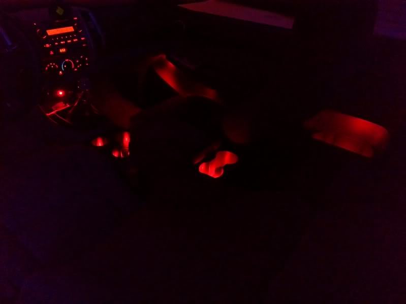

    I put LED's (from radioshack) in the cupholders, above the door pockets and above the shifter console pocket.

    very nice!
    how are yours wired ?
    have a detail on how you did the cup holder lights?
    I think im going to wire my door lights to the dome light so they come on when I open the door and when I approach the truck and hit the unlock button.
    right now I have foot well lights wired to my dimmer 12 acc wire so they are pretty much on when ever the truck is on .

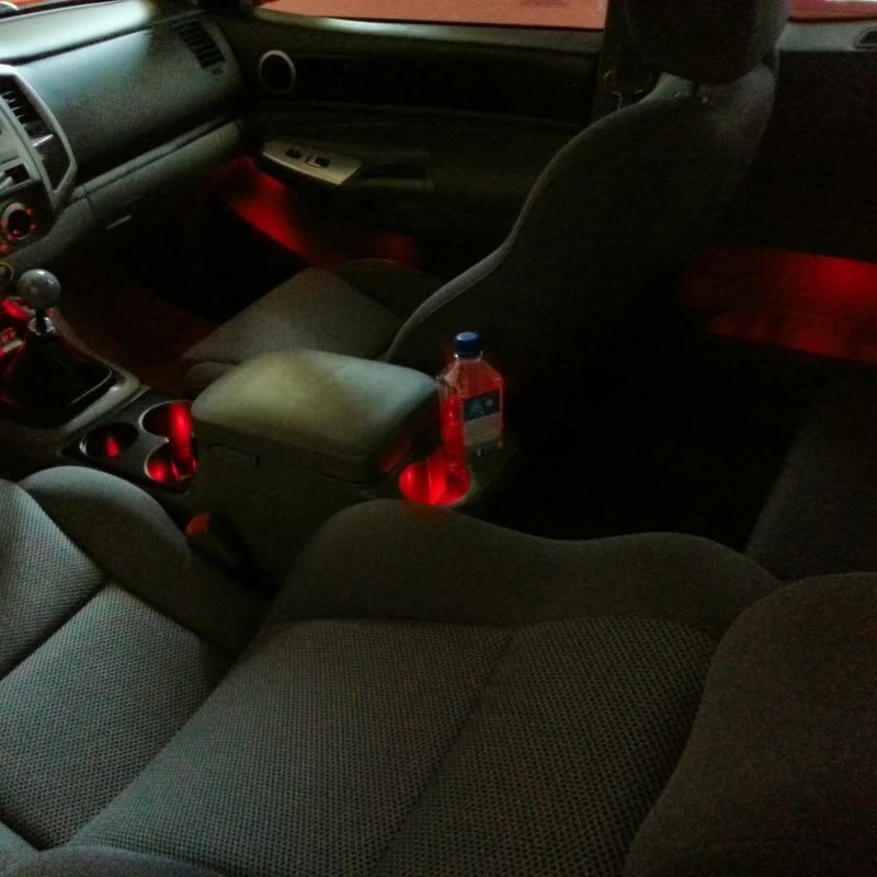

    Copy paste'd from my crappy write up thread on another forum (It didn't come to me to do a write up til I was partially done)
    The rear doors are drilled at the bottom facing up (access cab only, i'd imagine the rear doors being the same as the front doors on a double cab but you would have to get a wire through the rubber boot and into the side pillar, down and under the plastic floor thingies (they are just clipped on)

    That's awesome ! That's exactly what I'm trying to do ! Is there any way of pulling the dome power from the fuse box vs running all the way up to the dome light ?

    I never got it to work right from fuse box area. I think maybe the computer does some common ground or signals or who knows. One attempt got it to work opposite of dome (if led on then dome was off). I gave up trying to figure it out.
    Switch method I did was easy. Just make sure to cover wire and solder anyplace it might possibly hit metal if you were to push on headliner.
