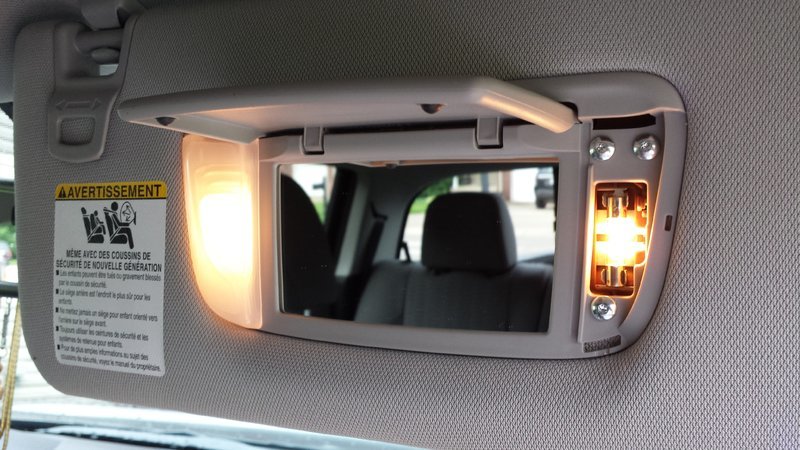

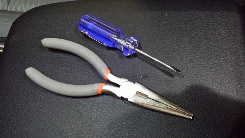

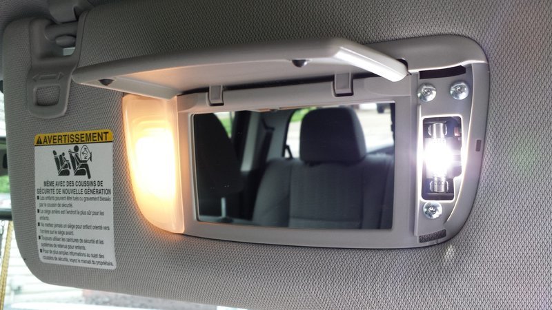

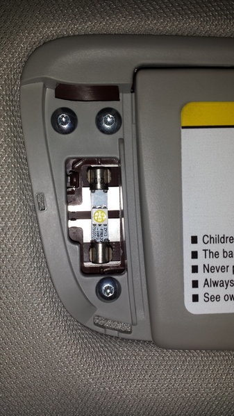

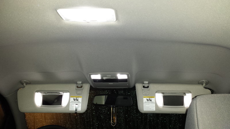

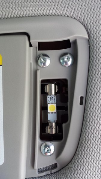

    I just bought my very first vehicle ever and it happens to be a truck and it happens to be a Tacoma(SR5 double cab 4x2). So i've been roaming the threads for recommended/popular upgrades and stumbled across this thread. I was skeptical about buying the LEDs since they were not on Amazon(amazon is life!), but I ended up doing it because I wasn't sure if I found the right bulb for the back middle(I'm calling it Dome light) on amazon. I didn't see any instructions or pictures for where to pry open the light covers but managed to figure it out. I took pictures in the process for future reference for others that may not know how to do this.
    I did buy the exact same parts as listed by the OP. Here are the pics:
    The only tools i needed(i used a pick, but that ended up being too sharp)

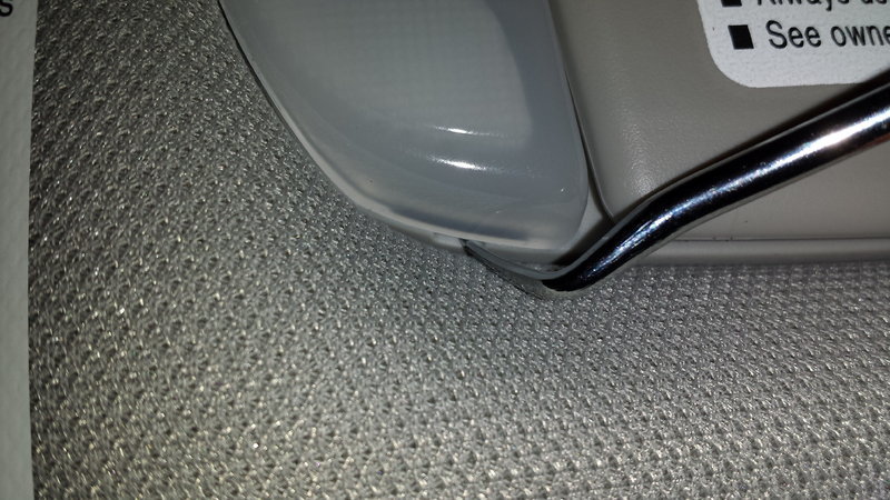

    Vanity light cover tab (pry it upward with a flat head screw driver, the PICK WAS TOO SHARP!!)

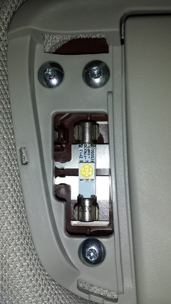

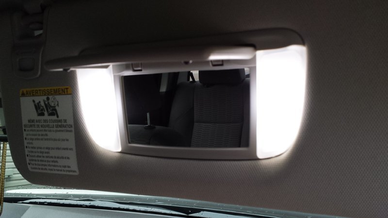

    Passenger side, before and after
    Passenger_vanity_mirror_lights_stock.jpg Passenger_vanity_mirror_lights_stock_vs_LED.jpg

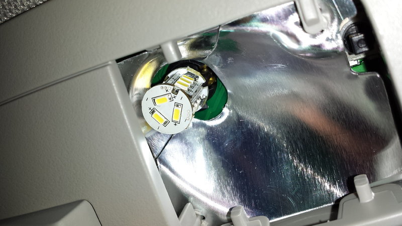

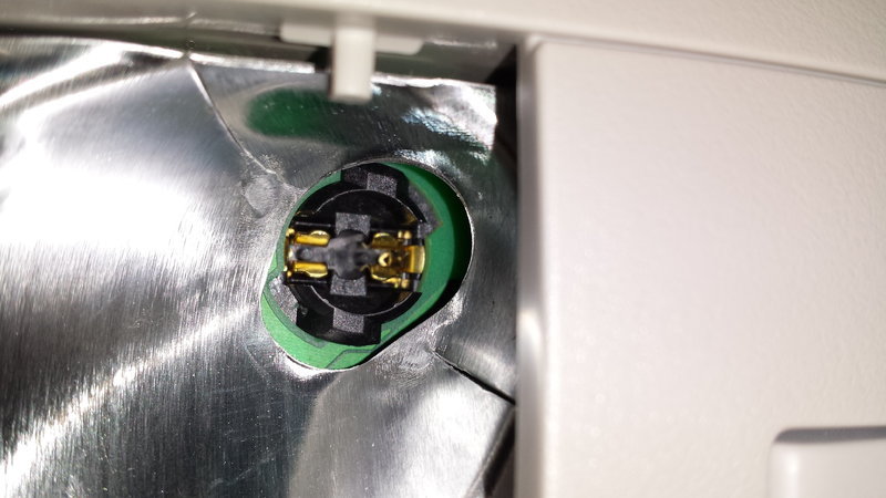

    Note that the '12VDC' text on the metal contact has to be on the BOTTOM for the bulb to work, PASSENGER SIDE ONLY
    Passenger_vanity_mirror_light_LED_bulb.jpg Passenger_vanity_mirror_light_LED_bulb1.jpg
    Driver side bulbs need to have '12VDC' text at the top. OPPOSITE DIRECTION FROM PASSENGER SIDE

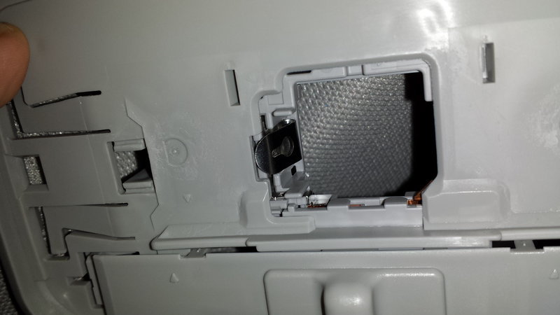

    Map light LED:
    To remove Map light cover, stick the flat head between the plastic and the dark flat spot on the cover
    I actually ended up bending the contacts in towards each other to create a more snug fit for the map light LED. Felt loose without bending the contacts

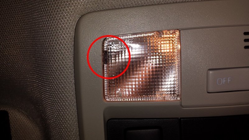

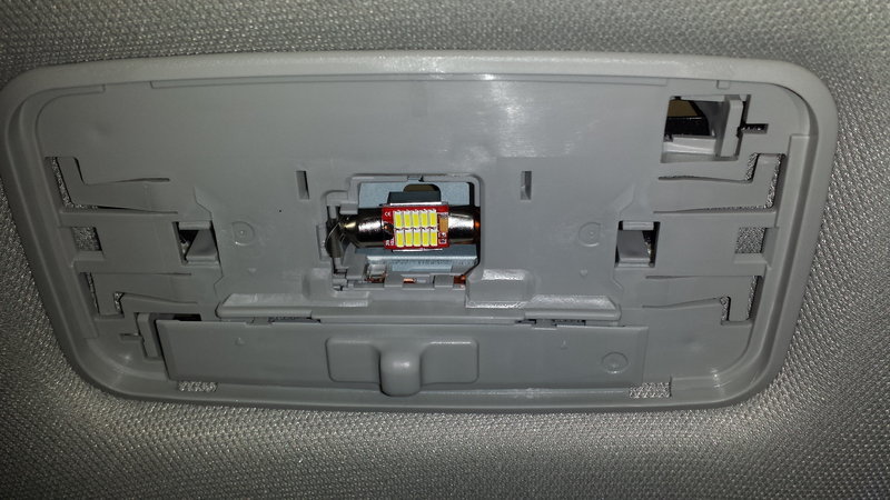

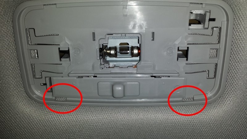

    To remove the middle center light(DOME ligth) cover, locate two flat tabs. Stick the flat head between the plastic and the cover in these spots
    Had to bend the tab in order to fit the new bulb

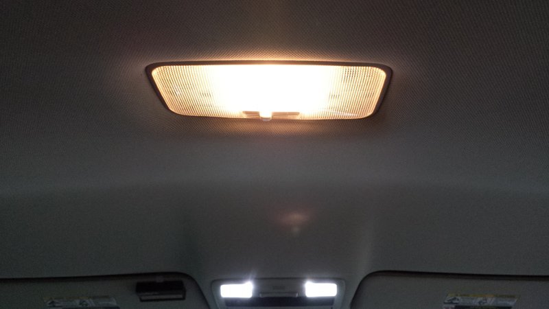

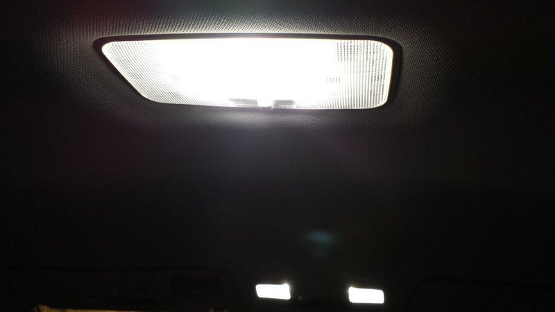

    Before and after
    FINAL RESULT(it was a monsoon outside while i was working :D)
