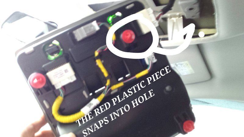

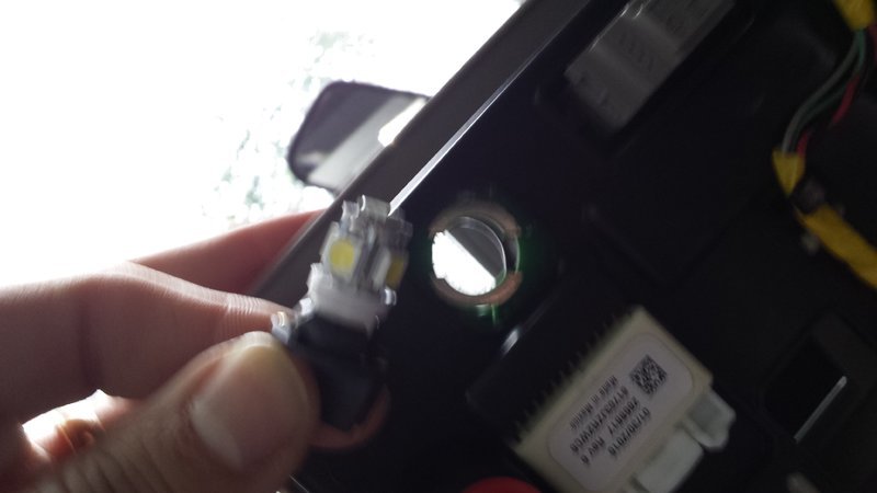

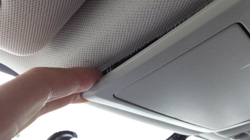

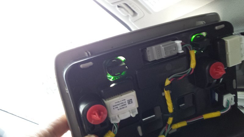

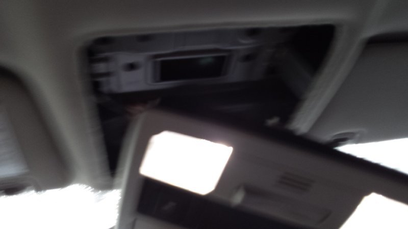

    TIP INSTALLING LED MAP LIGHTS ...
    anyone installing LED map lights, the easiest way to replace the 2 bulbs is to remove the overhead console. It just snaps in place .. start at front drivers corner and pull straight down then work your way around all 4 corners till it drops down then you have easy access to bulbs .. i changed my map lights in less than 3-4 minutes using this method

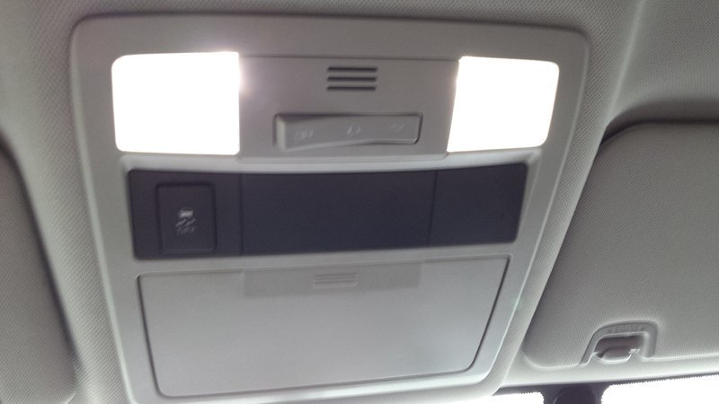

    I installed the dome light, vanity mirrors and overhead map lights with bulbs from superbrightleds.com and it came out amazing! I got cool white and could not be happier. My dad liked them so much we ordered him some for his 2014 Tundra.
    Dome and vanity mirrors were easy but the map one was hard for me. I used a tape trick to pull out the bulbs since fingers don't fit in that compartment.
    Overall i'm so stoked with my lights.
    Ps. I just ordered the back up reverse lights for it also so the camera will be brighter at night.

    Wrapped duct tape around the bulbs and pulled em out. Took about 30 seconds each at most.

    What's holding the cover in place? I've tried pulling from the corner and moving along to the next but it never pops loose. My cover is a little different. It has the crawl control knob and moon roof controls.

    See those round red plastic pieces, there are 4 total and those snap in to holes up inside opening as i've shown in this picture .. mine is the 16' SR5 so no moon roof or crawl control knob

    Got it. Thanks!

    So much easier to slip a blade up along the lens cover and it pops out. Wrap a loop of painters tape around the bulb and its out.
