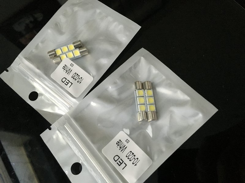

    Got my vanity LED Lights in today....3 diodes in each one. Should be a bit bright.
    SilverII likes this.
