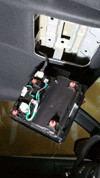

    If this hasn't been posted yet the 2016/17 MT map light center console is held in place by four red plastic fasteners. The bulbs can be removed from behind.IMG_20170305_081655-1195x2124.jpg
