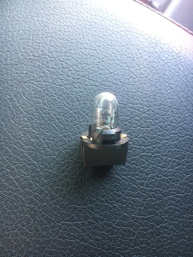

    Can someone please tell me why I am unable to remove the factory map light bulb? Seems like every video I've watched they just slid the bulb out and popped a new LED one in without even removing the console. I tried everything from needle nose pliers to tape. Took down the overhead console and this is what was removed. Still can't take the bulb out. What am I doing wrong? Thanks!

    I used blue painters tape, and just wiggled back and forth. They are tight.

    I used duct tape, and just wiggled back and forth. They are tight.

    A 5" piece of fuel line is what I've always used.

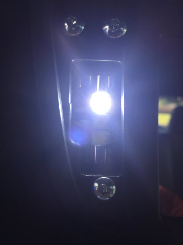

    These are bright and fit well. Have lasted a few months so far.
    Dome light --
    Partsam 6PCS White 28mm Festoon 12SMD Interior Dome Map LED Light Bulb Glove Box Lamp for 2010 2011 Mazda 3
    https://www.amazon.com/dp/B00LL37F12
    Map light --
    194 LED Light bulb, Yorkim® 6th Generation, Non-Polarity,12V Lights for 168, 2825,T10 5-SMD LED Bulb (Pack of 10)
    https://www.amazon.com/dp/B00MAG6RMM
