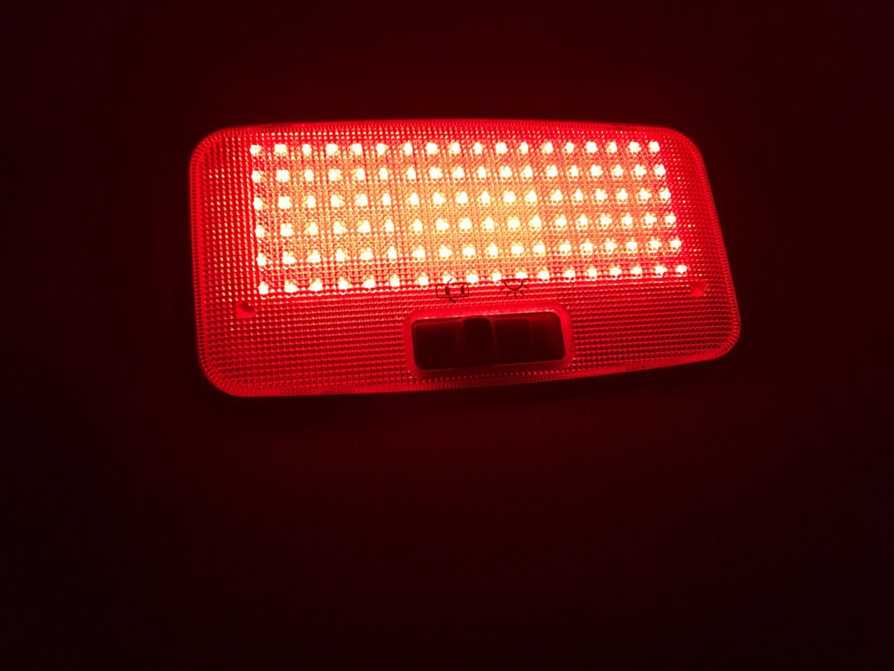

    Camera adjusted for the light output. This thing is bright!057419A8-1602-4B92-9EDD-B89AD8D09F15.jpg
    Left is new SMD LEDs, right is stock bulb.
    I installed SMD 5050 LEDs pcb boards. They are cheap boards from eBay. I had to combine two small boards to fit in the map lights. The dome needed three larger boards. Pictures do not show just how much light is put out but they are much brighter then stock and I love the red color.

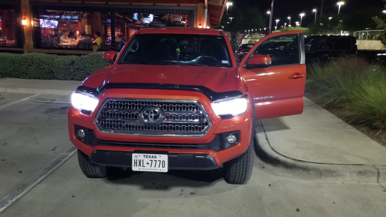

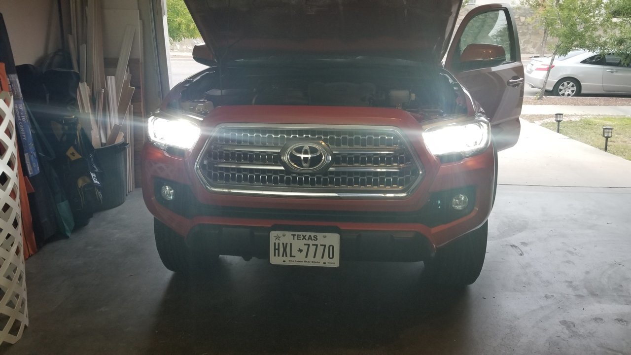

    20181011_181020.jpg 20181011_212541.jpg I'm not sure if anyone is following this anymore but I did my interior based on this thread's recommendations. I also did my exterior lights using Auxbeam H11 LED headlights . They gave worked great!
