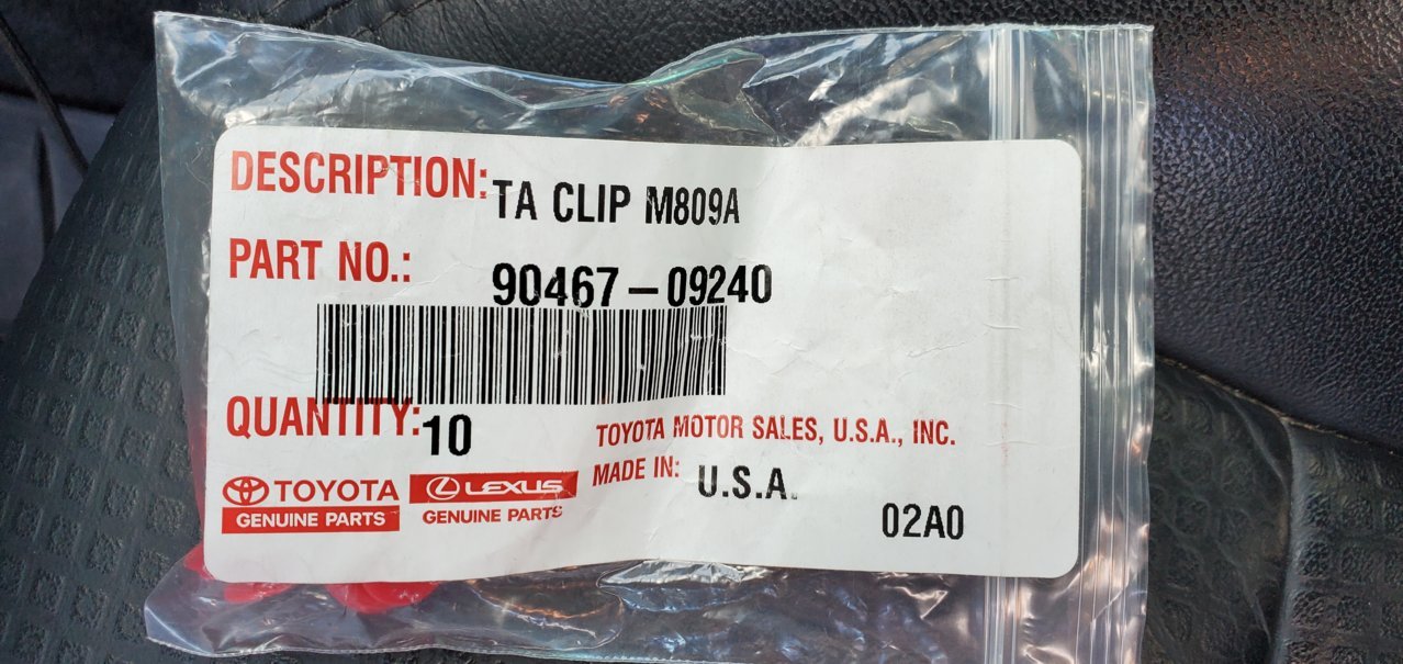

    If you pull down the roof console you can easily change the map bulbs but beware the red clips may break that hold the console. These are also the same clips on the back of the storage bins behind the rear seats. I feel that their average life span is 1 to 2 uses before the are useless. Price is around $3 cdn each from Toyota.
