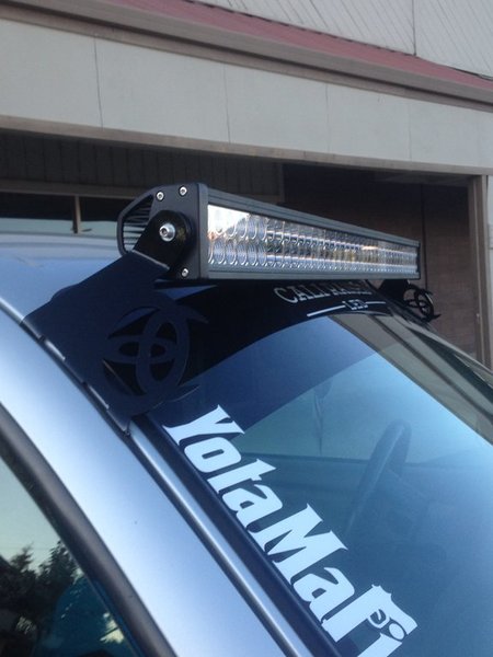

    Mine is a perfect fit with @eazycompany mounts. No leaks and the wiring is right down the A pillar into the inside of the fender well.

    If you mount vertically leaks shouldnt be an issue. Any water should drain out the gutter before it gets high enough to come in the screw holes.

    I have mine mounted down a little ways on the A pillar. I used rivets.
