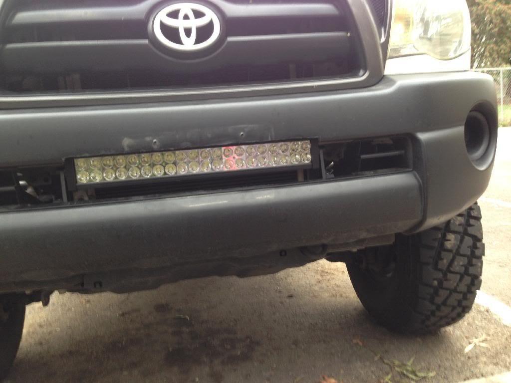

    I've read posts of people not adding relays or fuses or switches. But if it all comes in one kit just add them it makes your truck ,light bar, battery, and wires that much Safer. Also makes it easier when I install another. I bought one off eBay for 80 bucks shipped and honestly I can see one damn difference as long as a I get a year out of it I'm happy. I've hear people bash eBay one but what they don't know is all the led bars Are basically made in the exact same place. It's falls down to which company buys them puts a bar together and puts a good name with marketing behind it bam 400 light that's only 10" long. I got 2 foot for 80 the throw is awesome the width the beyond great I would put pics but you can't really get a good grasp unless you see it in person
    I did a little bit of custom work ha
    I will end up selling this one to get a full size for my lower grill

    Yeah I was going to do that but the Toyota logo doesn't allow you to adjust your light. I just trimmed a lot of plastic and mounted on my stock bull bar thing haha behind my bumper. And I'm not trying to makes things hard, when you buy an eBay light most 100 bucks they don't come with info or harnesses. So that's why i posted this. When you buy a good light 400 it's come with harnesses but you just paid an extra 300 for a name and harness. Also looks like yours is a single row. Mine is double no way was it fitting they way I wanted ha
    This is my wife's truck I did for her
