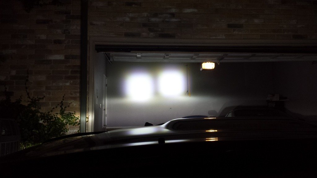

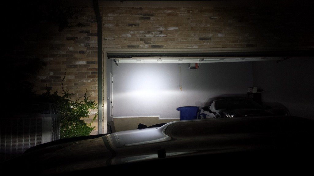

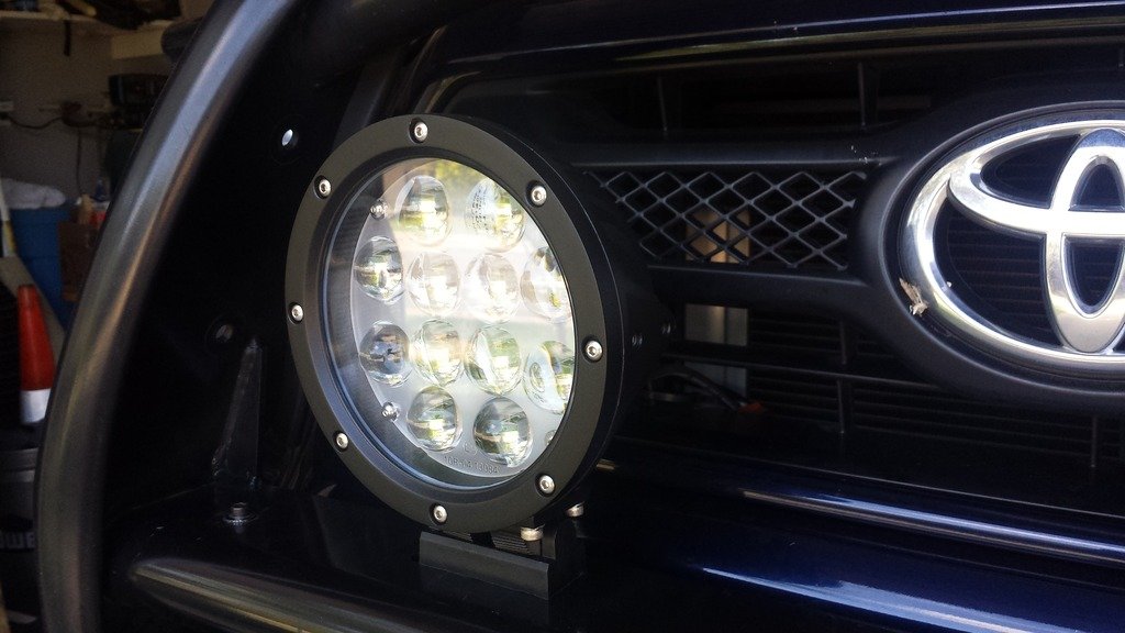

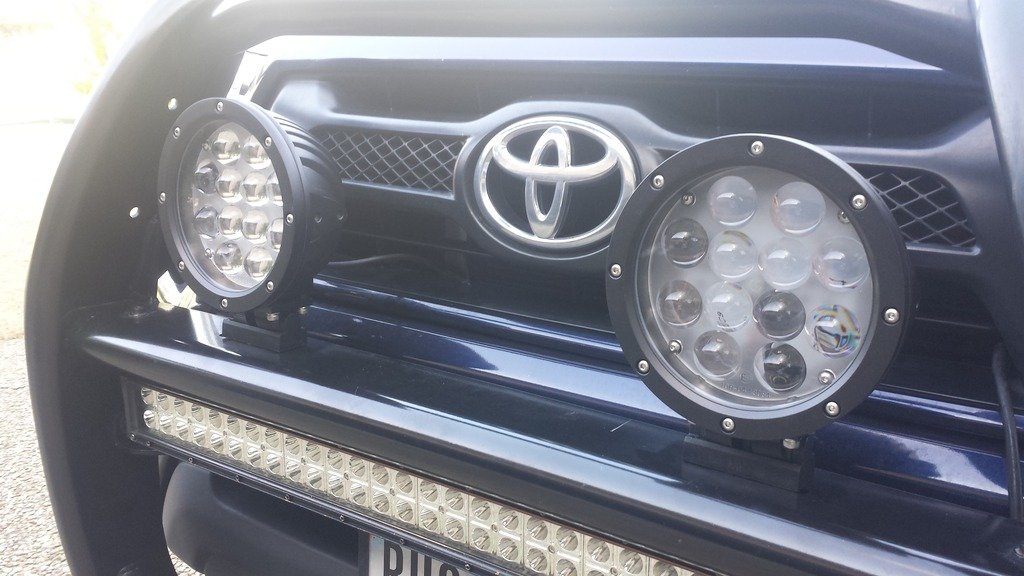

    So I just picked up these 120W 7" Round Spot lights (10Wx12). You mostly see this design with only 60W (5Wx12)....but I happen to come across these for $134/pair with 10,200 lumens each..so why not. These were to replace my horrible Hella 700FF HID conversions. They might have been a decent idea 5 years ago...but the beam pattern was always horrible and the cheapo DDM ballast took a full minute to warm up. I was never happy with them.
    Any who these lights are bad ass. Just what I was looking for. I need something with a thinner profile than the Cannons to fit my grill guard. I have a 300W double row 32" Cree Spot light bar...which produces more of a Euro-beam in my opinion. So I was looking for a concentrated long range spot for long distance. The construction seems top notch and they are very heavy. The only negative comment I can say is the adjustment up and down doesn't have much fine tuning. It has this plastic gear/cog wheel. I wasn't able to set the vertical where I wanted, so I ended up putting some shims in the front to get them to aim up just were I wanted.
    http://www.ebay.com.au/itm/Pair-7In...ad-4WD-Lamp-/400743474724?hash=item5d4e2c2624
    Headlights and 32" LED Bar
    32" LED light bar and the new 120W x2 LED Spot light . Yes they completely over power the 300W 32" LED Bar.
    Headlights and the new 120W x2 LED Spot light . This after I optimized the aiming at a long distance. Bottom of the spot on top of the headlight beam and at a distance the gap in between completely closed and the spread is perfect at a distance. I will try to get some long range photos this weekend.
    I would love to see a side by side comparison with the Cannons everyone has
