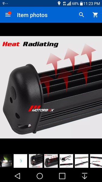

    Just a side note on these bars though.. Most of the older versions only come with bottom leg mounts and not end cap mounts. Some of the newer versions do have the inserts for the end cap mounts though. But the one listed above looks like the older version like mine. You can see in this pic that it just has a rubber cap covering a blank hole.
    So with these If end cap mounting is necessary, you have two options depending on the internals for the bottom mounting rod that is inside the bar. You can either remove the internal rod completely to install bolts. Or you can use 1/4" threaded rod inserted through the bar and cut off the extra, and use nuts on the end... If that makes any sense. I've got more pics of the rod if anyone needs to see what I'm talking about..
    Some of the newer versions have the notched threaded inserts along with end cap leg mounts to use that or the bottom mounts as options. And even newer ones have even different end caps that have two holes each side with leg mounts provided, as well as the bottom leg mounts that have a small insert that slides in to the underside of the bar. Hard to explain without seeing it. But just wanted to throw that out there. Because you may find it hard to figure out how to mount if the end cap mounting is necessary. Otherwise all have the bottom mounts if that will work for you. Which on the 2nd gens it should if you are putting a support beam across the crash bars and mounting it on that.

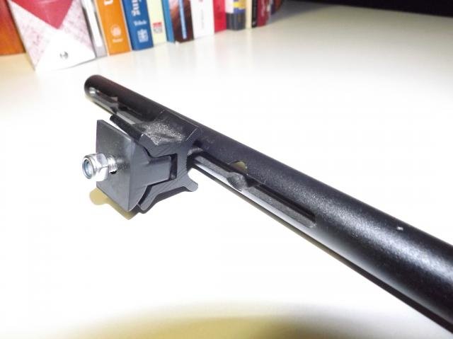

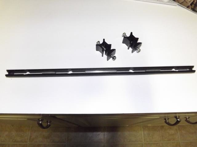

    Found my pics. Here's that rod I was talking about. I had to party disassemble my 20" just to get this rod out to put bolts in the end caps. My 42" I didn't even bother as I really didn't want to take that one all apart. So on the roof bar I have a loooooooong ass threaded rod fished through the bar, which goes through that rod, cut the ends off, and put nylocks on the end. Ha.
    My newer xpr clone, as well as some of the evo prime clones, actually use tiny sections of this rod with the bottom mounts. And is inserted into the underside of the bar via a cutout. You slip in each mount and slide it to the desired spot. Then it clamps in place as you tighten it down. Each mount will have a notched slide that can be pivoted for angle. But these ones should also have the end cap inserts from what I've seen. I'll try and get a pic so you guys know what to expect when getting these. Just trying to help because again, they can be tricky depending on which style you receive.
