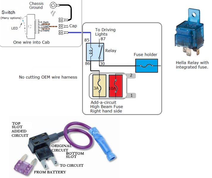

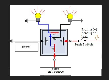

    As for how to wire the LEDs for when they only work when the lights are on, here's one way.
    Get a 30A fog light relay ($5-$7?). Connect your lights to it as shown below (substitute the LED bar for the yellow fog lamps) using
    (+) for the relay only from a headlight lead. Your choice. Do you want the accessory lights on with the low or high beams?
    That juice will only be used to fire the tiny coil inside the relay, so it won't be a burden on the headlight circuit itself.
    The main power to the LED lights is coming from the battery (with an appropriate fuse in line).
    The lighted switch is grounded via a separate ground wire from the LED ground and will illuminate when the LEDs are on and be dark otherwise.
    I have a set of KC Flex LEDs on my Yamaha wired using a high beam connection this way and they are great.
    With the high beams on, I can flip the added switch and get the LEDs going. If a car approaches, I can dip the headlights normally
    and kill the LEDs at the same time without having to reach up for the KC light switch itself.
    Hope this helps!

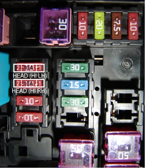

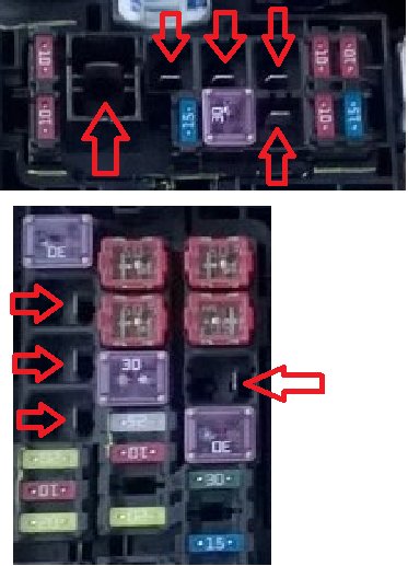

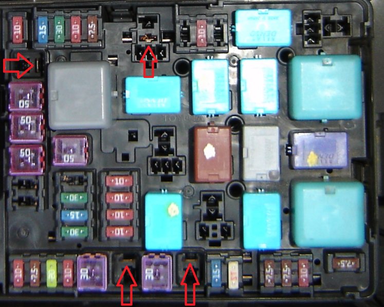

    Is the free lead from the blue fuse holder in the diagram connected to the battery directly or another 12V source in the fuse panel?

    There are a few male tabs free in the engine room fuse box which can be used...
