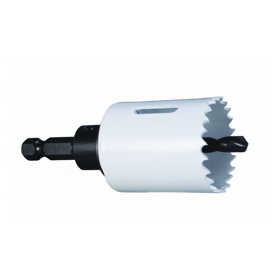

    4. Drill the holes.
    --The aluminum bumper supports are hollow so two holes need to be drilled on each support (top and bottom). The top hole should be drilled large enough for the lightbar bolt. The bottom hole should be drilled large enough to fit a socket through. I used a 1/2" hole drill bit.

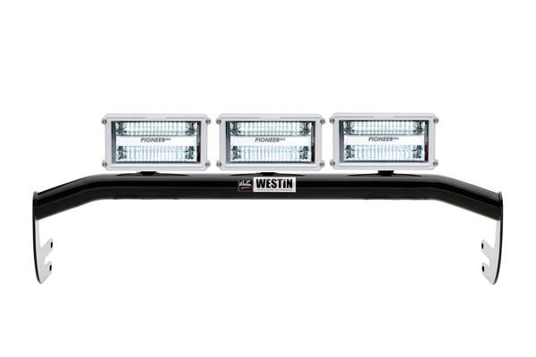

    Have a Westin on order and going to go with either 3 Whelen Pioneer Plus Floods at 7K Lumens each or 2 duals at 14K Lumens each.

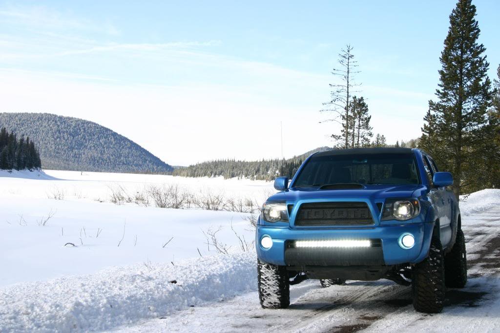

    Took me forever to get some shots together... But here is a couple of my light bar on. No night shots yet...
