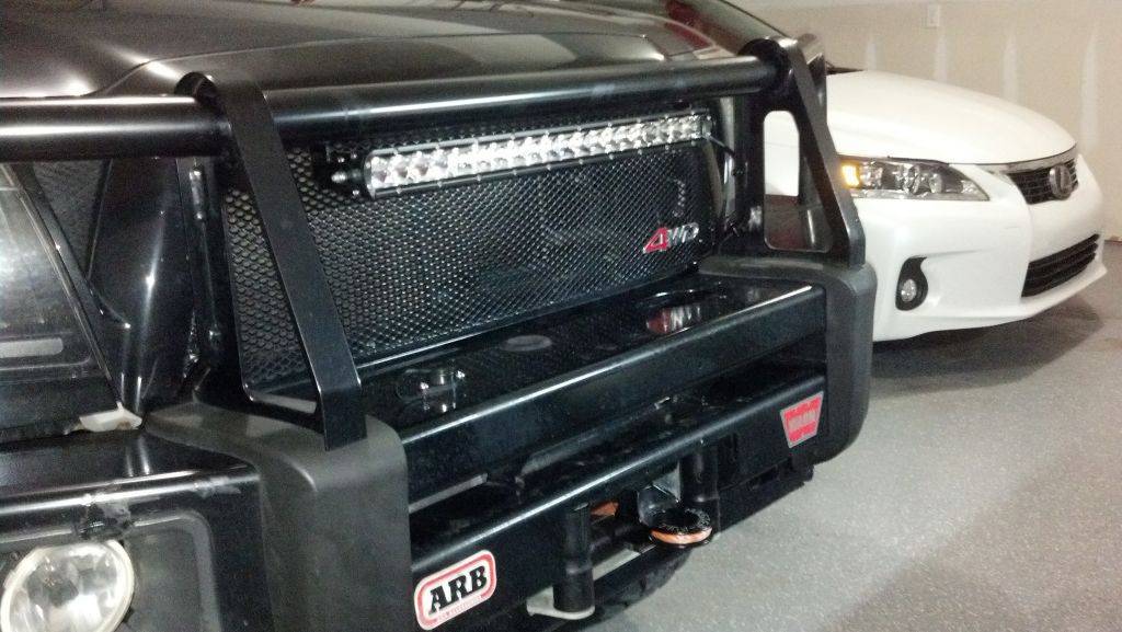

    A few bolts are different.
    Rigid 20" SR

    I'd love to have that but that is way to much for a light in my opinion. I can't swing that much cash for that.

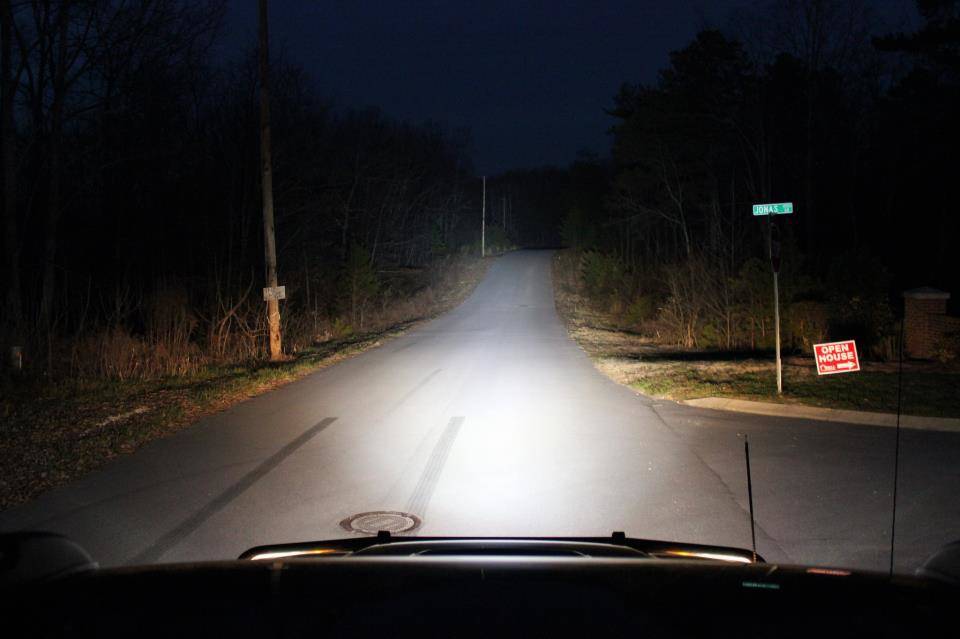

    Blitzpro 21S (Thanks to Blitzpro for the give-a-way!) mounted on B.A.M.F (Elusive Elements) behind-the-grill lightbar. The Demello and the place I mounted it creates a cut off for the beginning of light about 6 feet away from the truck.
    High-Beams only:
    Blitzpro only:
    High-Beams and Blitzpro:

    yes
    that looks brighter than my double row. What is the rated Lumen output?

    Luckily got a killer deal.
    6400 Lumens.

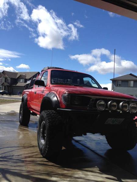

    Maybe those will help

    You do NOT want LED anything. No LED light bar shines further than your high beams. You have to understand that the lumens is like having paint... do you want to paint more in the center and more lightly on the edges? To paint more heavily with light all over takes more paint.
    If you want MORE intensity at range than high beams requires halogen or HID. If you want one light to flood and spot and provide high levels of both flood and spot it must be HID. The downside is warm up time for HID. HID is for leaving on and not constant activation/deactivation cycles.
    My suggestion... IPF 900FS with 55 watt HID conversion (ballast fits in the light housing) one driving beam and one spot beam 4300k bulbs. It will not have as much flood in close as an LED but will smoke your high beams and you can see deer off to the sides of the road better at distance. IPF work MUCH better than Hella 500 for controlling the light and wont break the bank.
    There is NOTHING out there that will flood like an LED and throw past your highbeams in one unit
