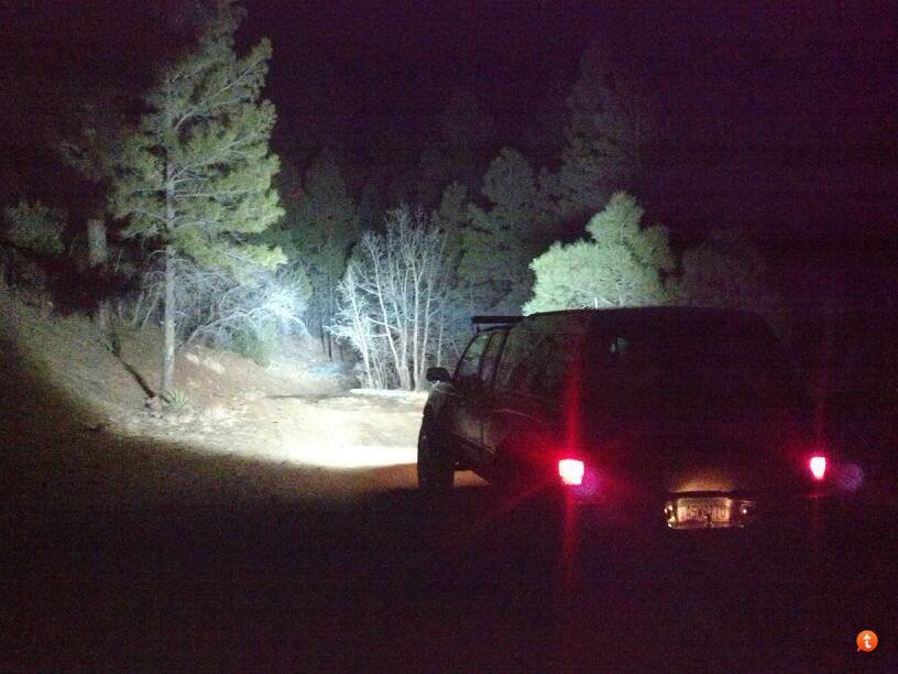

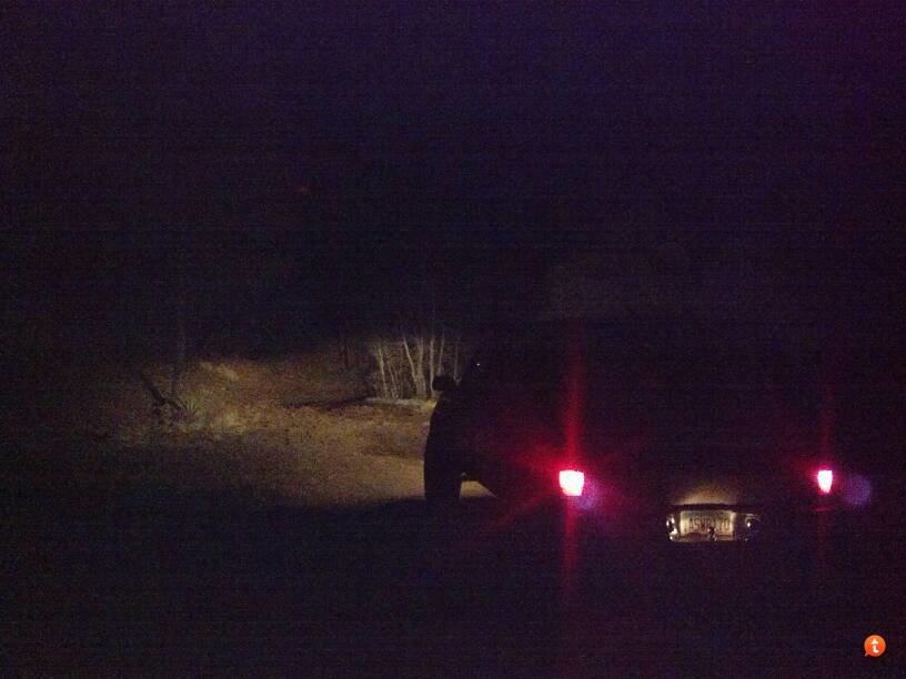

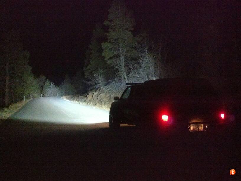

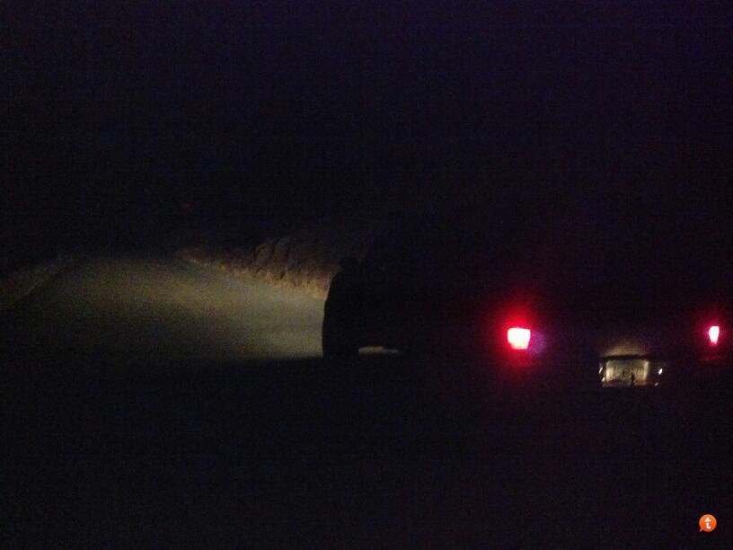

    Before...
    After...
    Before...
    After...

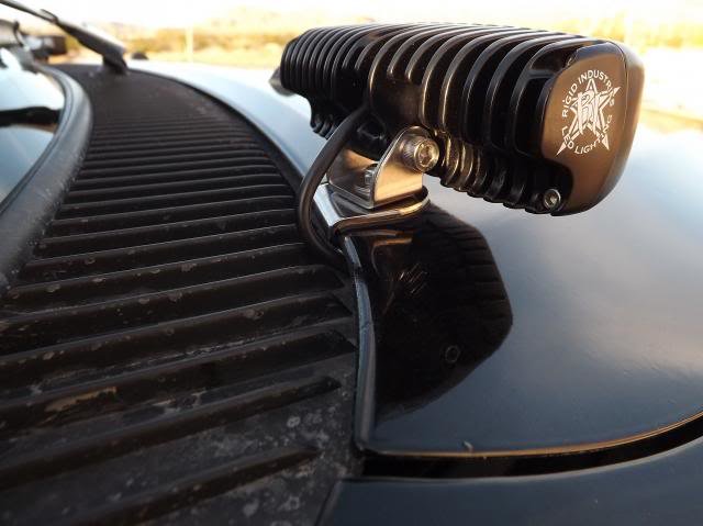

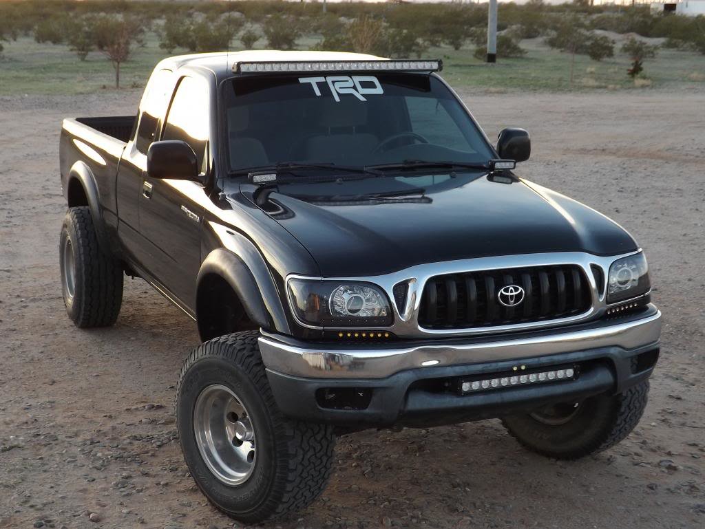

    Here's the hood lip mounts I used for anyone who wants an easy ditch light mount for cheap. I purchased these antenna mounts
    ($11.54 a piece http://www.ebay.com/itm/Stainless-Steel-CB-HAM-Radio-Antenna-Trunk-Lip-Mount-/111264454946)
    and took off the top piece. It has a recessed spot for a countersunk bolt underneath so it doesn't protrude and scratch the paint, and the nut goes on top. I did have to purchase smaller/shorter bolts. Then it comes with a thin square rubber piece with a sticky backing to stick in between the mount and the body. Then just tighten down the screws (was a little tricky to get to, had to use stubby and then angled screwdriver from underneath the hood when opened.) and its pretty darn sturdy.
    Got my 42" bar just resting on there now, drawing up my brackets...

    Looks great! What are you running?
