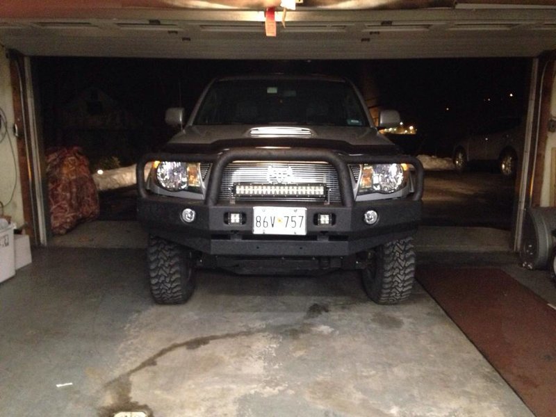

    Switched my front end around last night.
