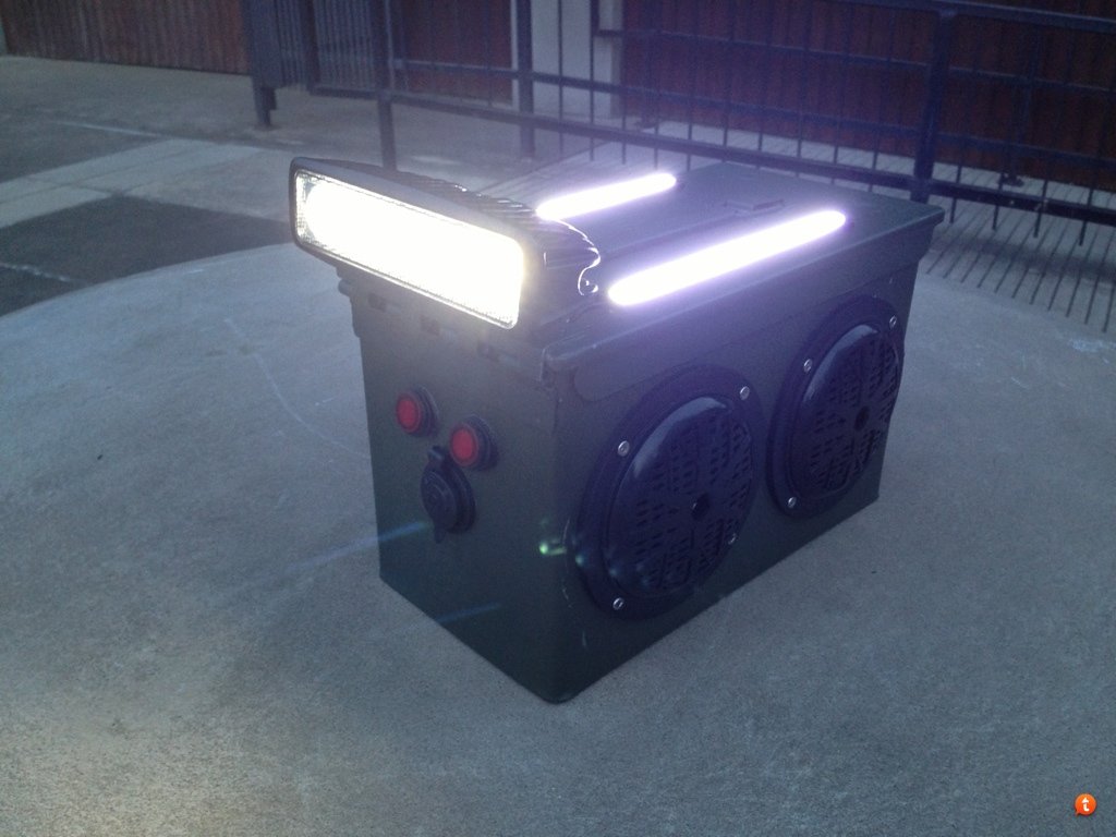

    Does this count? :)

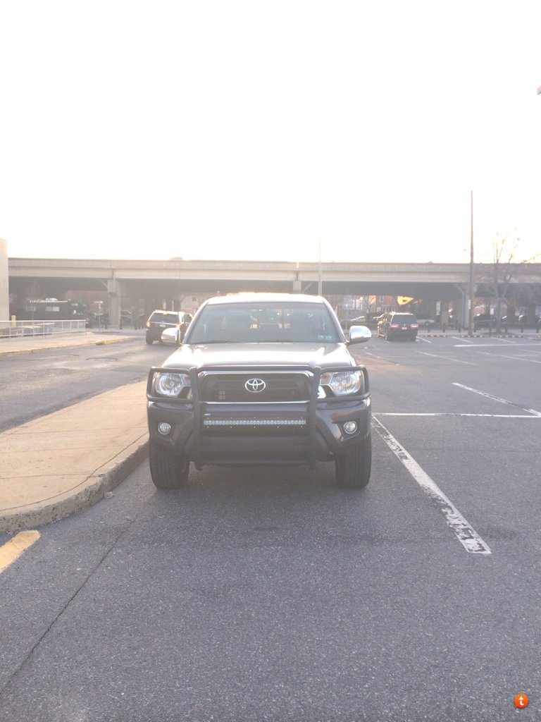

    Spotted?

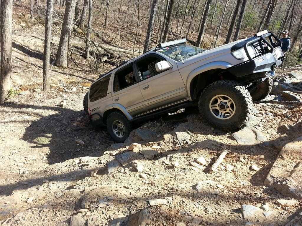

    my 42" dr and 30" sr :D

    I like the setup, dude! I don't know if there is anything to convince me to get a bar on the roof. Unless they're pointed to the sides and rear. If they're pointed forward it's all just fill light. I'm throwing spots up top. Just to get light down the trail. But, different strokes for different folks.

    Thanks! The 30" up front honestly puts out more usable light than the 42". I lose a lot of light b/c it reflects off the hood and scatters. I'm about to blackout the center section of the hood to avoid this.
