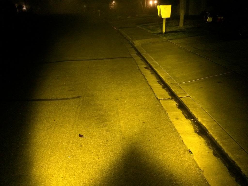

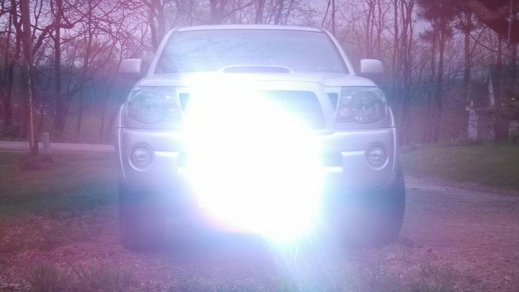

    22" Rampage LED light bar, 9600 lumens. Mounted behind the grill. I took this pic at 4:00pm. Really pleased with the light output and the clean look. Hopefully it'll stand up well over time.

    Ok, thanks for directing us back on topic, haha.
    But, all I see is a big blob of white.....
    I don't mean to be a dick or anything, but I think I should explain some general 'guidelines' for led pics...
    If y'all don't mind...
    Take a FEW pics, or 2 at least.. We LOVE pics, and lots of them:)
    Like, maybe one of the lights mounted being turned off.. so we can see the bar itself and how you mounted it..
    One with them on either in daytime or night..
    And one of the light output on the road:)

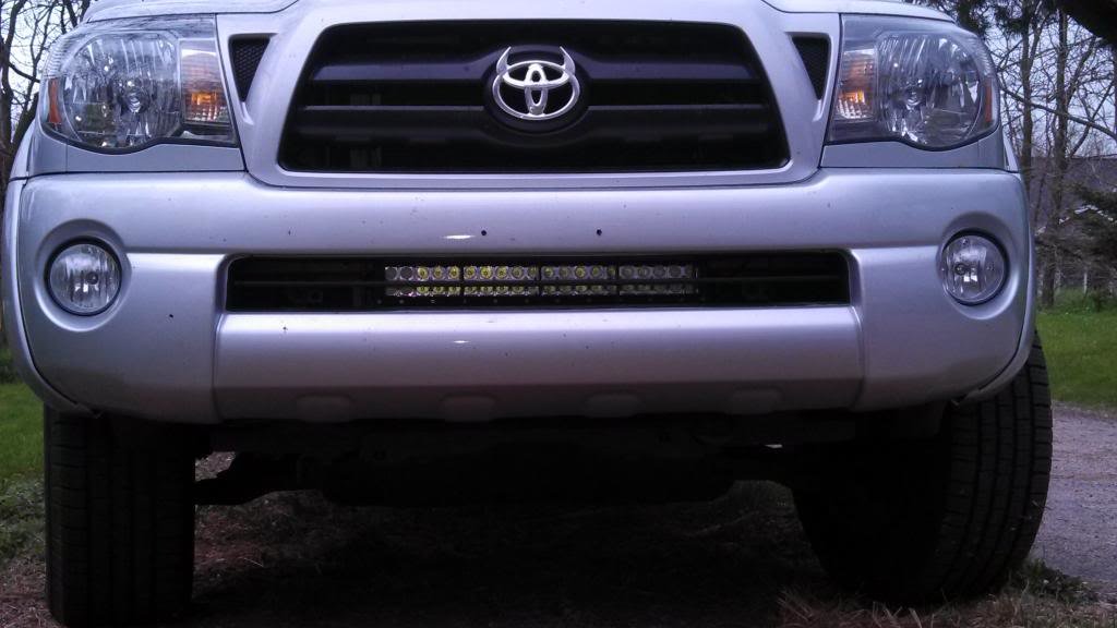

    Used some perforated 1.5" angle and bolted to the back side of the bumper.

    Lookin good. But I think you shoulda saved up a little more and got a 30" to fit in there:)

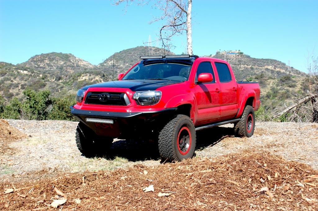

    I would say go for 2 or 3 shorter length amber bars and combine them. I think that'd look pretty sick anyways.
    Like this truck. Not sure who's this is, I just saved it.
    But 2 bars up top would look sick in amber. That's the only option I see. If you cam find single rows like that. I saw some from vision x (single row) but only come in 12". 3 of those maybe? But would come out to $1047 whereas rigids is $999 for the 40"...

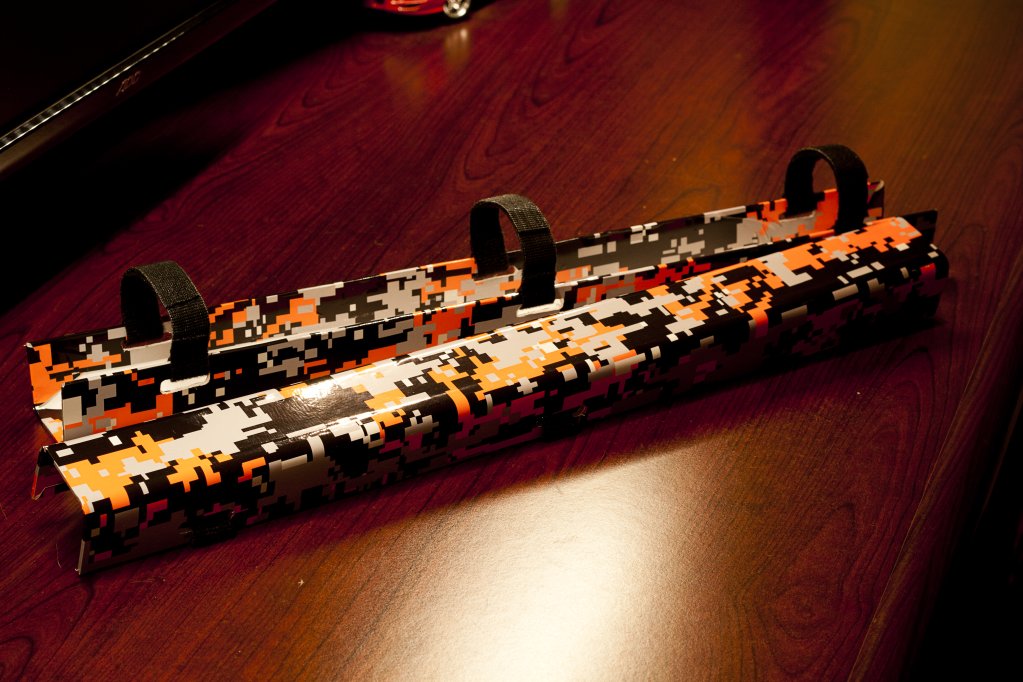

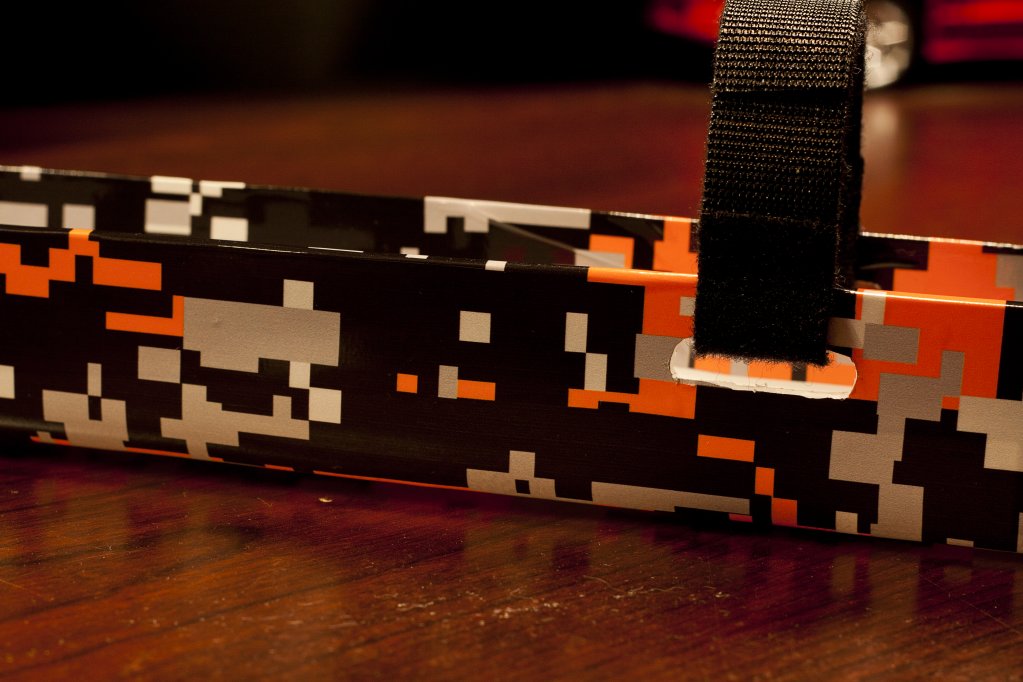

    I have a yellow headlight film on my 20" right now. Works okay and was only $4.
    As for the covers, I made some clear ones out of 1/8" plexi glass using heat to soften it then bend the edges over. I dremeled some slits in the roof set and sewed in some velcrow strips, but didn't feel like taking so much time for the 20" so I just wrap the Velcro strap around the outside. I ended up covering them with black vinyl so they block light.
    The orange camo didn't last long. Just didn't look good.

    Wow that's an awesome job regardless! I like it!! My idea sounds too complicated now. Ha. And yeah the film would work too. Idk why I didn't think of that cuz I wanted to get some uv resistant film (clear) to help prevent yellowing. Since I don't have covers and it never sits under cover/shade:/
    Bit so far I don't see any yellowing. I may be good.
