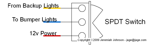

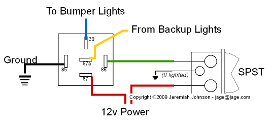

    Like this ?

    Awesome. Seems way simpler than the other way I was looking at doing it with 2 relays and 2 diodes.
    THanks :beer:

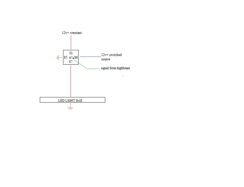

    I mentioned to someone else, you can do a setup where you have an 'ALL ON' switch, on with 'HIGH BEAMS' and individually switched. - The way I would do it would be this
    87a would be to the all on switch, and then coming off the headlight trigger -> have a diode inline to the 87a on both sides of the lines - that way it controls the direction of the power. Not triggering the high beams when it is on, and more importantly, not triggering the rest of the lights when the high beams are on.
    Something like that.

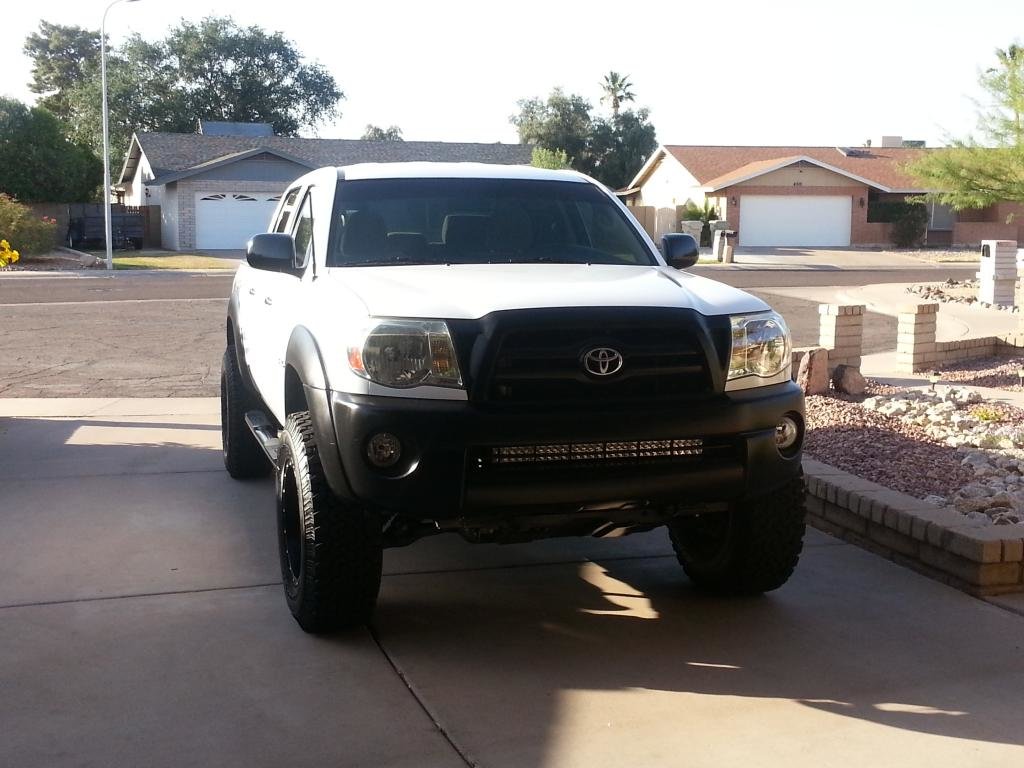

    30 inch double row from OKLEDLIGHTBARS.

    That fits in there pretty damn nice huh?
