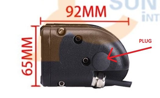

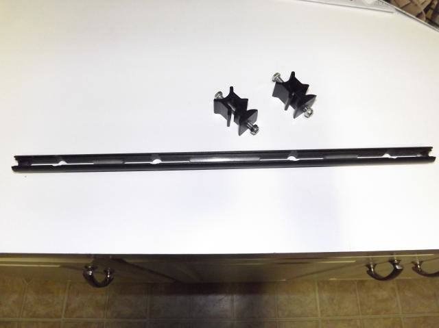

    Yeah I have 4 of that same bar. The mounting for these are quite different from others. Gonna be hard to explain without pictures.. But they use a shaft inside the bar, that has bolt slots in the shaft and you slide the mounts in, and the bar has notches for adjusting it. When you tighten down the bolt, it 'wedges' itself in and tightens down. You can adjust the angle on those notches. I ended up taking the shaft out of the small 8" ones. But the bigger ones it seems the shaft doesn't wanna come out. My 20" I had to partly disassemble to get the shaft out. I didn't do this on my 42" though. I ended up getting a long ass 1/4" threaded rod and inserted it through the shaft as there's a 1/4" hole on each side of the shaft. Then I put nuts on the outside. Not the greatest option because at that point there's nothing 'locking' the bar in place. I just used some rubber washers in between the bar and the roof bracket and tightened her down. Seems alright for now. I may end up drilling another small hole through my roof bracket through the end cap of the bar with a small bolt just to lock it in place permanently. If you can get the shaft out, the hole in the end cap is bigger and you can get actual bolts to put in on the ends... Hope that helped. Idk if I can get pics or not for ya since I really don't wanna take any of mine off as they were a bitch to put in, ha. I can take pics of he roof mounts if u want...

    Does that mean the mounting brackets can be positioned on any point on the shaft, as opposed to the common bars that only have the mounts at the ends? Does the shaft need to be taken out to insert the brackets? Also in your opinion, would you say these bars have more throw than bars that have 3 or 5 watt leds? Thanks for the detailed reply!

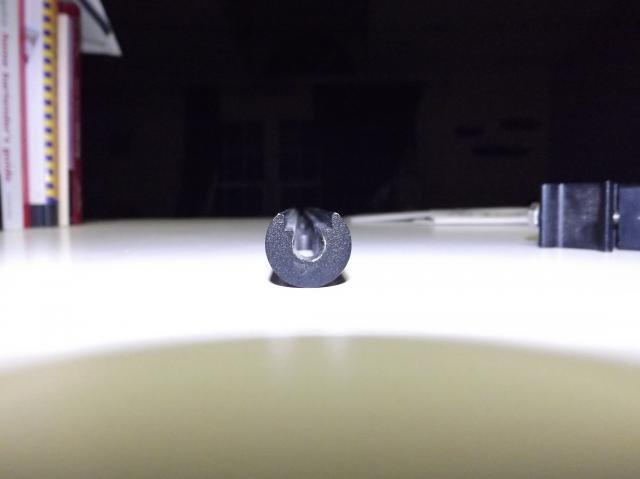

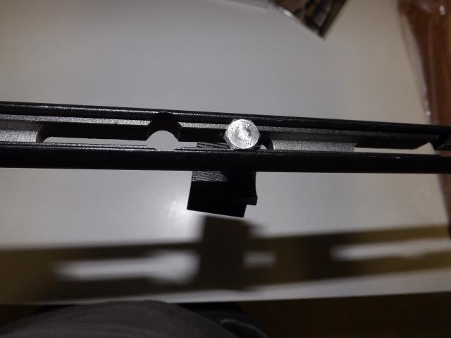

    Kinda yeah. There are multiple slots in the shaft but it doesnt run all the way through. But since theres a bunch it can be positioned almost anywhere. No the shaft doesnt need to be removed. It's kinda wedged in there and can rotate. I think its supposed to be removable, but it doesn't wanna come out at all on the bigger bars. It comes out by rotating the shaft and it has a big enough opening that it should fall out but I think because these are cheap china made knock offs they are just a little too tight. I even tired prying it out of my 42" and just couldnt get it. But yeah the bolts just slide in the slot, using the brackets it tightens down by wedging the inside shaft against the bar which is in a little slot under the fins. I have the 20" shaft that I took some pics of.
    The end cap has a little rubber plug that easily comes out as well if you decide to use a threaded rod like through it like I did. Really the only reason to take out that shaft, is if you wanna use larger bolts instead of the threaded rod, or instead of utilizing the mounting option it was desigend for. But then if you do it with the provided mounts, it can only be mounted on the underside of the bar. Or 'hung' and mounted upside down.
    As you can see the shaft has multiple slots. As well as a small 1/4" hole on the ends which is where I slid the threaded rod through the end cap, through this shaft, cut both ends off, and put lock nuts on the ends.

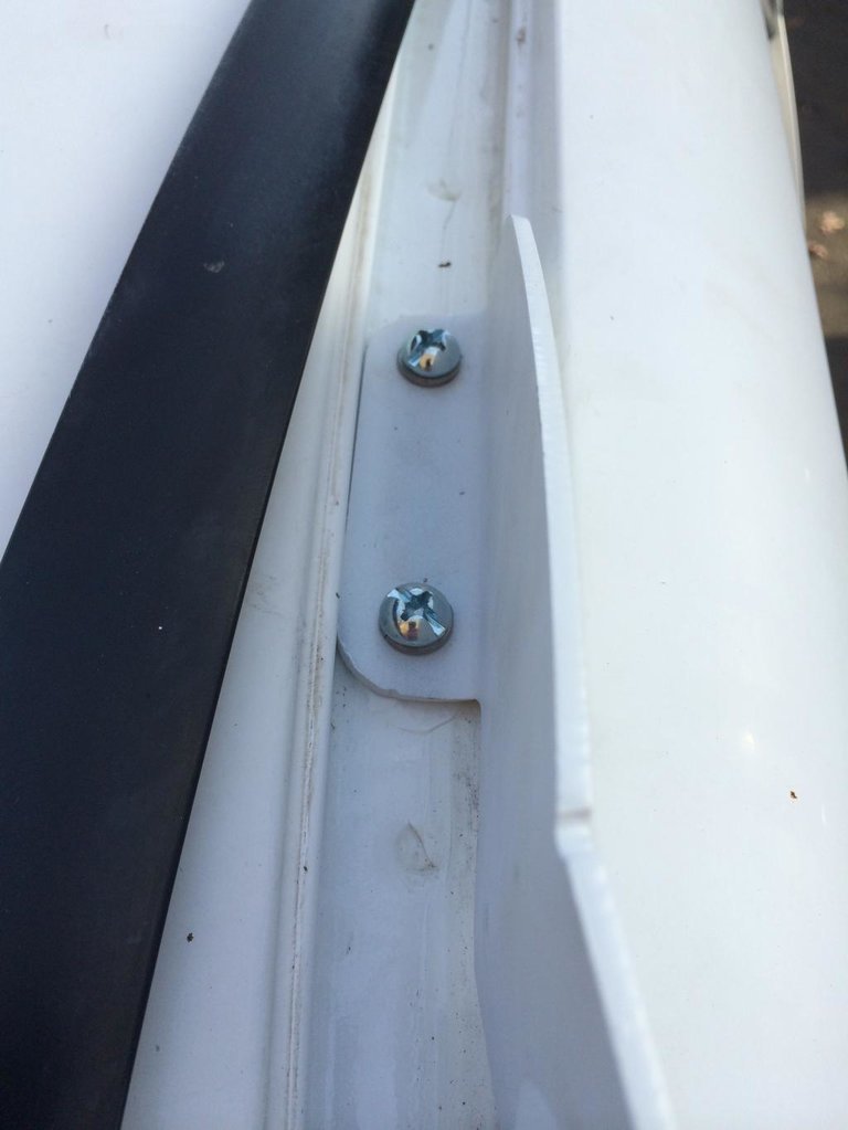

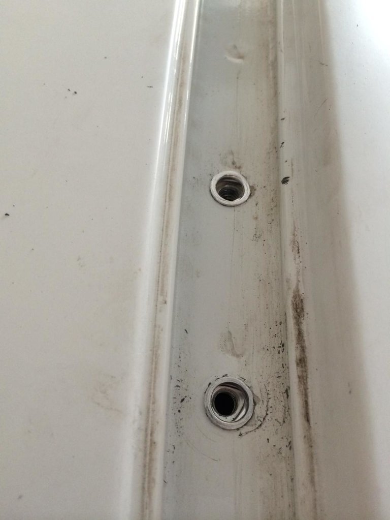

    did you install the riv-nuts in the roof or are those factory threaded holes? I was thinking Double Cabs are the only ones with roof rack mounting holes from the factory.

    what mounts are those?

    How does one keep those holes from leaking?

    Any sealant really. I used a butyl based tape behind the mount, and tightened it down, squishing the butyl in between. Creates a good seal all around the mount base. Or even the butyl strips like that used in resealing headlights would work great. Or just silicone. Butyl is easier to reseal though if you ever have to take it off.
