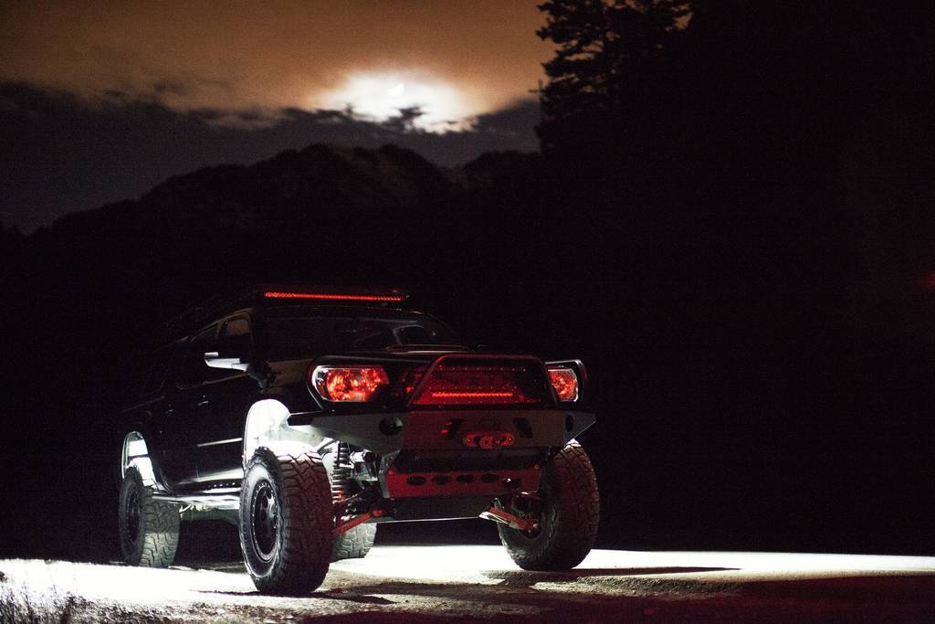

    What's with the red glow? Is that from someone's tail lights in front of you?

    Check the build thread.
    That's exactly what it is lol good eye!

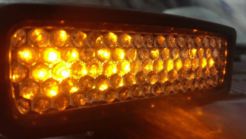

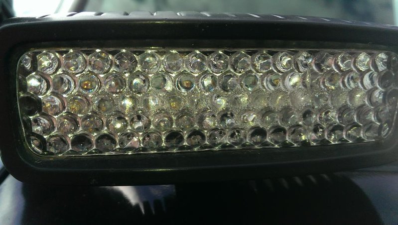

    Welp.. It's official. I am now a victim of condensation. Can anyone guess the brand?:rolleyes:
    Kinda obvious with the optics though.
    These also were flickering on me yesterday after a good rain, when they were deactivated with a relay when headlights were activated. Then noticed the condensation today. I'm unsure if it's the relay or from the condensation inside. Probably the relay which also had the cap loose, as they were hyper-flashing when they shouldve been unpowered. Kinda strange. Had to disconnect them completely. They are working fine today though after it kinda dried out.:confused:

    I would venture to say its your relay... the cheap relays are not usually waterproof enough or at all for that matter. water could be splashing on them depending the location. I also have seen relays not mounted properly, get turned upside down. that asking for one to short out or rust open/closed.

    Hm. I WAS driving around for half the day in the rainy weather. Probly was the relay. I really need to redo my wiring. they are just kinda slapped in there in a big rats nest. I really really wanna get one of skygears fuse/relay boxes. Trying to muster up the nerve to shell out $200+ for one. Plus a second battery in the future to complete my setup. I didn't wanna spend any more messing with the wiring and adding misc crap along the way. Got other things needing attention first. But I could look at it as a needed investment. So I don't fry one or more of my bars, or something else on the truck, or the truck itself with an electrical fire!:eek:

    Sure enough. It was the relay. Got water in it. Was upside down. And got all rusted. Swapped relay and all is good. So next project is to create my waterproof case. already have the case and other things like cable glands. See if I can create a box, before I spend the big bucks on one of those really nice waterproof relay boxes. Should be fun.. I'm also still trying to figure out what the best quality automotive wiring to use. Anyone have any input on that? I'm sure it's been discussed. Just too lazy to search. Hoping there's a zip type like speaker wire but haven't had any luck finding it...
