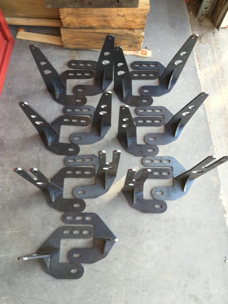

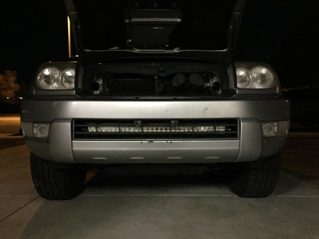

    Wanted to gauge interest to see if you guys might be interested in some 100% bolt on LED bar brackets. I make them for 4th Gen 4Runners and now that I am a 2nd Gen owner again I thought I could make some for the Tacos too. They are laser cut 3/16" steel, require no cutting or drilling to mount, unless you want the flush mount version that requires cutting out the stock lower grill. I sell these for $113 shipped. If enough people are interested I can design and start to sell them for 2nd Gens (2005 - 2011) as well. Let me know what you guys think!

    has anyone used this on a 2015 .. as I was wondering if there was enough clearance to mount this.
    Plz confirm if you have used it and no fitting problem as this would be perfect for what I need it for.
