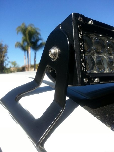

    ^^^Shameless Cali Raised Plug ^^^
    :D

    Does the curved light bar reflect off of the windshield and hood? I have been reading a lot about glare.

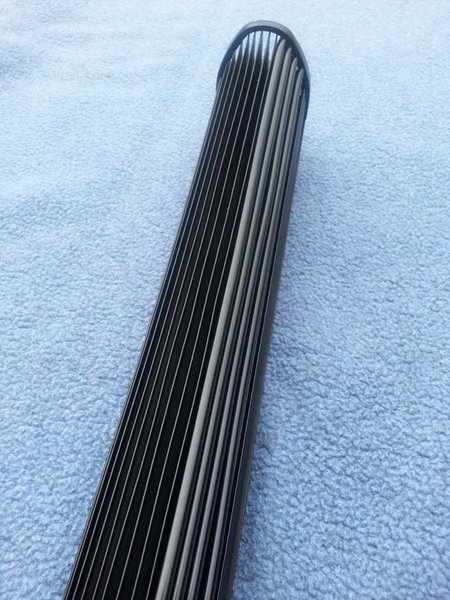

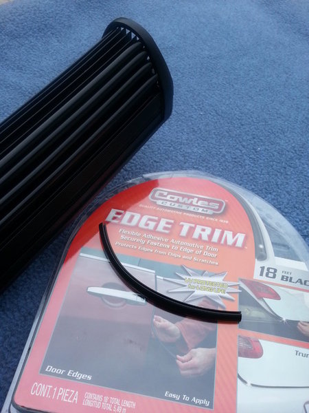

    and.....the wind whistle is like riding next to wounded baboon unless you do this mod! I ended up putting it on every fin and it cured 90% of the howling! :D
