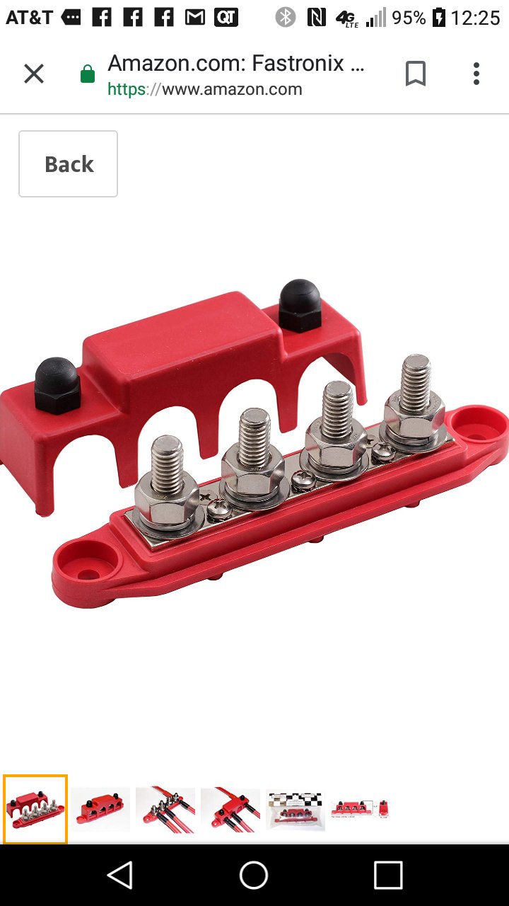

    Do you all think I could use something like this as a place to hook up all of my post ignition hots?
    I'm thinking running one line from the fuse tap to this and then tapping everything else off this.
    Or would that be too much draw through the tap?

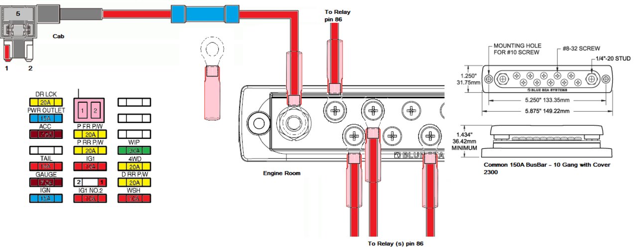

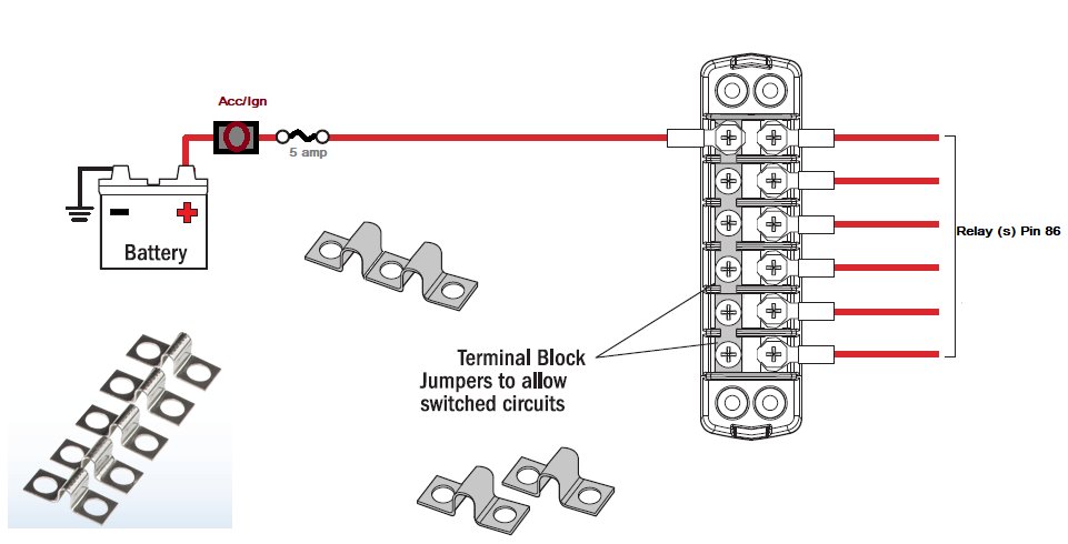

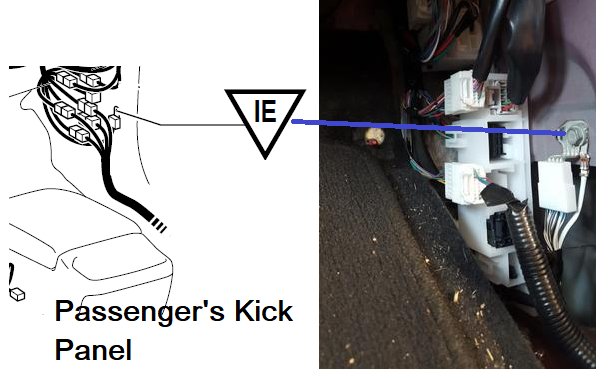

    If it's to continue to add to what you already have I recommend something like this:
    The relays need very little current to actuate, also small gauge wire is what you need. (relay pin 86 & 85-back to switches)

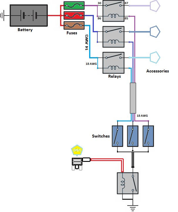

    In your year this should be best:

    Currently I trigger the relay through the ground, but it's alway nice to have options!

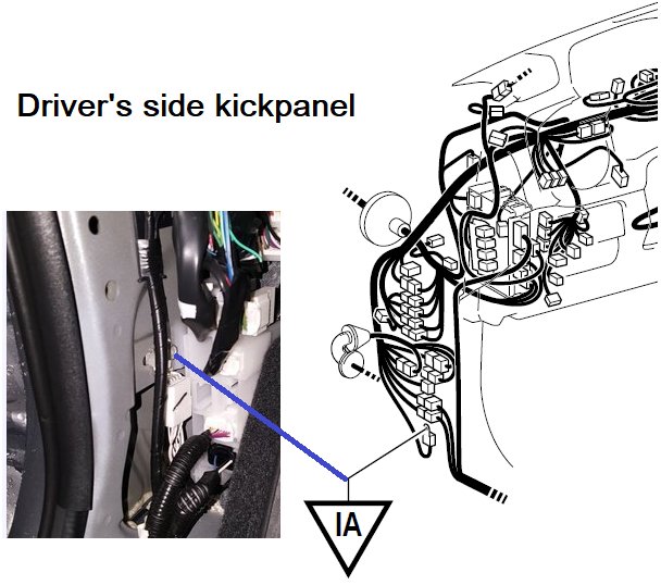

    More stuff for ya OP

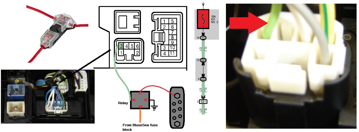

  15. May 15, 2019 at 2:43 PM
    #75
    caribe makaira
    caribe makaira Well-Known Member
    Feb 13, 2011
    #51121
    11,786
    Caribbean, Puerto Rico
    05 PreRunner TRD Offroad AutoTrans
    Hood Struts, My version Fogs always ON, Map & Overhead Light Mod,
    So you can use the inside IGN tap for something else later. Get T -Tap and place on IGN wire inside engine room fuse box on connector EB1 slot 3. And so you don't place a "strain" in the 10a IG1 No. 2 circuit, add a relay to actuate with that input.
