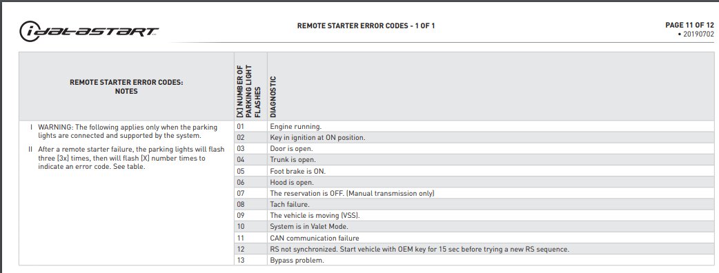

    Question 6: Does the vehicle remote start?
    NO: Verify the remote programming, the RF connections and check the remote start error codes. Repeat the test and call technical support, if the problem persists.
