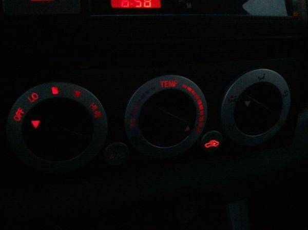

    Intermitent functioning of cluster lighting after installation suggests that you do indeed have a bad connection. You indicate that you've checked all the connections... Fair enough. We do not suspect our unit as the source.
    Have you:
    1. Checked the lighting with and without our unit attached?
    2. Checked the lightinh and circuitry with a DVM?
    3. If you suspect our unit is causing the intermitent cluster malfunction, have you considered replacing the unit (free of charge)?
    4. Is it possible that you either nicked a wire or somehow shorted something during the installation?
    We will back our product fully for up to 3 years. We can NOT however, back your installation for ANY amount of time. You as the purchaser accept ALL responsibility for a proper installation. That in mind, what is it that we can do for you to help resolve this issue? We are willing to replace the unit and help you trouble-shoot to the best of our ability over the phone. (Please call Dennis LaFreniere at 757-288-5702). He has emailed you at least twice in response to your requests for help but has not, as of yet, received a call.
    Please let us know what specifically you want and or expect us to do.

    I was in contact with Darren and Dennis via email. I soon later called Dennis as well. He provided his recommendations and I will follow up later... I'll check installations and what not again and follow up.

    Ant, Curious to know if you determined the cause of your dash light issue???

    update:
    so i took apart the cluster and carefully inspected the wiring again, specifically the crimp just to make sure it was on correctly. Well come to find out one was slightly off or didn't clamp properly. So needless to say, i redid it and so far it is working.
    Thanks flyzeye for a great product still! Hopefully that overlook on my part was it. :)
