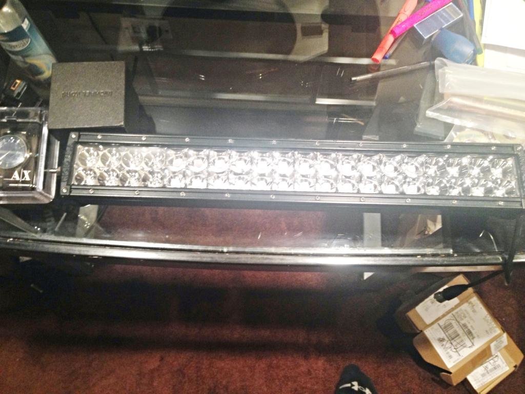

    Just received my rigid 20'', should I attempt this?

    I don't know if I'd do this to a rigid. Unless it's second hand and they don't offer warranty second hand? I don't know. I'd imagine any kind of disassembly to any lights though, no matter what brand, would void warranties.
    Might have to give this a try on my 40" chinese brand.. However it looks like the new 3D optic bars look better with this mod. Still cool though. Kudos to the originator!

    Yeah, it would most likely void Rigid's warranty. If you do, make sure you reseal your light bar very good.

    IMO I wouldn't do it to a Rigid Bar. Like the guys said, it'll void the warranty and you don't want to risk ruining it because they're so damn expensive!!:eek::boom:
    But honestly, if money isn't the biggest issue, I would totally do it. Just be super careful!!

    Where are all of you feeding your wires from the LED strip out of the LED bar?
    If it isn't too much to ask, please provide close up pictures.
    Thanks

    I'll have to get one, but either just around the side under one of the metal heat sink/dissipators or drill a hole through the end of the bars cap and then silicone it real good

    Later on when i get home, i'll try and take some close up photos for you. Mine just pokes out the side, then i siliconed the crap out of it!!:D
