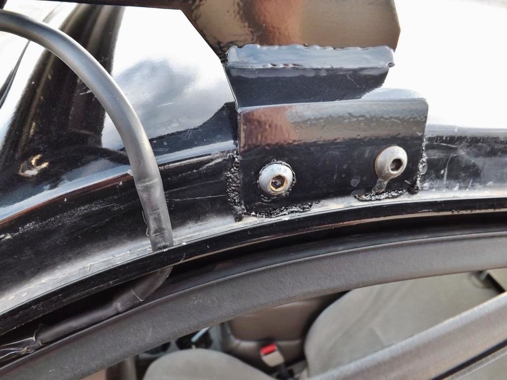

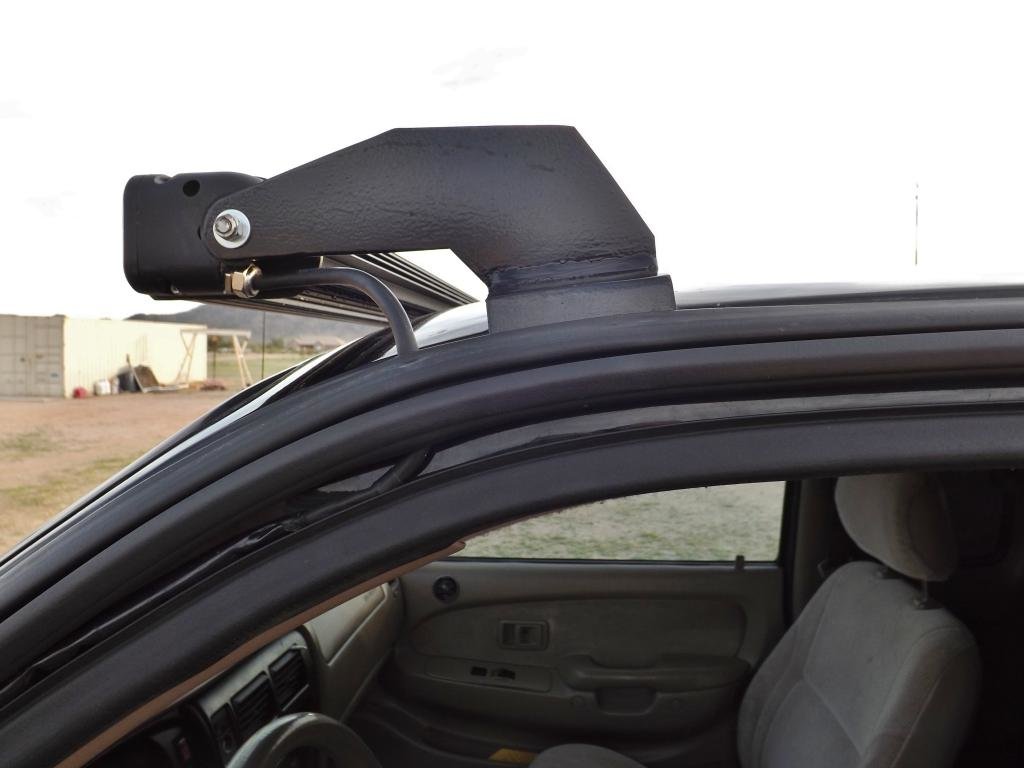

    Actually yes I had the same issue. What you could do, is snip the connector off, add in the length you need, and use some butt connectors to reconnect. I actually drilled a hole in the rain gutter using a bit just smaller than the thick insulated wire coming from bar, squeezed the wire through, and used butt connectors to add in my own wire, and used a relay. Didn't even use the connector. But you could reconnect it. You could even take the connector wires out of the connector and only use one pair of butt connectors, instead of having to do it twice. But those wires can be a bitch to get out. Need a tiny flathead iirc. Here's my rain gutter method
