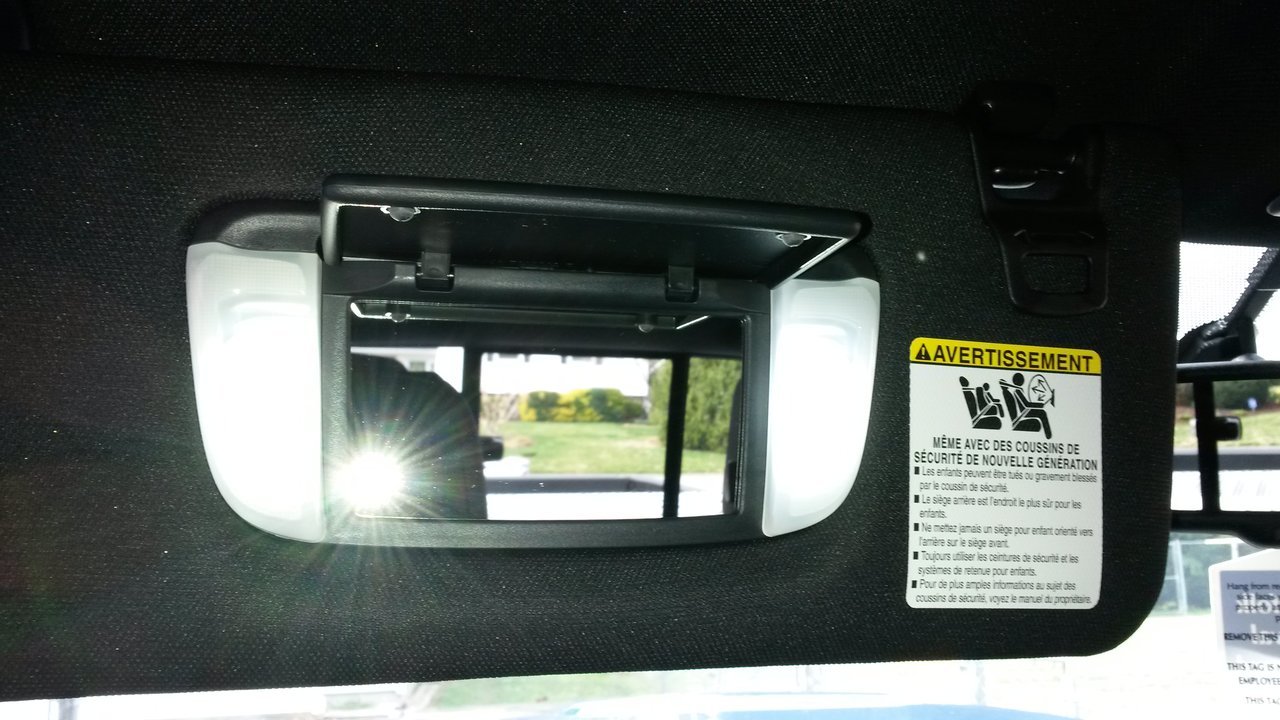

    I put a cheap set of interior led bulbs in mine when I bought it. The vanity lights are bright as crap and never had an issue with them.

    Do you remember how long the festoon bulbs are in that location?

    Been a couple of years but I will look for the ad I purchased from on ebay. Maybe that will help. I have since converted most others to mesojdm fixtures but the vanity led bulbs are still there.
    Here is the kit I bought feb 2016 for $11. Maybe you can ask the seller what bulbs are included for the vanity lights.
    https://www.ebay.com/itm/12x-2016-2...079576?hash=item2a4ac56f98:g:s3gAAOSwFqJWnxbH
