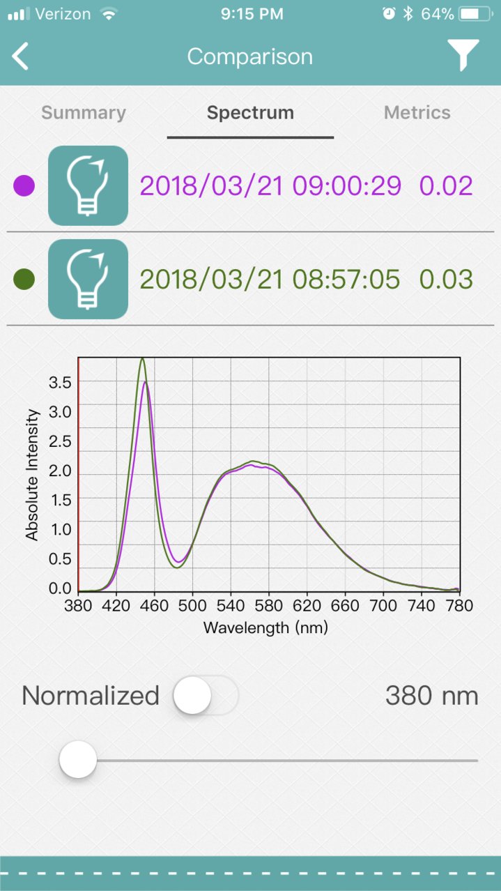

    Those LED pods I suspected were the same internally, where one was 3x the price of the other but output looked striking similar?
    LED spectrum comparison:
    Looks pretty identical to me.
    commbubba19 and ToyoDrew like this.
