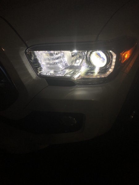

  9. Dec 21, 2016 at 8:59 PM
    #209
    krze4elk
    krze4elk Well-Known Member
    May 21, 2016
    #187573
    318
    Oregon
    2016 Tacoma TRD 4x4
    Aero turbine 2525xl, VLEDs interior and exterior lighting, Line-x rocker panels, Bushwacker Fender flares. Goodyear Duratrac tires with Dick Cepek DC2 wheels, Betterbuilt Toolbox, Cali Raised LED light bar. Morimoto H11b 5500k HID lows
    Love them. The photo here lights are little more on the purple side in person they match the stock led drl perfectlyimage.jpg

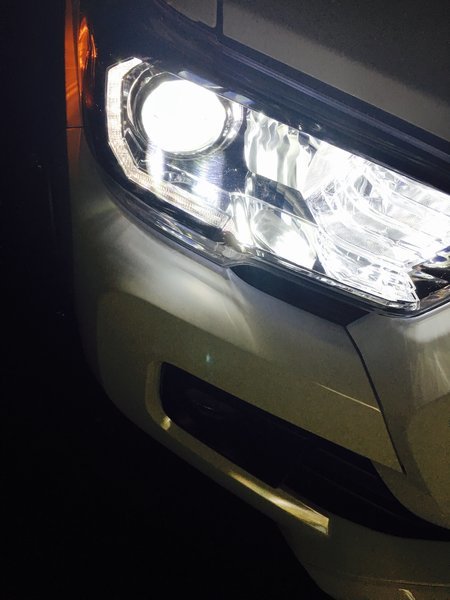

  20. Dec 29, 2016 at 6:48 AM
    #220
    jesse.thomas
    jesse.thomas MisguidedMelon
    Sep 29, 2008
    #9571
    36
    Jesse
    Mile High
    '17 TRD Off Road Super White
    Stock
    Installed headlights and fogs yesterday. Picked some up from superbrightleds.com, and am very pleased with the result. The output of the 6300K lights matches the DRLs almost perfectly. Can't really tell a difference. Although, I'm not sure if you guys ran into the same issue as me, but the huge cooling fan on the back of the LEDs made it so that I hadto remove the headlight housing to get them in. This made theinstall a bear because you have to remove the grill and the front bumper to get the housing out.
