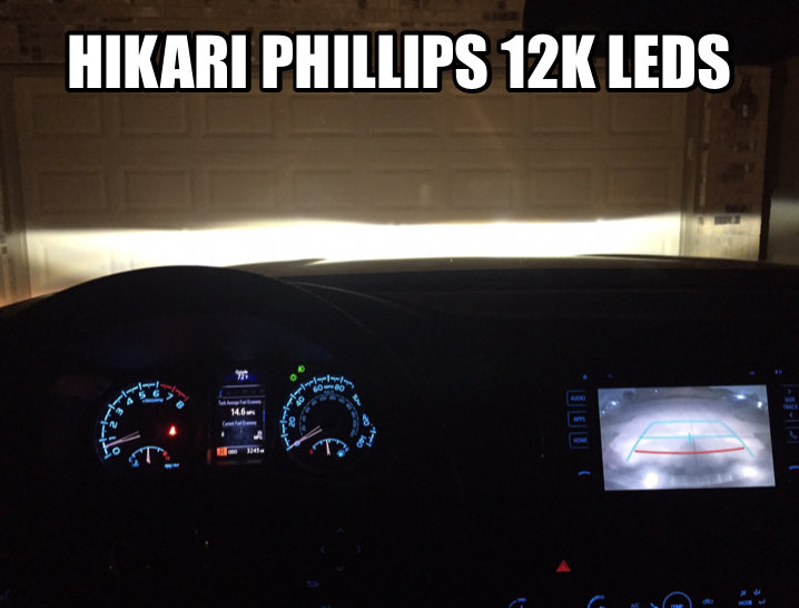

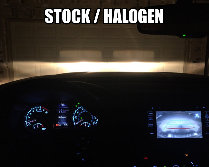

    Here is another question, does anyone know why the stock lights have that additional 2 “towers” of light on top of the cut-off line?

    I was the one asking. I wanted my cut off a bit higher so I could see farther out. Once i exchanged the stock bulbs for the Hikari LED’s, I feel like I might have sacrificed some distance.

    The cut-off is at the same spot but lost the “towers of light” that allowed me
    to see a little further ahead.

    Gotcha but don’t you think you might be blinding people at if it goes any higher? I noticed that behind a sedan at a red light like a Camry for example, the cut off is right at thier upper trunk, right where it should be with any other vehicle, no? If the cutoff behind another car is thier rear windshield, then that would be incorrect? I’ve never noticed these towers before...

    These "towers" are what I have been referring to as additional boxes of light above the cutoff beam. And are exactly what I have been saying you can get back if you spend $200 for the GTR Gen 3's. It is not worth it to me so I, like others, am going to raise mine just a little more but so much as to blind people. Just a tad. They are damn near perfect now, but need to be up about 2" at 25' from a wall. I think that will do it.

    I wonder how the GTRs manage to get those boxes back?
    What is so different about the GTRs?
    If Im gonna spend $200 on LBs, I might as well go HIDs.
