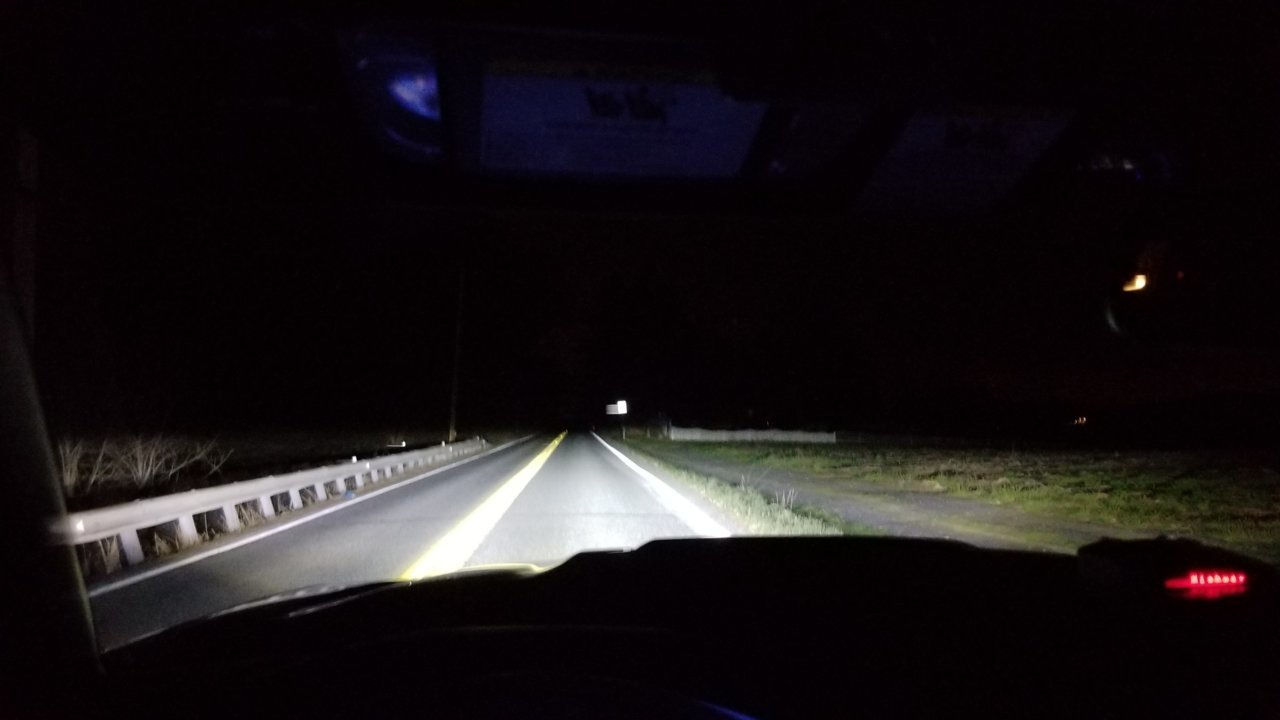

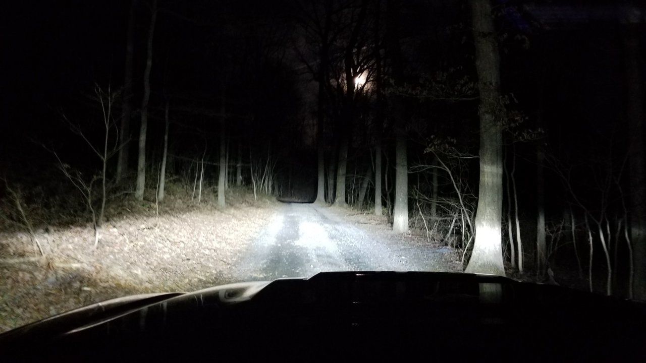

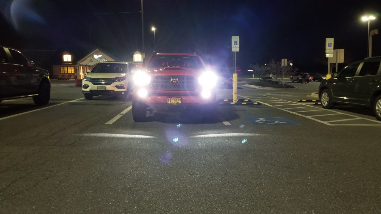

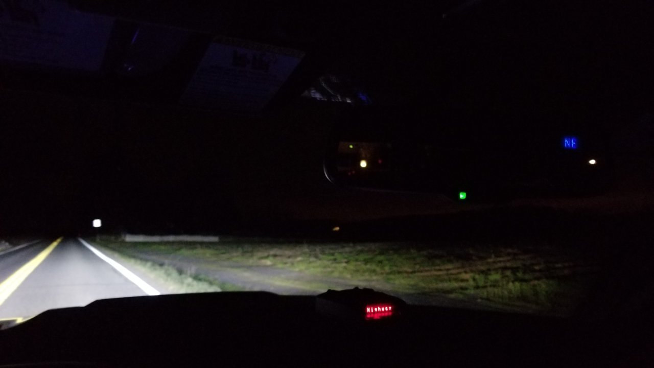

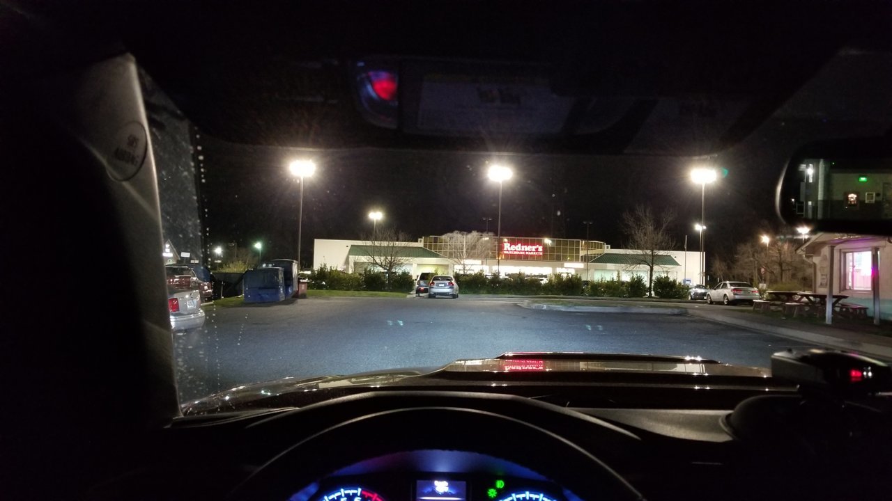

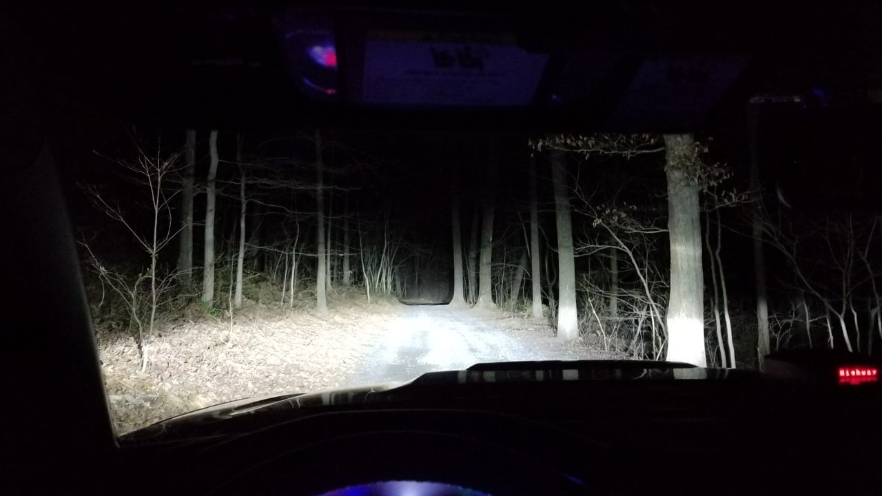

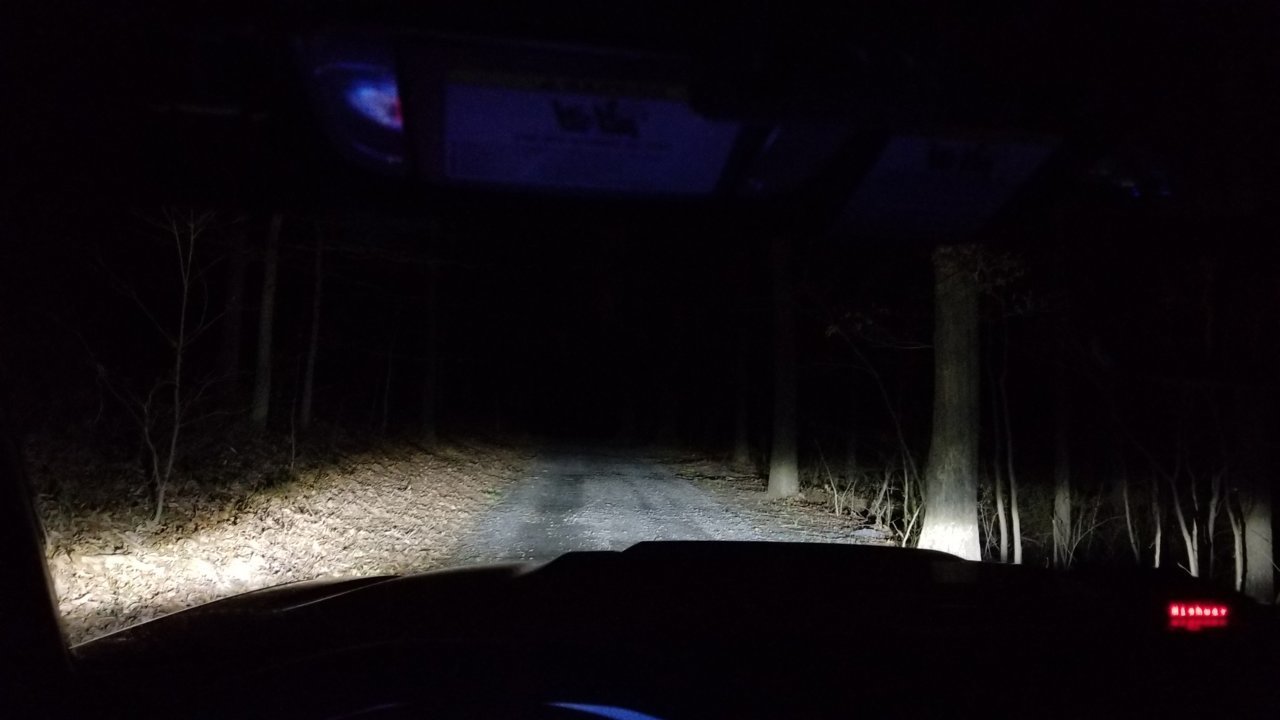

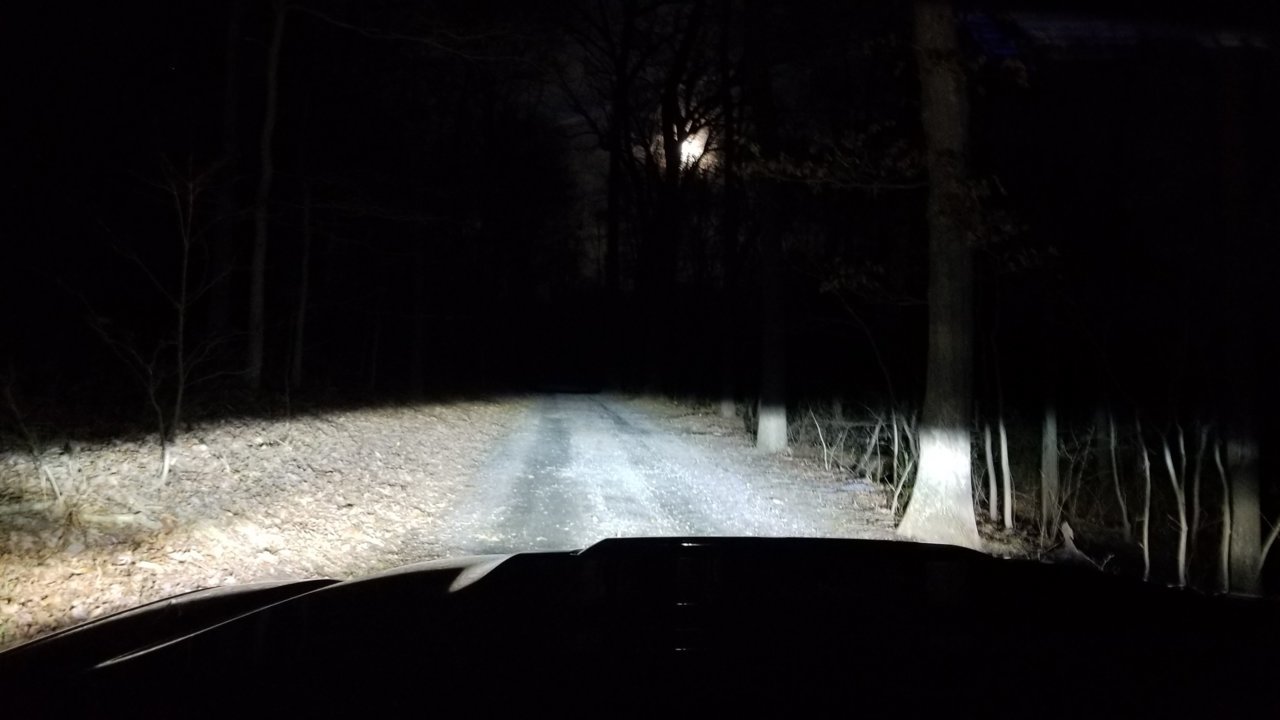

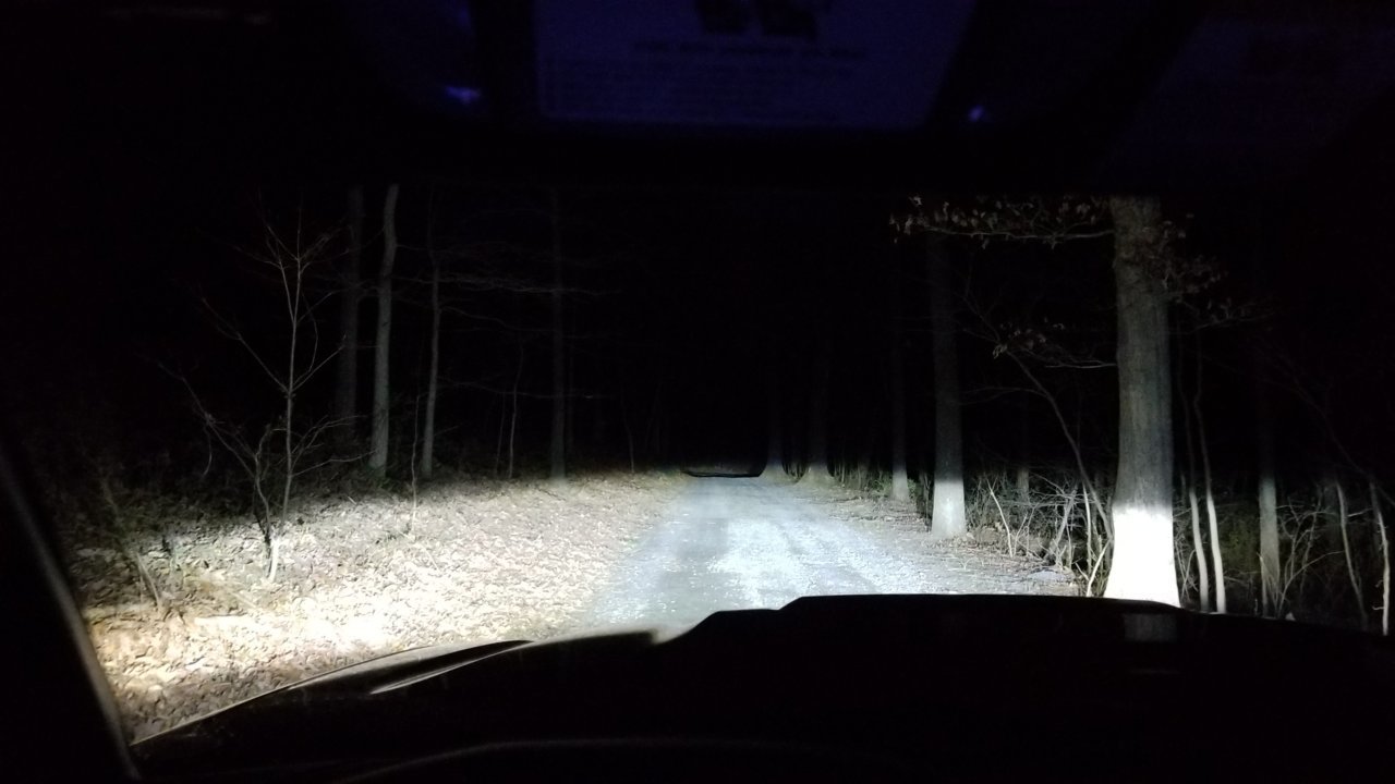

    Ok, so I adjusted the headlights and fogs. They are borderline too high but the only time I got flashed on my way into town and back was going through a roundabout and the roadway angles for me and the other vehicle made them too high. It's a rare instance but it bugged me. However, there were many other instances where I was cresting a hill and my lights were definitely high and no one complained. People up here are quick to let you know you're highbeams are on! So I'm on the fence and will try a couple more times at night to be sure.
    Here are some new pics.
    Before adjusting:
    Low beams, fogs and DRL
    After adjusting:
    You can see the base of the trees farther up the lane. Also, there is more illumination of the trees on the sides farther away as well.
    Here is the lows and highs, and DRL:
    Before adjusting
    After adjusting
    Besides the obvious amount of illumination directly around the front of the truck, look at how much more illumination there is farther down lane where more light is critical in deer country.
    Now the Fogs.
    Before adjusting
    After adjusting
    Definitely an improvement in throw! This is how they should be!
    All those shots were taken with the camera from the drivers point of view, right in front of my face to show that there's no loss of light on the road in my view.
    So to me, I feel adjusting both higher is a definite improvement and the results are very favorable.

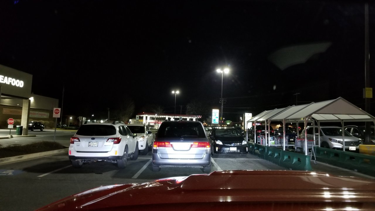

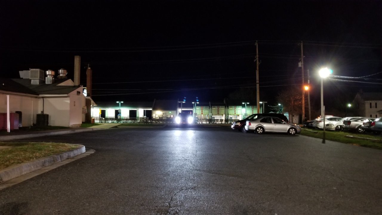

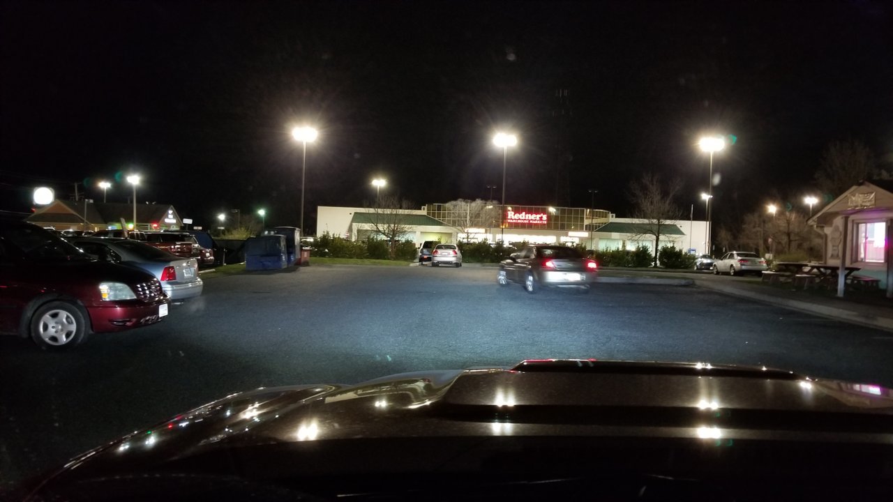

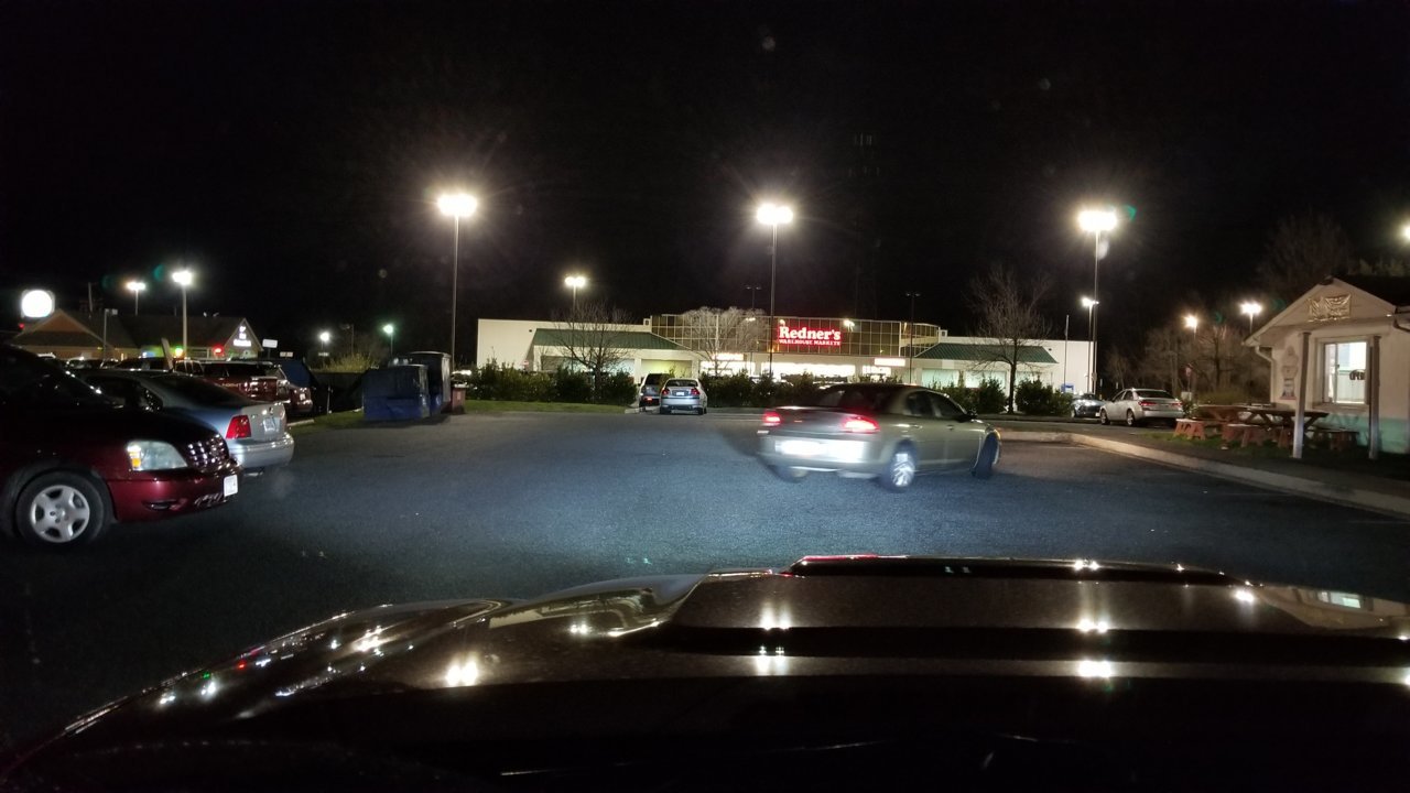

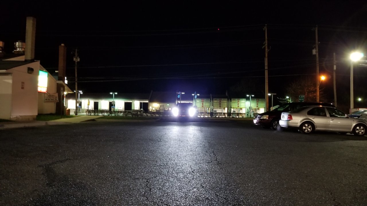

    So while I was in town I wanted to see what the lights would look like to oncoming cars. I walked at least 10 car lengths away and shot these and moved increasingly closer
    I honestly don't think it's offensive. I was crouching too so I was in the sweet spot.

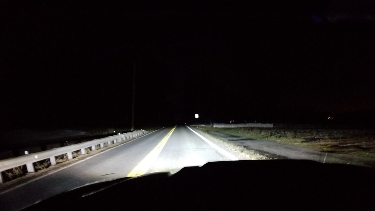

    Here are some shots from my point of view again but with traffic involved to show that after the adjustment they are not offensive.
    I also paid attention to the cutoff height on crossing traffic at intersections and it's just below the bottom of the door windows of most sedans. No matter what, Miata type cars will be affected. Anything larger than a sedan, like a Rav or up is no issue at all. The same goes for oncoming traffic. Corvettes will be affected, Crown Vic's not at all. This is truck country anyway so..........
    I'm completely satisfied and feel my safety has increased great when it comes to seeing deer on the sides of roads.
    Before
    After adjusting
    Here's the view of the field here that's cut off by the camera
    Adjusting the fogs really helped!
    I'm happy!

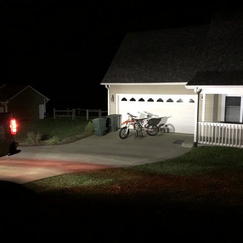

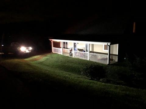

    Hey guys is it ok if i ask for recommendations on what I should get for interior lights for my 12 Tacoma? I have an led in the dome light, so I guess I just need something for the map lights. But don't want them to be off colored. So if needed I'll get map and dome lights. I have also been talking to a guy about for LEDs in my headlights and fog's. Then he has some hell of bright reverse lights.
    Here is the reverse lights. I need bright reverse lights. But don't want to do any pods at the moment.
    https://dieselleds.com/collections/...ndra-super-b-led-revere-light-kit-2100-lumens
    Headlights
    https://dieselleds.com/collections/...ht-kits/products/microslim-led-headlight-9003
    I know it's a different for 3rd gens. But a lot of people around here are running lights from this guy and I didn't know if anyone else has.

    Hey! What ya got there... CRF450?

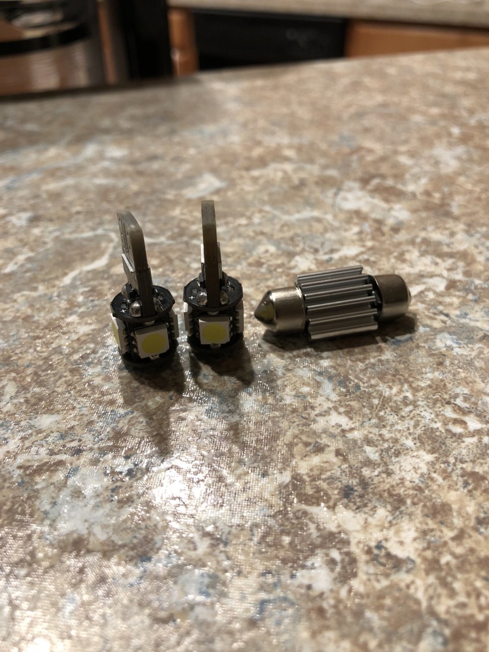

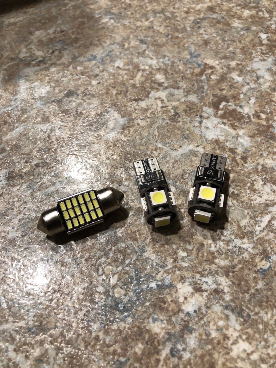

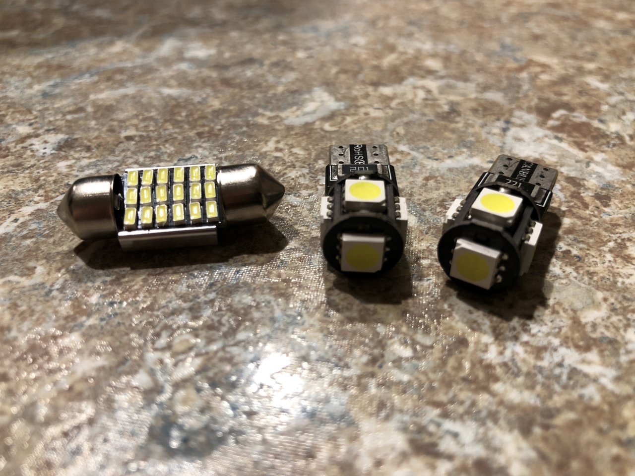

    I have an LED dome and 2 LED map from superbright LED. I pulled out of my 3rd gen to put the Me-So ultimate combo in. If the bulbs are the same I will send you them just pay shipping. They are awesome and very bright and colors match perfectly.

    Let me get them and take some pictures for you. Wait 1 sec. I’ll edit this post and add them here.
    UPDATE:

    I think those would work for a second gen. Anyone know?

    The maps are a 194 and the dome is a DE3022

    WOW! Great pictures detailing the benifits of adjusting the headlights & fogs while still keeping them "streetable" for other drivers. 2 thumbs up!! :thumbsup: :thumbsup:
    It's funny how I didn't think much of how low my headlights were when I had the dimmer OEM bulbs in there, but once I switched to the HID (and now the new Hikari LEDs), it was painfully obvious. I guess it's because the overally light throw is better, so we can see the beam pattern that much further.
    I'm still not sure if mine was abnormally low or if Toyota tends to play it safe and no one else really notices it with the stock bulbs...

    Thanks, I'm just trying to keep this a great thread.
    But you're right, even I didn't think they were "wrong", I just knew I wanted more. Like I said, I am very spoiled with my Lexus dual led projectors. I get flashed a lot with those but they are factory so tough.
    It became very obvious when I reviewed the photographs. You can see in the last two pics, the shots of the roadway, the Hot Spot was much closer to the truck. To me that is a waste, especially up near me. I need to see those deer as soon as possible. Now that the hot spot is farther up the road where it should be, yet still on the road, the roadway itself is more illuminated and the light patter is more evenly distributed.

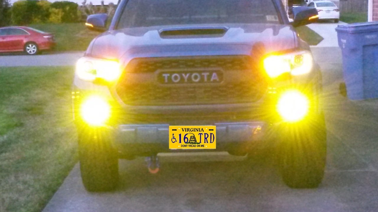

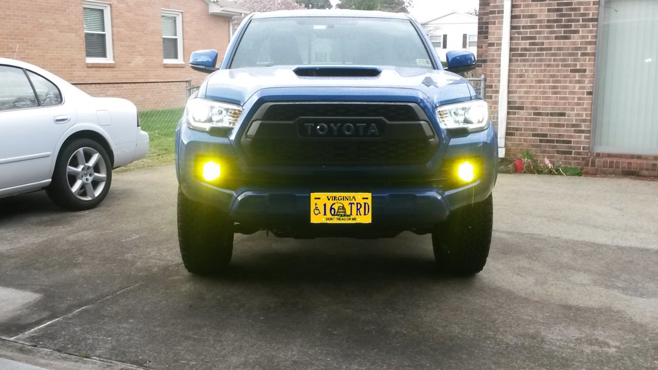

    Plates to match the yellow led theme (photoshop-plates ordered)
