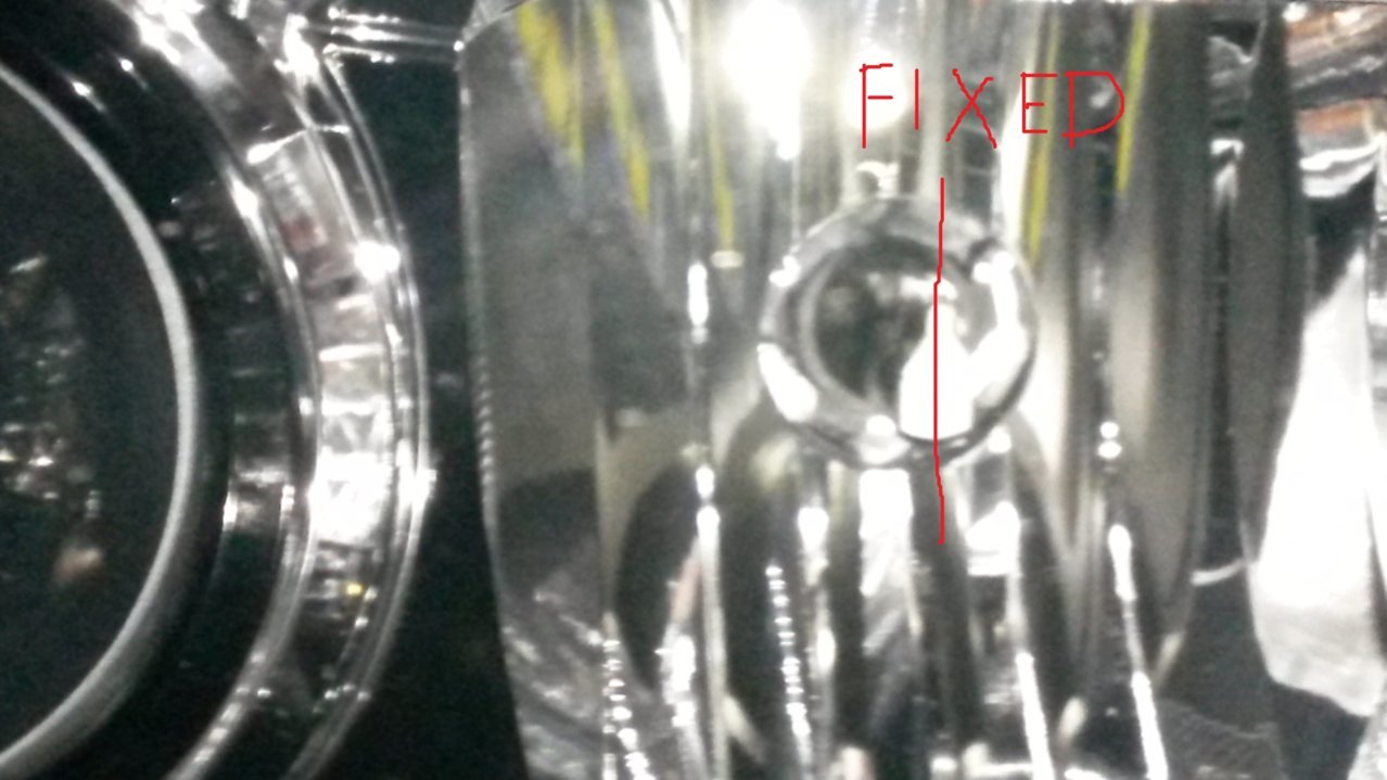

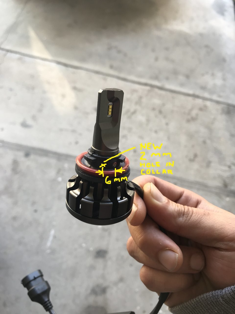

    Please forgive the new guy if already posted, but I have a Hikari LED question.
    I replaced the low beams on the projectors and loved them so much I decided to replace the highs. The driver-side bulb is aligned perfectly (vertically), but the passenger-side is toed-in clockwise about 35-40deg. The beam pattern is different enough that it bothers me. Anyone else have this issue?
  8. Apr 16, 2018 at 5:47 PM
    #2368
    mrproduxn
    mrproduxn Well-Known Member
    Feb 22, 2013
    #98175
    6,378
    steve
    Retired DoD SE VA
    Tacomas 1987,2000,2008, 2016,2012,2008
    Retired/Hobbyist old as f***
    Here is the fix. Remove the 2 little screws. Remove the plastic collar. Drill new holes as pictured. Install screws in new holes. Fixed.
    After fixed

    Thanks!!

    No problem. I think I was the first one to actually fix it. Most people didn't sweat it. The high beams apparently don't require to be exactly straight but I did it anyway. The driver is off slightly so I simply drilled new holes directly adjacent to the factory holes to fix that one. I only used 1 screw in each bulb. You can drill 2 holes but 1 is enough to lock it in place.

    Cannot remember where I got the picture before I marked it up for the bulb mod. Looking at it one would think the woman holding the bulb had a rough life.
