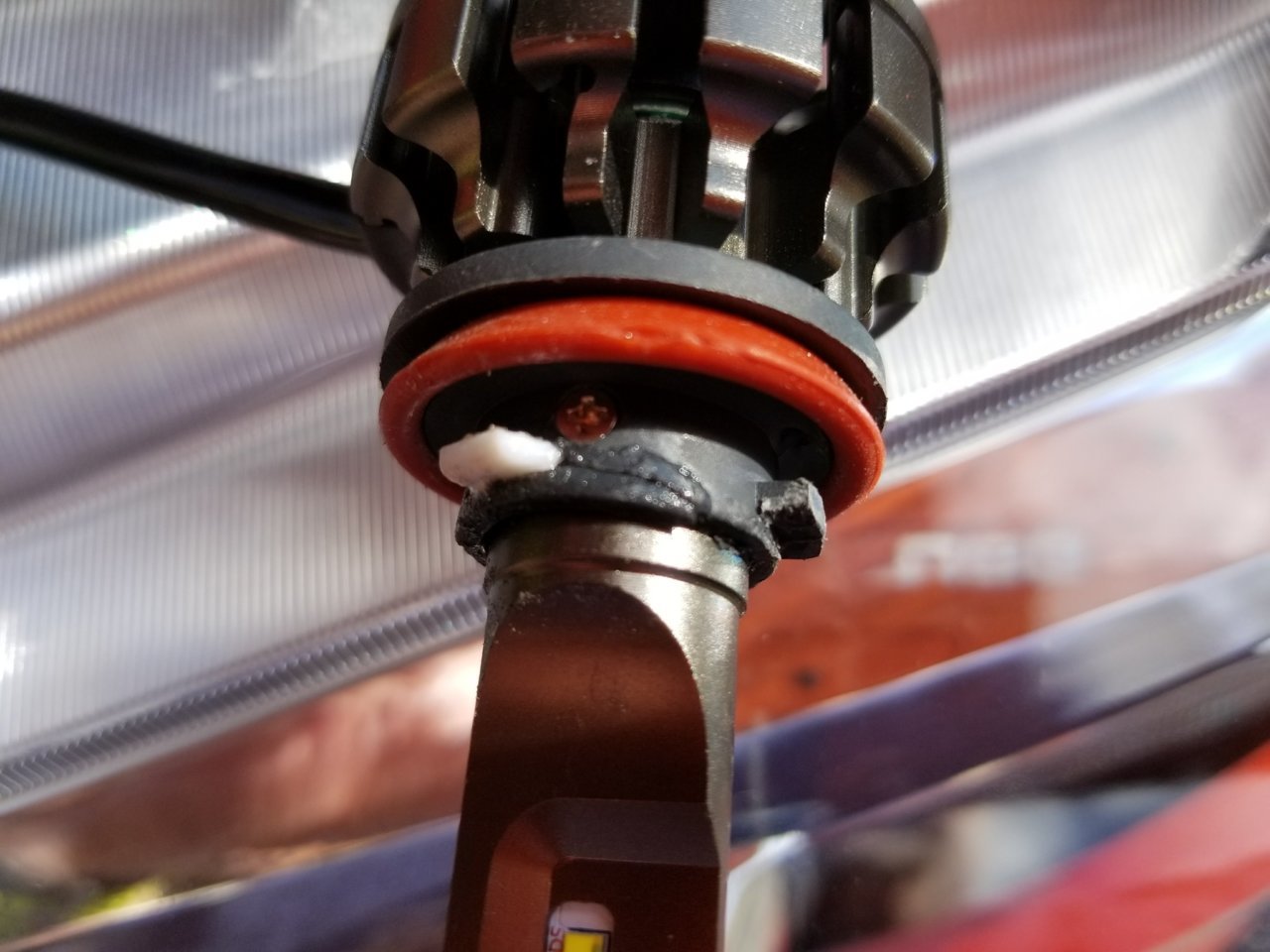

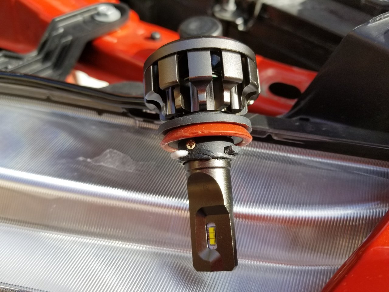

    I want to point out how soft the material of the collar is. The first set of bulbs I received were either damaged during shipping or was a result of me not installing them properly. Either way one of the smaller tabs broke off and part of the collar broke off as well.
    Here are some pics showing the fixed bu me bulb, before I had it replaced under warranty.
    So unless you're 100% confident you can pull this mod off I say let it pass. I got lucky with my return and I was super grateful for their understanding. I think however, breaking the collar trying to modify it might have a different outcome.
