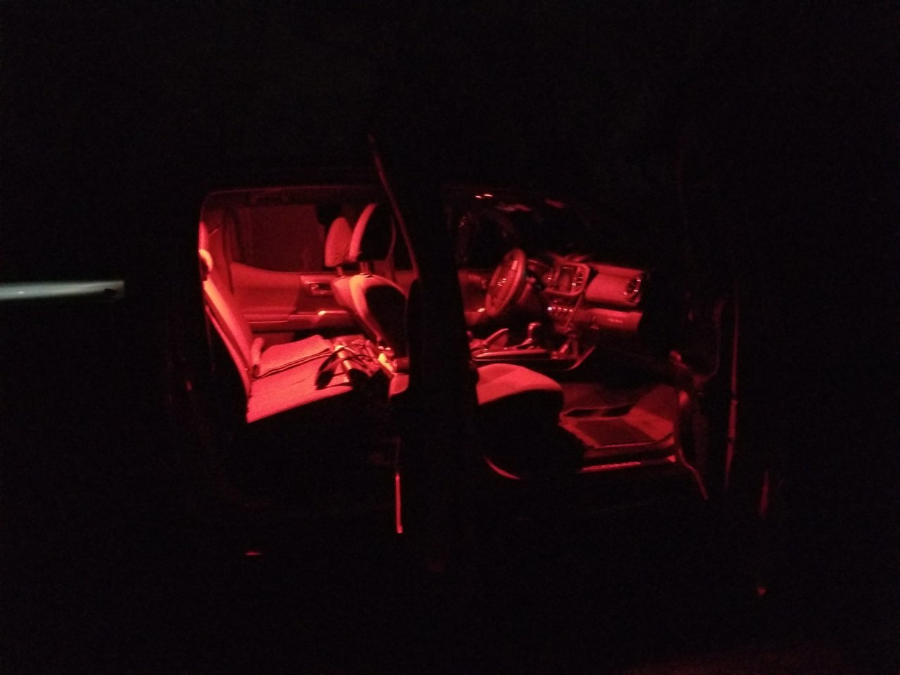

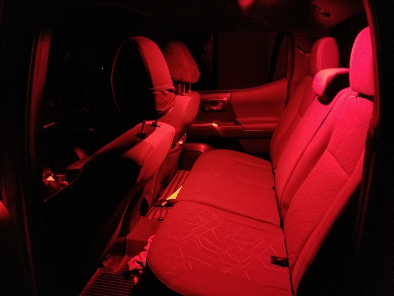

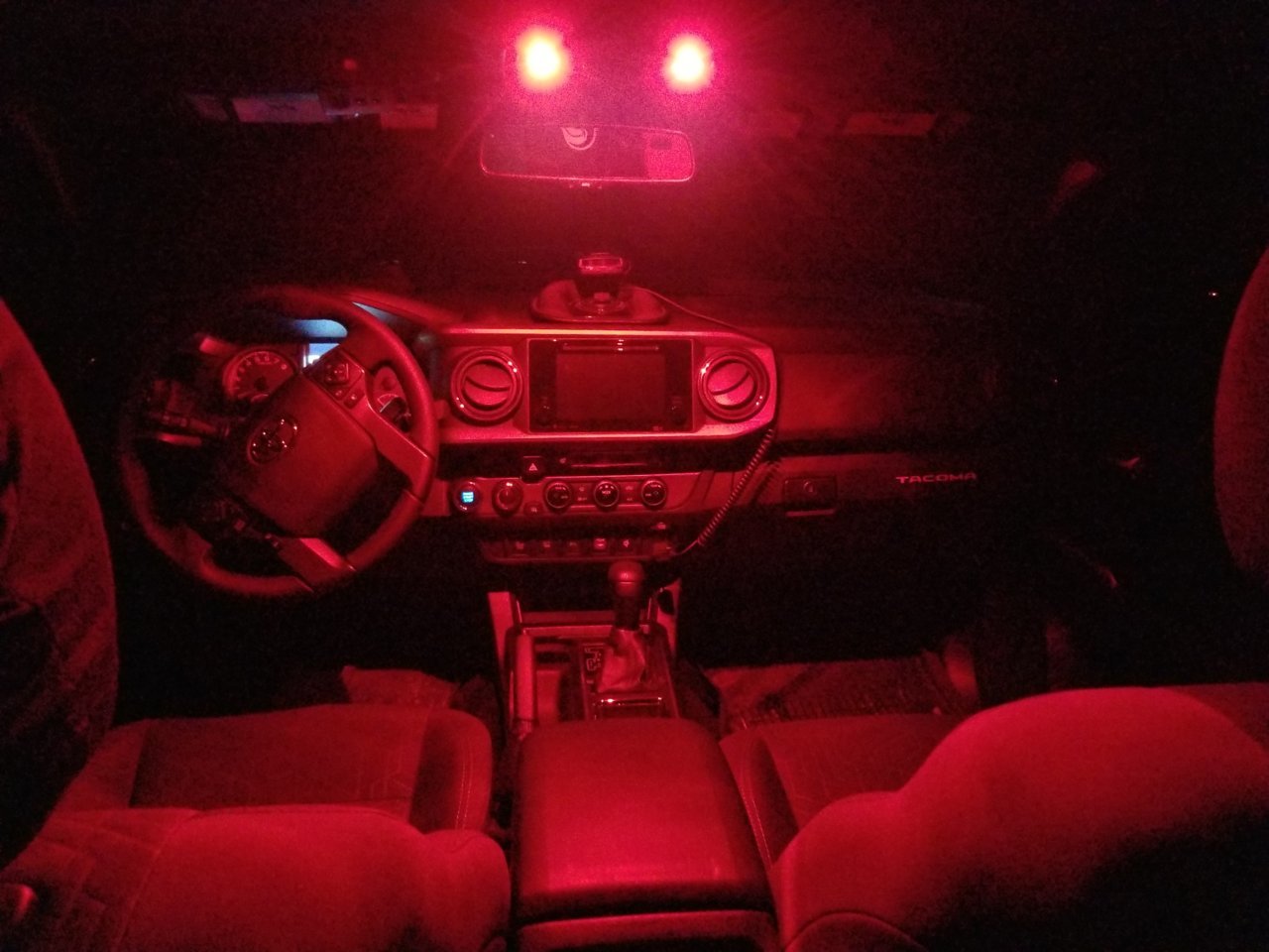

    This is what I recommend for the Map and Dome lights.
    https://www.tacomaworld.com/threads/custom-led-map-and-dome-lights.521923/
    The Red Ultimate Dome is available but the Maps are sold out at the time. Subscribe to that thread and get your paypal ready.
    You don't have to get red but if you wanted to know what it looked like

    That red is just too much, honestly.

    Yea, not for everyone. The Ultimate Dome comes in White or Red. White you need sunglasses. The maps come in White, Smoked or Red. A lot of guys run red up front and white in the back or smoked up front and white in the back.
    I am the Devil so Red is my color of choice.
