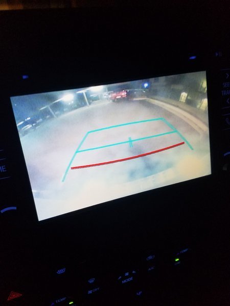

    Anyone else having this problem? The brightness seems to be interfering with my reverse cam. Not sure if I should try to order a less bright light.

    This may sound obvious...that is how my backup cam looks post snowfall from moisture and salt.
    Is lense permanently scratched?

    When it's wet, the occurs gets all fragmented like this too but that is expected.
    No, during daytime and night with the lights off it looks fine.

    Had this problem after I installed leds in the License plate lighting. I think due to the Camera facing down and the LEDS shining up at it, possibly causing the glare. I am going to test it out some more but may change them back to reg bulbs, idk yet.
