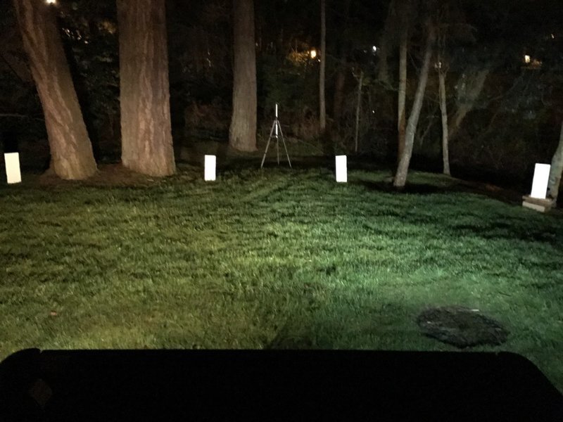

    Philips are decent, about 10% brighter than stock and project well at distance though the 100% rear facing reflector based optical design doesn’t do the greatest job illuminating immediately behind the truck, but if it were not for the backup camera you’d never know. If you’re buying a major name brand in lighting like Philips, you know it is going to be a decent product.
    Stock left vs Philips right
