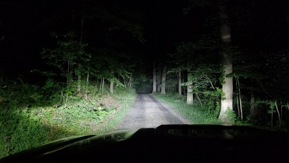

    Has anyone gotten side by side picture comparisons of light throw of stock vs hikari vs xenon? That would be great if someone does
    RobP62 likes this.
  19. Jun 6, 2018 at 10:28 AM
    #2939
    RobP62
    RobP62 NVR20LD
    Jun 4, 2017
    #220718
    41,519
    Rob
    Street, Md.
    TTC Member #0125
    Sorry, no stock but I have these:
    Here are the Hikari Philips.
    Here are the Xenon Depot Extreme Pro's:
    It's hard to judge because of the time of year and color differences of the trees, lack of foliage and full foliage but to me it looks like the Hikari may be a little more intense up close and the Xenon Depot make the end of this pitch black lane a little more illuminated. So from a "throw" standpoint the winner is the Xenon Depot kit.
    To me it just looks like more light in the more of the right places and I am going to have to attribute that to the fact that I have the diodes on both sets of bulbs (low/high) adjusted so they are at 3 o'clock & 9 o'clock.
