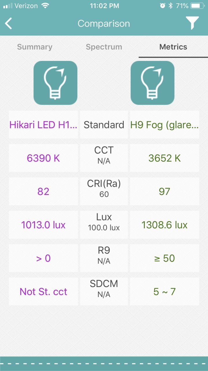

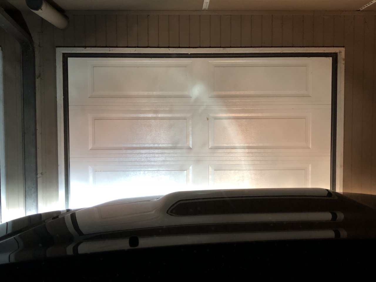

    I had a spare few minutes today, finally. I tested the Hikaris against a basic H9 (glare capped) in the fogs with the headlights disabled:
    LED left fog, H9 halogen right fog
    Like I have mentioned countless times in this thread, the LEDs lose the cut off and cause glare. There is a glare ring around the LEDs, the picture does not do justice to the extent. Looking at this picture it should be clear that drop in LEDs do not belong in the fogs. At this distance the hood should obstruct the fog cut off, but the LEDs bleed over beyond the cut off.
    But surely that means the LEDs are brighter?
    Not against an H9.
    Using a Asensetek Lighting Navigator meter (same brand as Toyota) an H9 is 30% brighter than the Hikari LEDs. A distributed beam pattern like a fog is going to be kinder to the LED output readings than a headlight that concentrates the beam into a hotspot, meaning the H9s should further outperform the Hikaris in a headlight assembly comparison. I'll test that later as time allows. The Hikaris do rate brighter than a stock H11 bulb in the fogs, but distributed light (fogs) vs focused light (headlights) is very different.
    A standard H9 is ~$20/pair vs the $70+ for the Hikari LEDs. I run special glare capped H9s to simulate an H11 from Daniel Stern, which reduces glare for use in a reflector housing.
    Edit: Dont be mislead by a phone screen shot for the caliber of equipment. This is not a 'free app from the app store'. This is Pro grade equipment and the module to export this data costs an additional $800.00 alone, on top of nearly the same price for intorductory test instruments. Screen shots are my way of saving $800 for the export upgrade while still being able to share the data.

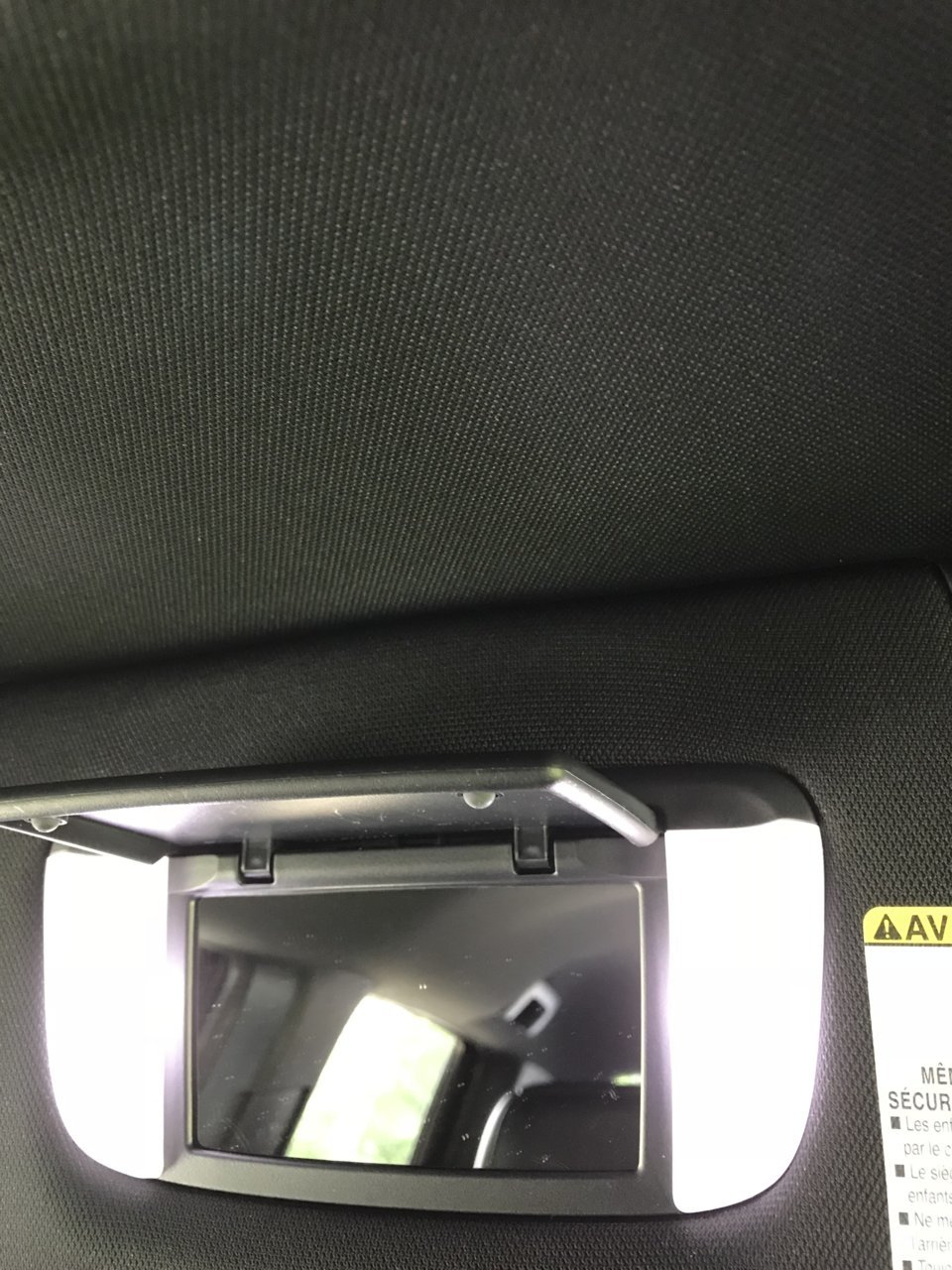

    Not that they get much use but they are led's now!

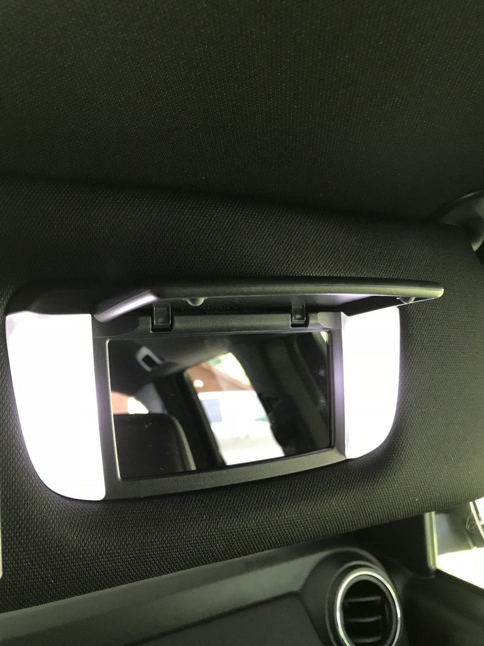

    For interior I bought this kit for my father in laws and my taco, takes the guess work out of how many of whstvtype I needed, it’s a full kit and comes with license plate, vanity, etc:
    http://www.ledpartsnow.com/16uptacoma/

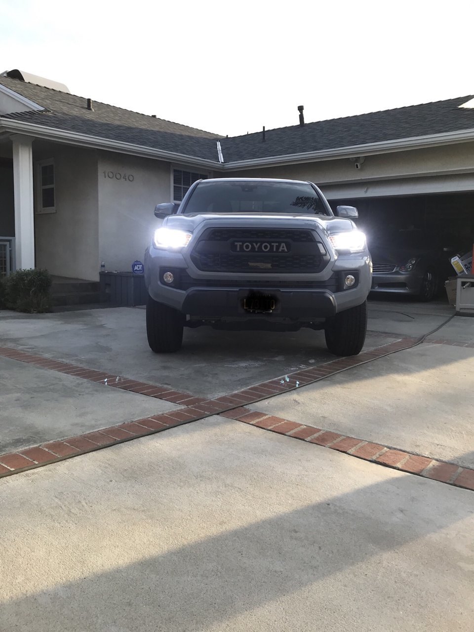

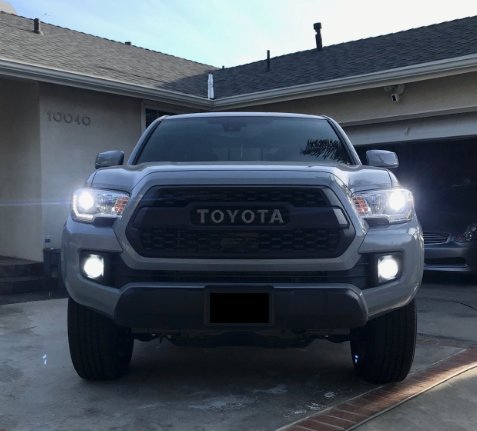

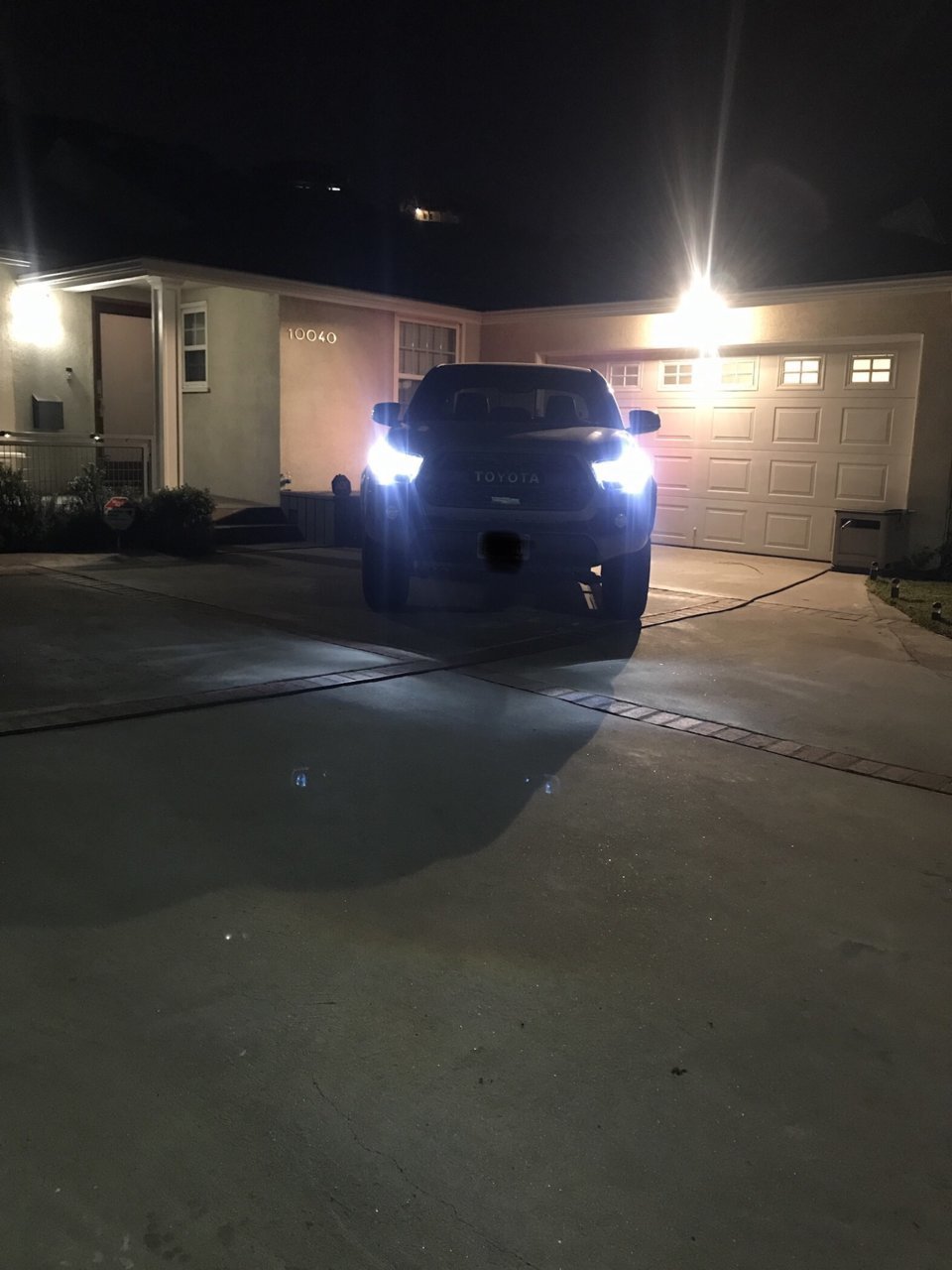

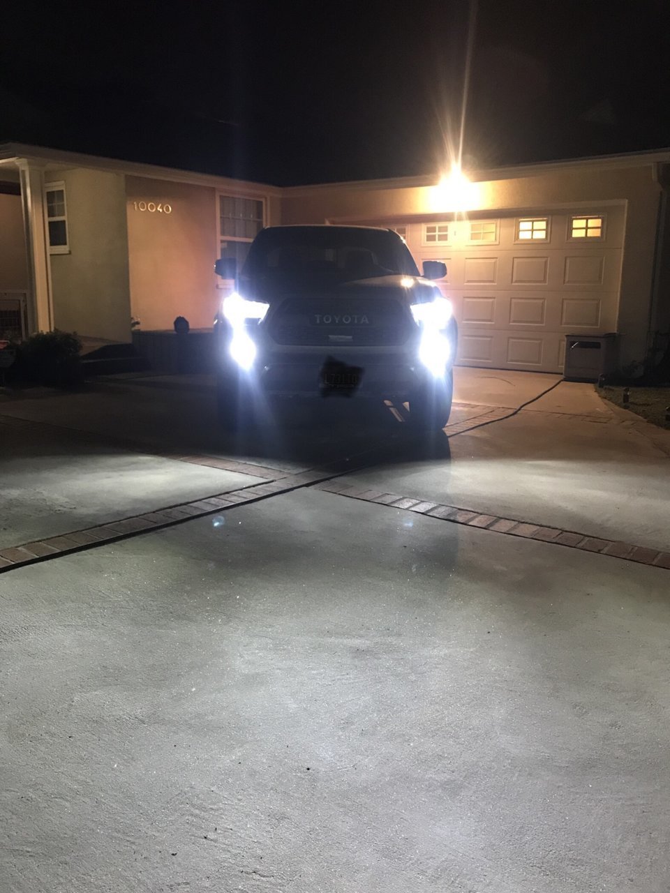

    Here are some pictures of that exact setup on my ride for color temp reference if you were worried about color mismatch, don’t. B31AB6D0-FEB5-4AFA-9271-219B2955142F.jpg34B3EE01-2DDA-4A14-8ED1-B3900063642D.jpgFA57FE83-C396-47BD-BE87-BC8162C8C022.jpg26D5A670-FAFE-4F28-BF8E-60562BAE0BAF.jpg

    Thanks. This set up looks nice. I'm gonna get that grill installed as well. $330 installed.
