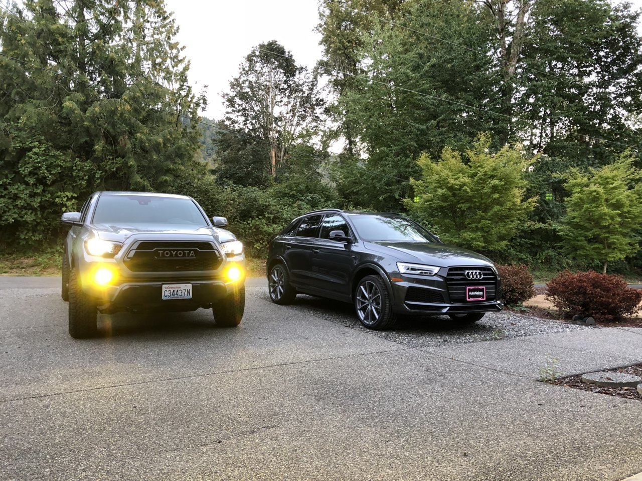

    For those of you that went with the lasfit led's were you ablkek to find yellow ones for the fog lights?

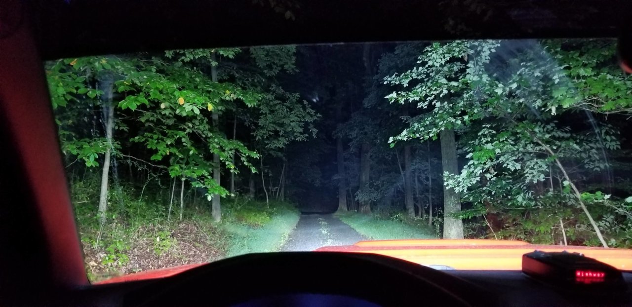

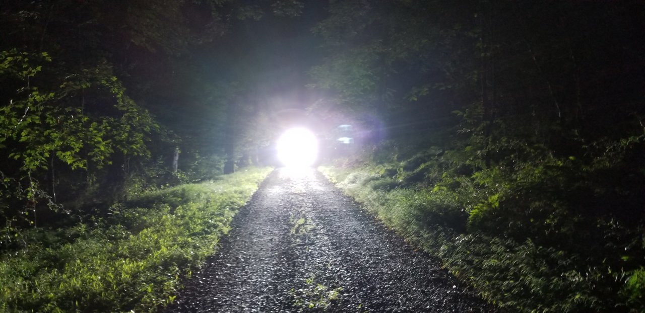

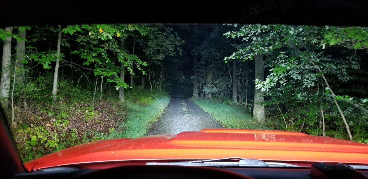

    WOW, is that a light bar blinding all of those forest animals?

    You should get the glare guard sheild on that light bar, having the hood lit up like summer afternoon constricts your pupils due to the intense foreground light and kills distance vision. When you turn the light bar off you will find you can actually see less than before you turned it on because your pupils are over-constricted for the darkness. Ideally you want no light reflecting off the hood.

    Here is the view I see (I'm short). Those others I just held the camera closer to the dash. But yea, you can see the glow on the A pillar. I will have to look up the glare shield and see how that attaches. It's a process. Thanks! :thumbsup:
    Plus I would hope the only time I would need these light bars is if I was wheeling at night somewhere alone or at least on point. No way could I be on a trail following someone. However, If I was wheeling at night I would probably be sitting forward in the seat. I will check it out!
