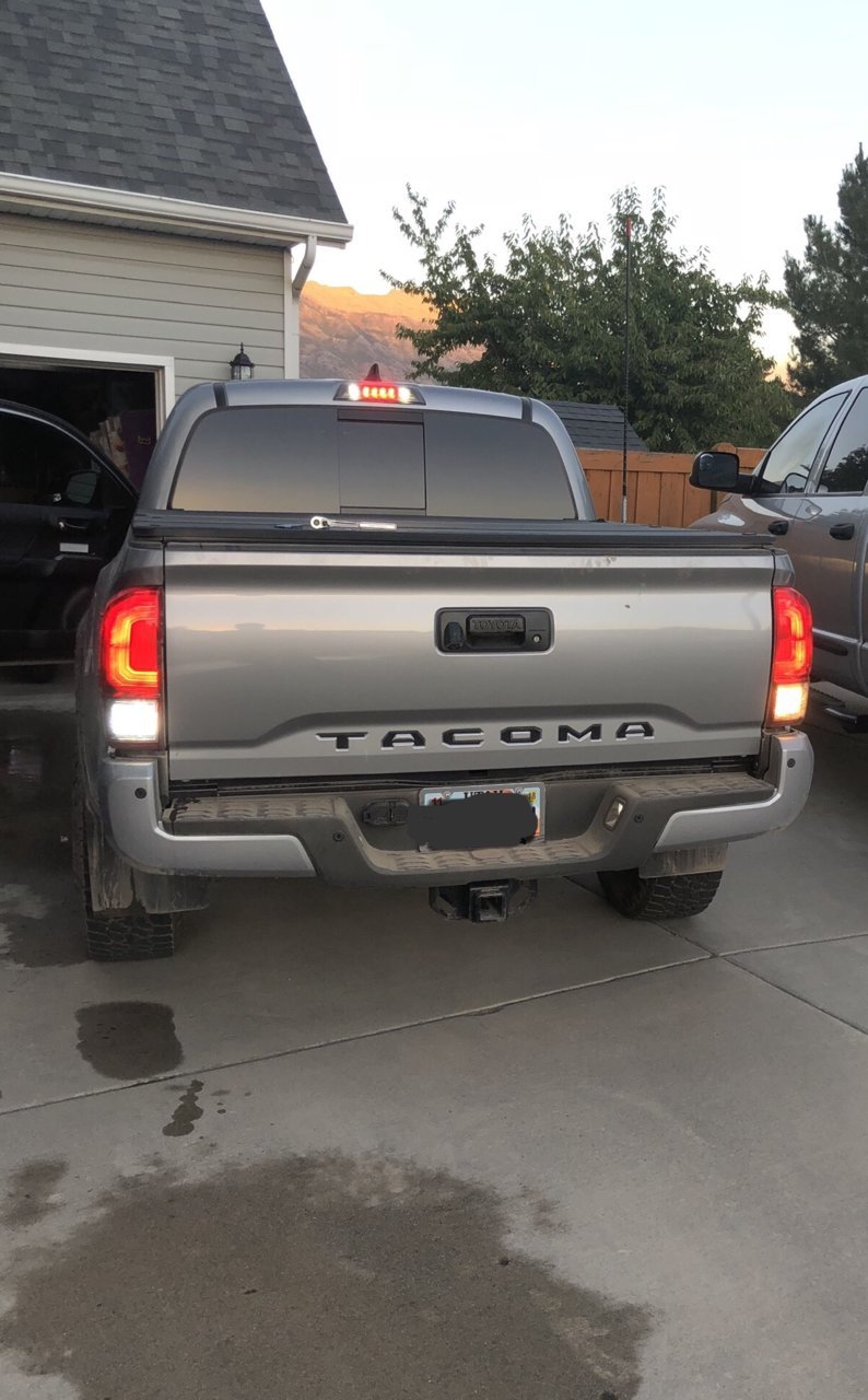

    Just got some Hikari reverse lights! Waiting for darkness to fall so I can test em out.

  12. Sep 13, 2018 at 6:44 PM

    Only one I got for now. Really liking the looks of the LED in person compared to stock. I saw these lights on Amazon for like $7 bucks and said what the hell, let’s try em!
