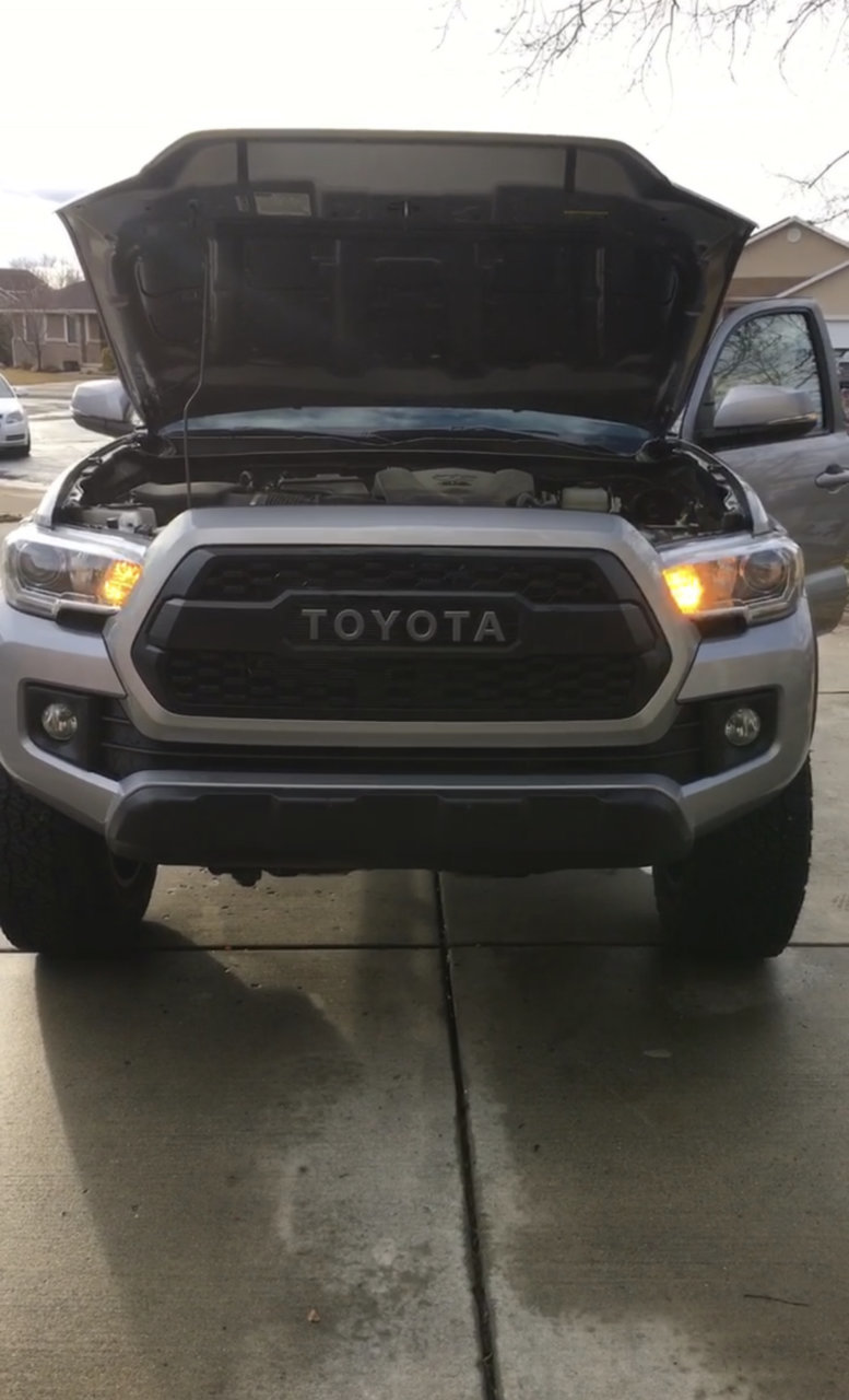

    Does this LED kit get warm enough to keep the headlights ice/snow free? This is my main concern with winter coming up..I plan on doing a lot of driving this winter and don't want to have frozen over headlights every storm.
    RobP62 likes this.

    No. All the heat from an LED is on the driver outside of the headlight assembly.
    You can swap in an H9 for a good bump in output and retain the halogen IR output to melt snow. Output bumps from ~1250 lumens to 2100 lumens.

    HIDs get warm enough though, right?

    Yes, both LED and HID will heat up enough that it won't cause the headlights to stay frozen. We're based in Canada so we do experience the cold winter months as well and with the HID or LED installed in our own vehicles we've never had an issue.

    I have not had the opportunity to test them in a heavy snow but there was sufficient heat for a light snow. I don't think any LED kit will provide enough heat for a substantial snow event.
    With that said, I've had the headlights get covered with halogen bulbs in major snow events.
    I've actually given some thought to this myself. Especially since my commute is 44 miles one way, and a major portion is on the highway. So it's not like I can just pull over at will to clear them. But my thoughts are, if I wanted to I could tap into the washer fluid line with a T fitting and run a line back to the headlights and add nozzles to some part of the area around them. Maybe just a temporary fix, or maybe something cleaner looking so it could be permanent.
    With the higher than average rainfall we've seen here in the mid east I have a feeling this winter will be a doozie so I'm waiting to see what transpires either way.

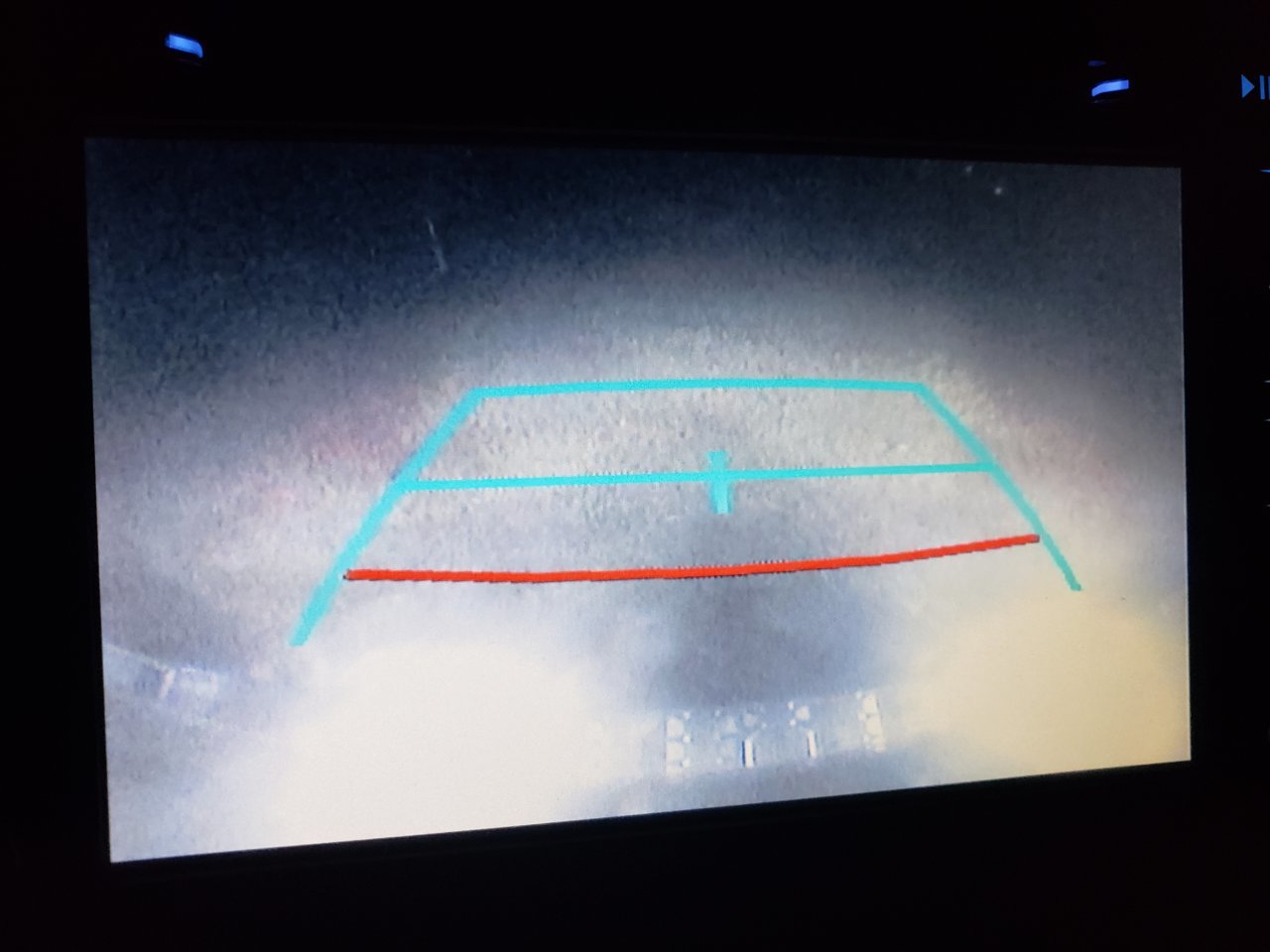

    Are the leds for the plate lights that robP posted earlier the best option. I had bought some with a single led and a somewhat white dome but man do they get the glare on the camera
