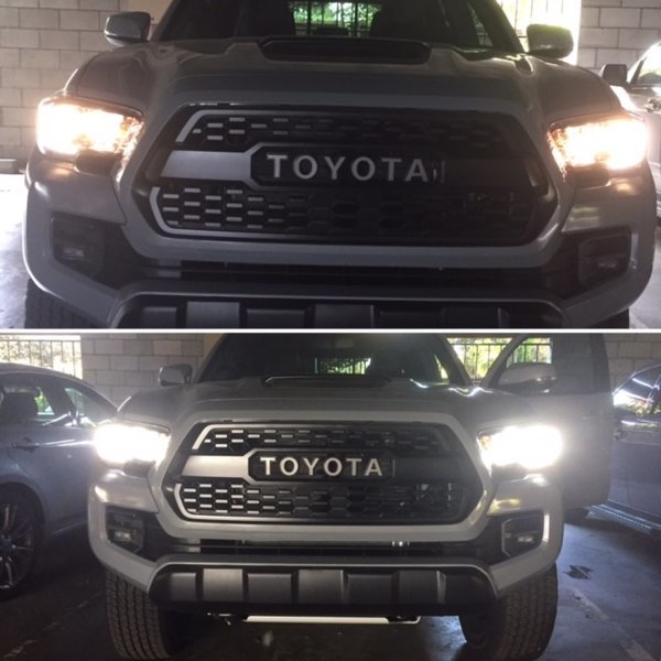

    Installed my new OPT7 FLUXBEAM X yesterday love these new lights. extremely easy install, no fitment issues, very happy with the product. I live in the suburbs and these lights have plenty of throw and good cutoff, they are brighter than the OEM halogens but don't expect them to be anything like HID's. they match the DRL'S perfect as well. No complaints and i highly recommend over the Morimoto due to the morimoto fitment issues.
    OPT7 on the left OEM halogen on the right.
