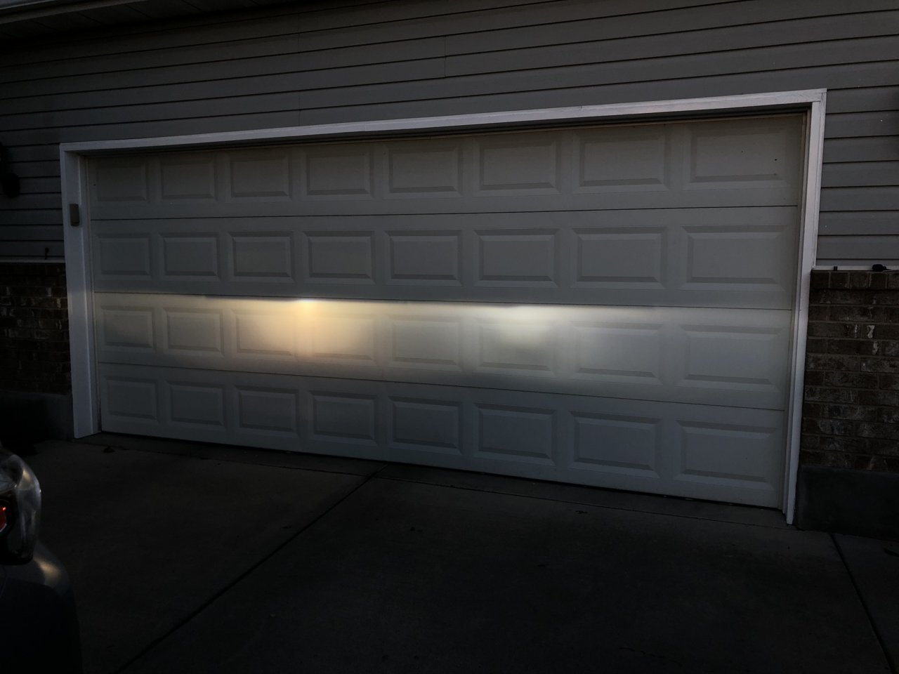

    I threw in the xd extreme LED pro. Install was easy. Mine lined right up first time, no adjusting. I really like the color of the light, it makes street signs pop. Cutoff is narrower, so there's that. I also think the throw is a tad shorter, but I didn't think it's sacrificing too much. The light right in front of you is much brighter, I do like that.
    I taped on the garage where the old lights were to make sure the height didn't change, it stayed the same fortunately. On the heat sinks, mine didn't have holes in them, it seems like others I've seen did, curious how hot they actually get. Also, do I have to worry about those possibly melting the washer fluid container? It's about 1/2 inch away. I'd hate to have to replace that. I looked around for a decent spot to zip tie, but didn't see anything that would be better than tucking away like I did, wondering if that'll cause issues? Thanks for everyone's help.

    The more light right in front of you is caused by shifting the beam pattern toward the vehicle, (as you noticed) which aside from reducing distance projection also reduces your night vision. This is an inherant problem in all LED drop in retrofits.
    Having the LEDs at 3 and 9 o’clock (no adjusting) will give best results.
    Yours did not have holes because you received the brand new higher output model, which is about 10% brighter than the previous model with holes.

    Lots of people on here more knowledgeable than me, but I'm thinking they're aimed a little too high. When I installed my xenon depot's, I turned on my lights first and put up tape to see where they where aimed, then checked after to make sure they were still good. I assume you can throw the stock bulb's back in, then do this process over. I believe there is a specific distance from the wall which I didn't do, but figured this would be close enough. I have not been flashed, but it's only been 2 hours of driving so far. I will say, I didn't have to adjust mine whatsoever, they were correct right after tossing them in.

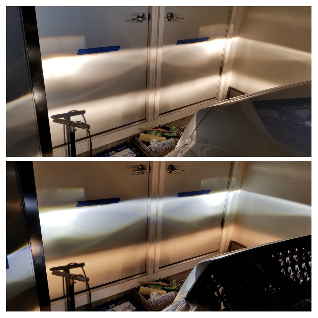

  20. Oct 13, 2018 at 5:50 PM
    #3540
    crashnburn80
    crashnburn80 Vehicle Design Engineer
    Jun 6, 2015
    #156893
    14,771
    Kirkland, WA
    2003 DCSB TRD OR
    XD Philips HID left, XD LED right
