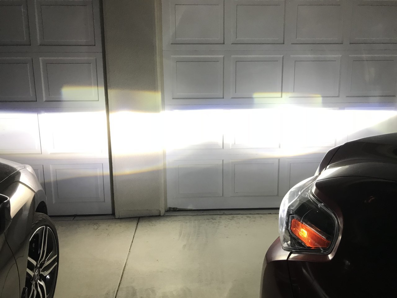

    HID looks brighter

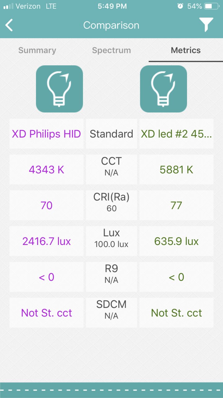

    See the measured output under the lux reading, it is far brighter.

    Do the Lumiled Hikaris put out more light compared to the XD?

    Yes. Though they use active cooling with fans which allow for higher output. Personally not a big fan of microprocessor fans in the engine bay to cool lights when passive cooling technologies are available.

    Looks wise I'll take the one on the right.

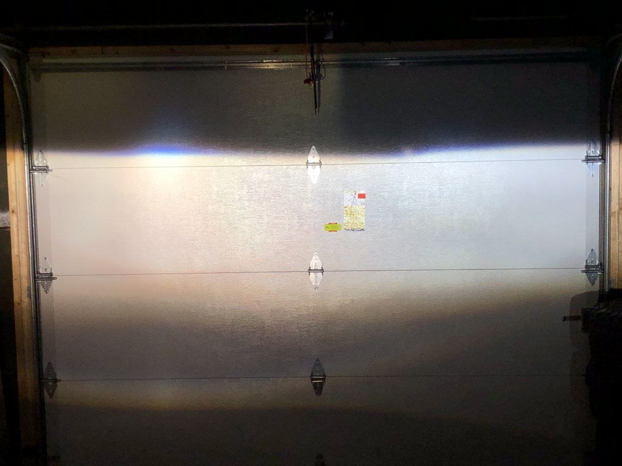

    If your dead set on LED, then yes the Xenon Depot is by far the best out on the market at this time for use in the projector housing of the 3rd gen Tacoma.
    Sorry, correction to the above ^. Hikari Phillips Lumiled is still the best on the market as of the moment and XenonDepot is second best. @RobP62 has some good info on the XD's though.
    I have some LED product from deAutoLED that are more designed for the reflector housing such as fog lights and high beams. I'm currently testing those and they surprisingly, have great performance and light output just seeing them from the initial look. I haven't tested extensively enough yet to talk more about it though.
    If you're not against HID and that's still on the table. I'd tell you to consider it. I've been running LED for a year now which I've been more than happy with. I've been testing product for deAutoLED for the last week (pic, review, and video coming). I put in two sets of their HID's and I was blown away. The are crazy bright, very clean with an even spread of light and the throw is amazing.
    I think you should consider HID, but the LED XenonDepot and Hikari you wont be disappointed in. I can say that with confidence.

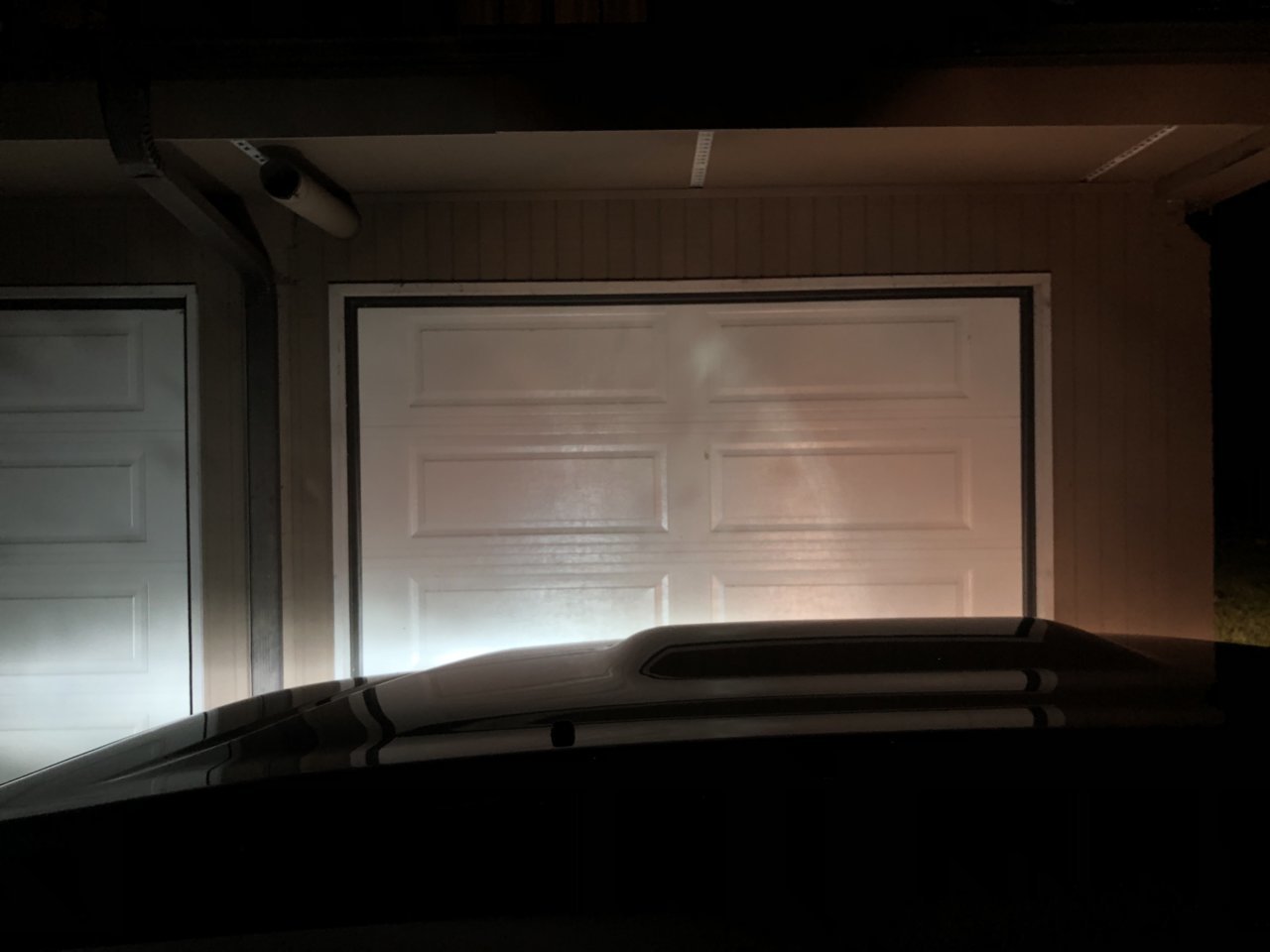

    Just a little sneak peak of the deAutoLED HID kit 5500k compared to the Hikari Phillips. I will be sharing a full video review in the coming weeks comparing some other lighting products from deAutoLED as well as more on the pics below.
    Hikari on right deAutoLED on left
    You can clearly see in the pics that you get the full effect of the projector housing with the HID's and the light intensity is much greater. I was a die hard LED fan untill I saw this for myself. deAutoLED has some very impressive lighting products.

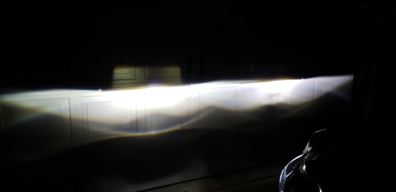

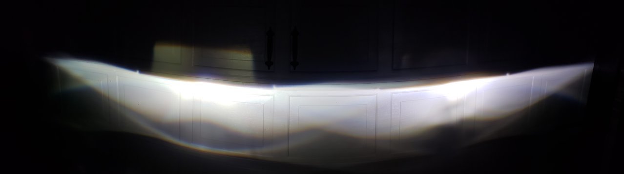

    Not true. The Hikari Philips LEDs do better in the projector than Xenon Depot and deAutoLED. The Hikaris are brighter (they have active cooling) and their LED cross section is smaller making the beam better focused so you do not lose your hot spot concentration to the same extent as you do with other LED products, meaning they have better distance projection. People always comment about 'loss of throw' with LEDs. The Hikaris do the best job about reducing loss of throw. Now I'm not saying the Hikaris are a quality product, because I think they are a cheap one. But in basic design, theirs works best.
    Edit: deAutoLED says these specific LEDs are not intended for a projector.
    No drop in LED product is correctly designed for a forward facing reflector housing. Many companies make this claim just like deAutoLED. I think it would help to understand how this works. If you move the filament off center as you do with LEDs you change the geometry and it causes glare and loss of distance projection. The best thing you can do is make the LED cross section smaller, and the Hikaris are much smaller than DeAutoLED. Hikaris are 2.2mm across on the LEDs vs deAutoLED is 3.8. Might not seem like much but the halogen filament is much smaller than either of those, and to make lighting optics improve in a halogen light assembly, you shrink the light source further. Performance halogens use smaller tighter wound coils than standard halogens, because making the light source smaller drives better focus and distance projection. World leading lighting companies like Philips and Osram focus on shrinking their filaments even smaller to achieve better focus and more intense hot spots and can extend distance projection 2.5x with a stock wattage halogen bulb. If shrinking a filament fractions of a millimeter smaller makes a 2.5x increase in distance projection, adding millimeters to the cross section does the exact opposite. This is the root of why LEDs "lack throw". That and non-uniform lighting of the housing, but smaller cross section does better there too. So if you are looking for best performance to address the lack of throw issue, you want the smallest cross section possible and so far that is the Hikaris.
    Fog reflectors
    DeAutoLED left vs H9 halogen right (halogen is 2x brighter than stock with no glare)
    You can see that the "LEDs designed for reflectors" still have glare. You'll note deAutoLED makes the same claim for putting HIDs in reflectors as well, which is well documented to cause glare.
    If you want to put LEDs in the fogs, you need to replace the entire housing with is one that is designed for an LED light source.
    HIDs are drastically superior in output, no comparison. Being a bulb their light source is in the same location as the halogen filament producing a better hotspot for better distance projection than LEDs. The light source however is not the same as a halogen filament so there is still a compromise being made in focus compared to the halogens the housings were designed for.
    DeAutoLED does a good job in testing their products in all the vehicles to ensure they work without errors or resisters before advertising compatibility. Note though that overly bright tail lights are not your friend. In another lighting thread someone posted pictures of someone that had done this in an Audi. The tail lights were so bright they were hard to look at following the vehicle, basically blinding the person behind you. And when they braked it was even worse. Not exactly a good idea to blind the person following you.
    No, the tacoma does not use pulse width modulation, so you don't need the module to correct for it.

    So I put in the XD LED's last week. As the time has gone on, I'm very happy with them. I realize they are probably not projecting as far down the road as the halogens were, but where they shine is when the roads are wet. I was very unhappy with the stock halogens in the rain. I actually hopped out of my truck one time to see if the stock headlights were on, thats when I decided I needed to do something about it. Using the LED's in the same conditions I noticed they actually light up the road, huge improvement.
    The other thing I notice is how far down the road the street signs pop. I don't know if it's just the signs they use where I live, or if they are everywhere.. You literally can't miss a sign, it's like they are lit up. On the halogens, they are very difficult to see for me.

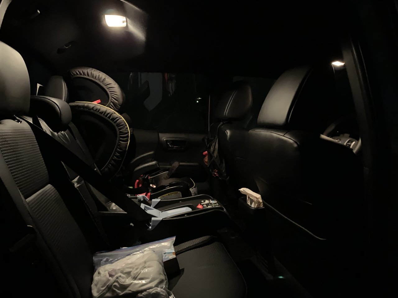

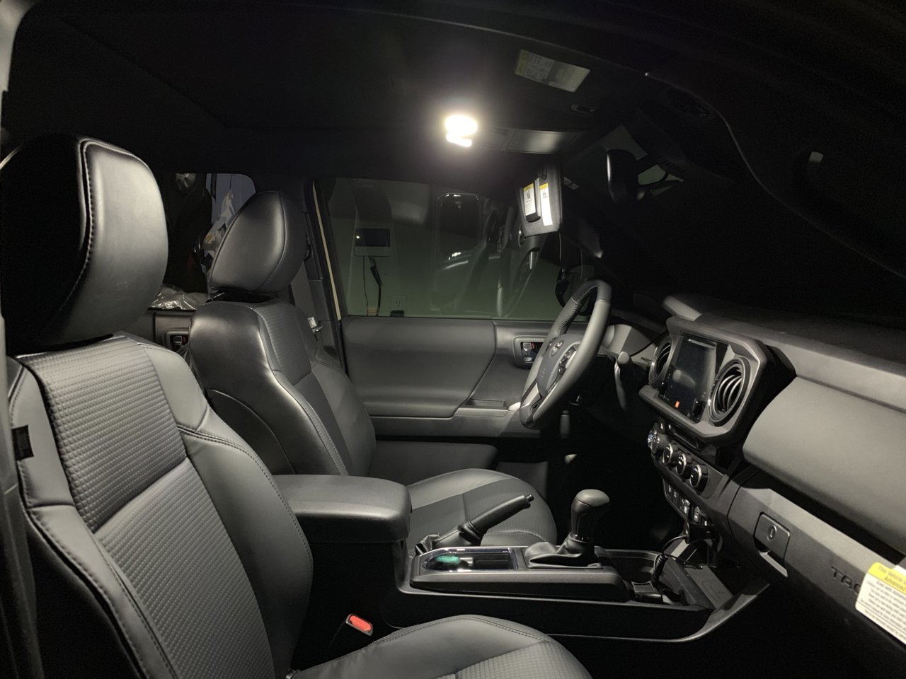

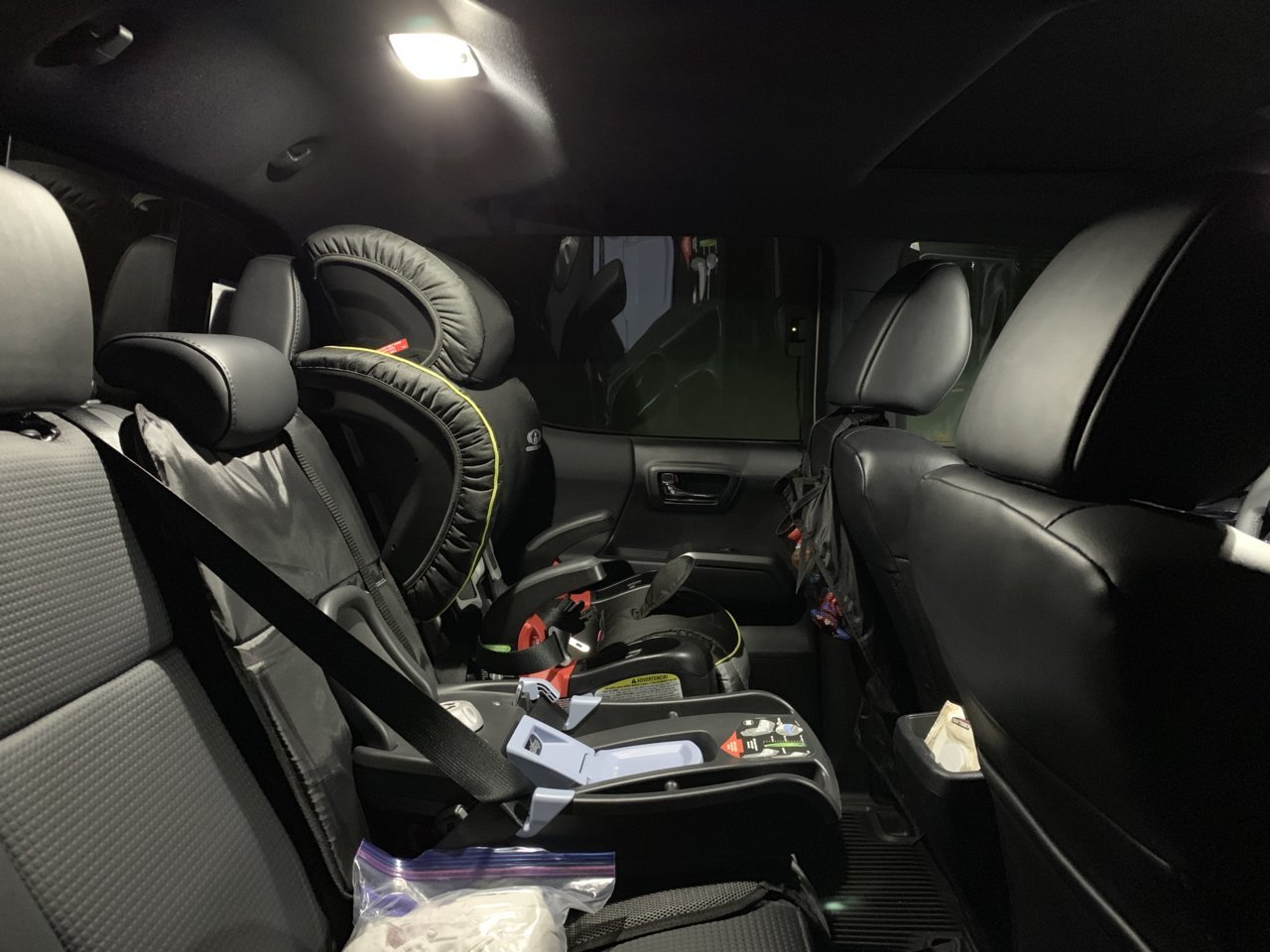

    Hi!
    I just installed the complete interior lighting kit I bought from you guys. I’m very satisfied with the light output. See photos below.
    Only issue I am having is there is a slight buzz from the LEDs for a few seconds whenever they turn on or off. Is that normal?
    Thanks for your response.

    Remove the screws and tilt it towards the rear of the truck a bit. You don't have to remove it completely.
