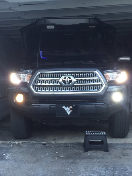

    NorthRiverFarm Member
    Mar 31, 2017
    #214964
    17
    2017 TRD OR DCSB
    Thanks OP for the info. Just ordered the fog lights for now they look a lot better than OEM.Need to get it out of the garage an on a dark road to really see the difference. This pic is for comparison OEM left LED right. Don't mind the mrs. polka dot stepping stool.
    SilverII and obz like this.
