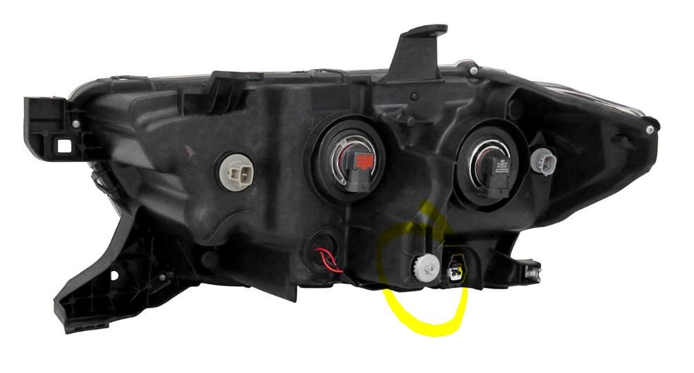

    I just purchased the xennon depot hid kit and love it! However I need to adjust the lights. I know I can go up and down but can we adjust left and right also? If so where is that adjustment located on each light? Most importantly what should the lights be set at height? And left right if needed? Should the passenger light be higher than the driver side so I don’t blind people. Thanks for any help!

    No Horizontal adjustment, only vertical. There is a silver adjustment screw on the back of the housing that has what look like "teeth". Turning clockwise looking at it from the back or counter clock if you're standing in front of the light looking down will adjust them upward. Adjust both to the same height and make sure the truck is on a level surface. Id recommends a clean flat wall and some tape for reference to the current height.

    Very helpful thank you! My only problem is I didn’t measure it originally and I started to play with the heights.

    Honestly, that's not to big of an issue. Just adjust them little by little and again keep them both lined up at the same height. Go drive and if needed adjust a little more. Do that till you feel they look right. If you start getting flashed, adjust them back down slightly. A little adjustment can make a big difference. They move millimeters at a time. So close range may not seem like much but the long distance it could be a few inches.
