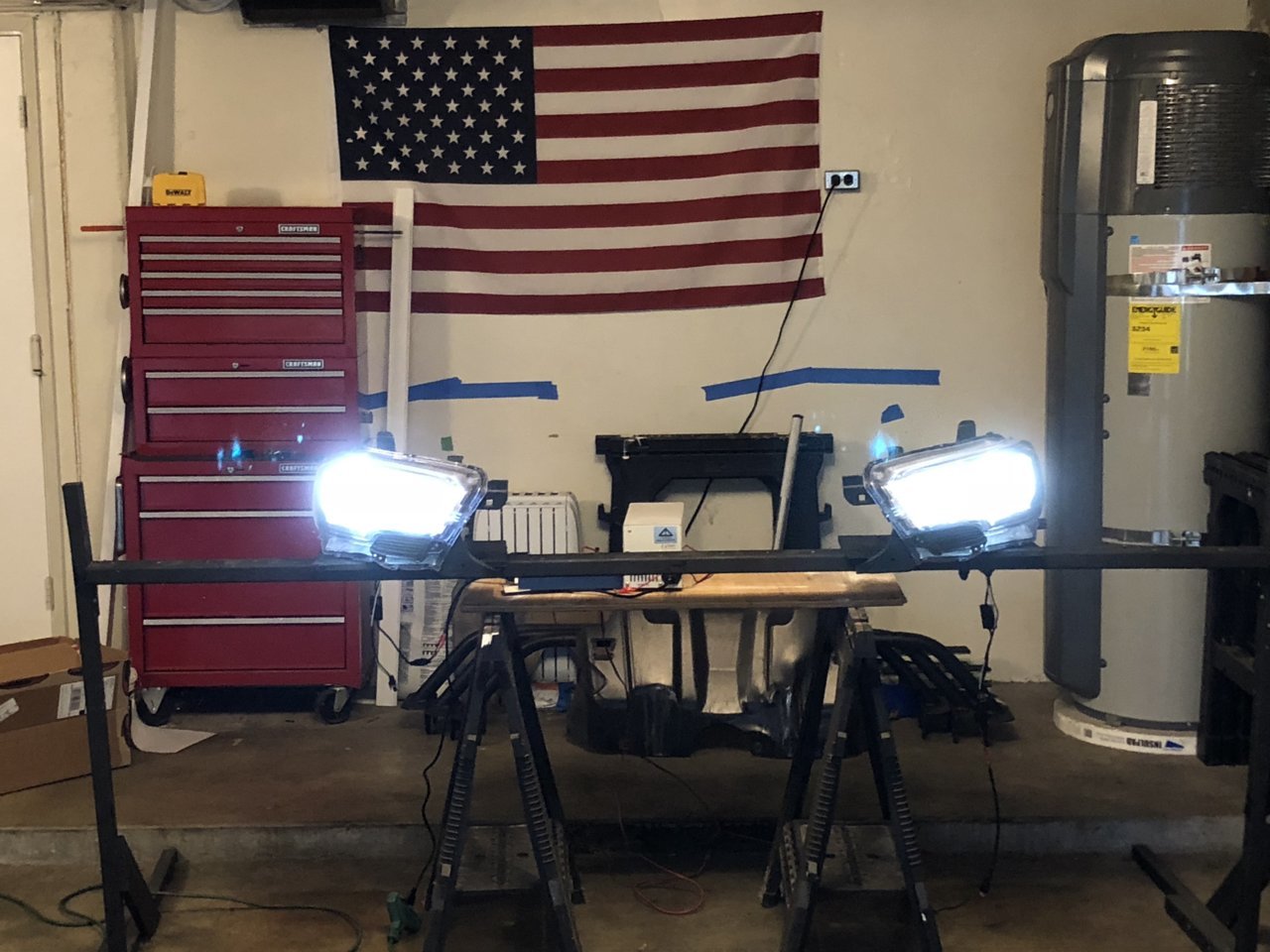

    I am not trying to discredit anyone or any company. I present measured data. I have zero invested interest in any product/company and just let the data do the talking. It is a funny leap how saying that a 3rd party product (which isn't supplied for free by a vendor to members in this thread) has scientifically better measured performance is somehow snowballed into 'discrediting a company' or that I am attacking people's integrity, or I am calling them liars or that I have some agenda or am deliberately trying to confuse people. And I get messages telling me to censor my posts or delete a comparative review. Where has the unbiased objectivity gone?
    For full transparency:

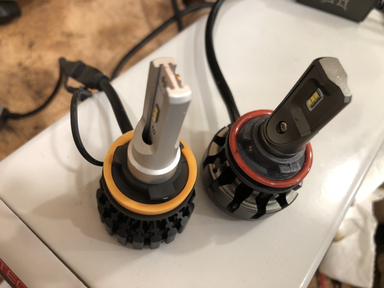

    DeAutoLED really wanted me to do a review of their LED headlight like I did with their reverse lights here. I deliberately try not to review products that I don't think will work well as it is a waste of everyones time and I turn down the majority of these review requests. With an understanding of lighting design, you can usually have a pretty good idea looking at the physical product if it is a good design to perform well or not. Unfortunately they do not provide any images of their products and just claim theirs are better. As I had tried the reverse LEDs and they were the best output of the reverse LEDs I tested, so I finally agreed to take a look at their product. What I received was a well built but otherwise somewhat standard design of the opposing chips on a rod style H11 LED with a cooling fan.
    DeAutoLED left vs Hikari right
    Cross section of the LEDs, DeAutoLED was 3.8mm vs Hikari at 2.2mm.
    Since LEDs in reflector housings is a well documented bad practice that blinds other drivers, I didn't want to test them in my 2015 fogs because it would look bad. But I also didn't have a 3rd Gen with H11 headlights, and borrowing a truck after dark in the late summer to spend dedicated time with was proving challenging. So I invested my own time/money/effort and built a 3rd gen front end to scale using OEM 3rd Gen headlights. The mock up of a quality power supply, OEM headlights and home depot parts was nearly $500.
    After testing them in the headlights and showing with objective scientific data they were outperformed by Hikari, I was told these bulbs were no longer for the headlights. I was then told in early October that the bulb I had was now for the Tacoma fog, and other people they had been running them in their Tacoma fog lights and they did really well. I explained how this doesn't work and that there will be glare. You cannot move a light source off center with an LED in a reflector housing and not have glare, it is basic physics, their LED is far too wide for the geometry to work. They insisted, so a week later I tried them as specifically instructed in my 2015 fogs and predictably there was glare, and I shared a photo. I received a PM demanding I take my post down and an email telling me not to share info like this as it is bad for their reputation. Then the posted claim was that I now have the wrong bulb and I am not using it in the housing it was designed for, when just a week prior I was told specifically this is the bulb they use in Tacomas fogs. Sound confusing?
    I ignore demands to censor my posts because it doesn't favor a vendors product. I'm not here to promote and help sell products, I am fiercely independent, I objectively and scientifically test products to provide unbiased information to inform consumers. My data is a little over a month old, they say they replaced the bulb with something else the instant I posted something countering the recommended use from the week prior. Spiraling sharing of data that is a little over a month old into me being confused, or intentionally confusing people, or saying I post irrelevant info when they provided a repeatedly moving target, or that I am trying to discredit them is an interesting take on the events. These are the exact reasons I do not like to be involved in any of these types of non-objective threads. The environment to product critique/criticism is toxic as it has evolved into advertising. And all of these above reasons are why I mention that this thread was better when the members did their own independent research and purchased lights themselves and reported products objectively on their own.
    The bulb I have is a generation behind whatever that newest version you have specifically for the headlights, and I am sure the new one is brighter. But brighter isn't actually as helpful as it would seem, and LED companies get way to focused on brighter when that isn't the problem at all. The LEDs are actually plenty bright but they waste a vast majority of the output due to to poor alignment with the designed optics. They need to be drastically smaller to better utilize the optics of the housing to project light down range, which is why I say understanding the optical physics of lighting is important. A higher output bulkier light source can be easily outperformed by a lower output smaller one that is correctly designed to better utilize the OEM optics, which is the entire purpose of the light assembly. The optics significantly magnify the projected output, so if the source is not using them correctly performance suffers significantly. I'm not just talking putting the chips in the right X and Y location, but making the LED paper thin so they are also in the right Z location. The Hikari cross section is far smaller than any of the drop in LEDs I've seen, which is why they perform better in the measurements I took, not necessarily because they put out more lumens. Larger bulkier LEDs significantly shift the pattern toward the vehicle producing vast amounts of foreground light and people intrinsically judge light output based on foreground light and it makes for great photos and videos but the primary purpose of a headlight is to project distance. And people are very poor at judging distance light which is why using proper tools to objectively measure is important.
    When I try to explain how these things work, and the clear physics of why one scientifically performs better than the other, people get brand defensive if it isn't inline with the products they are now promoting. So it is an interesting claim that the unbiased scientific approach with measured data and no vested interest in any product or vendor has some agenda. To be clear, so people don't get further unnecessarily offended, I am in no way implying that anyone is intentionally trying to mislead people or be in anyway dishonest on their judgement of products they review, or not whole heartedly believe everything they say, but there is an intrinsic bias. I don't need an opinion, the measured data does all the talking for me. Ironically, I don't even like Hikari, it was a product recommended as the best by the years of independent research by the original members of this thread. I think their products are cheap and likely low quality, but they do have a cleaver design and the resulting performance shows in the measured data, and the measured data is what I am sharing.
    I am sure I annoyed a bunch with a long winded post. And I am sure I offended several people by trying to explain how something works, honestly no ill-will is intended. This isn't some conspiracy of trying to discredit companies, or discredit people, or peoples reputations, or integrity, or some agenda, I'm not calling anyone a liar, or posing that people have poor intent, I'm not saying that people are not trying hard, or trying to confuse people. I scientifically measure lights with high quality equipment and no brand alliance and share the measured results. When posting a basic scientific measurement is met with bias brand reactions or attempts to suppress information it is pretty clear the thread has lost credible objectivity and that is not the kind of thread I am interested in being a part of. So I'll leave myself and the objective science out of this thread.
    Edit: Added photos after others were curious, though they have now switched LEDs.

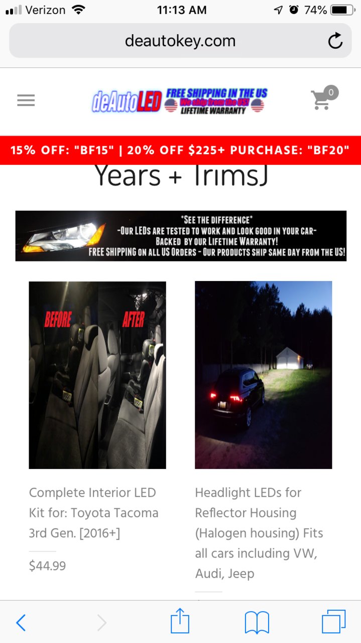

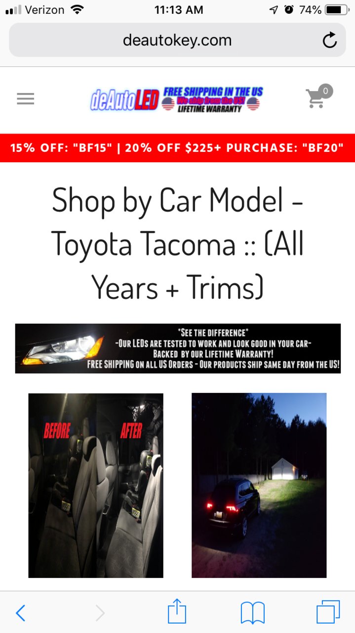

    Then why link to "Offering a wide range of LEDs for your Tacoma:
    All LEDs for your Tacoma"
    If they don’t work in the Tacoma why would your signature have a link to them for use in a Tacoma. Terrible business practice. I will be spending my money elsewhere.

    Yes everything works except the Fogs - those are removed from the listings and we NEVER posted it here in the forum until the final testing is done - everything else does work so don't confuse it please with 1 product as this is what we feel someone wanted we suppose. But we have no problem taking the time to explain our brand and product more and what we want to offer.
    Bright reverse - very popular:
    http://deautokey.com/product/bright-15-chip-reverse-leds-194-921-wedge-error-free-fits-toyota-tacoma
    No resistors - totally plug and play front 7440 turns:
    http://deautokey.com/product/universal-front-turn-signal-leds-fits-all-car-models
    Low beam HID kit tested to be one of the brightest at a BETTER price:
    http://deautokey.com/product/35w-slim-digital-ac-canbus-ballast-h7-h8-h11-h15-9006
    Interior Kit:
    http://deautokey.com/product/complete-interior-led-kit-for-toyota-tacoma-3rd-gen-2016
    Low beam reflector LEDs:
    http://deautokey.com/product/headlight-leds-for-reflector-housing-halogen-housing-fits-many-cars-including-vw-audi-jeep
    Bright license plates:
    http://deautokey.com/product/universal-license-plate-leds-super-bright-error-free-fits-many-vw-and-audi-models
    Bright side markers:
    http://deautokey.com/product/universal-error-free-side-marker-leds-amber-or-white
    Brighter better than hikari high beams -drop down it is the Tacoma specific model:
    http://deautokey.com/product/h15-daytime-running-leds-high-beams-100-plug-play-fits-many-volkswagen-audi-models
